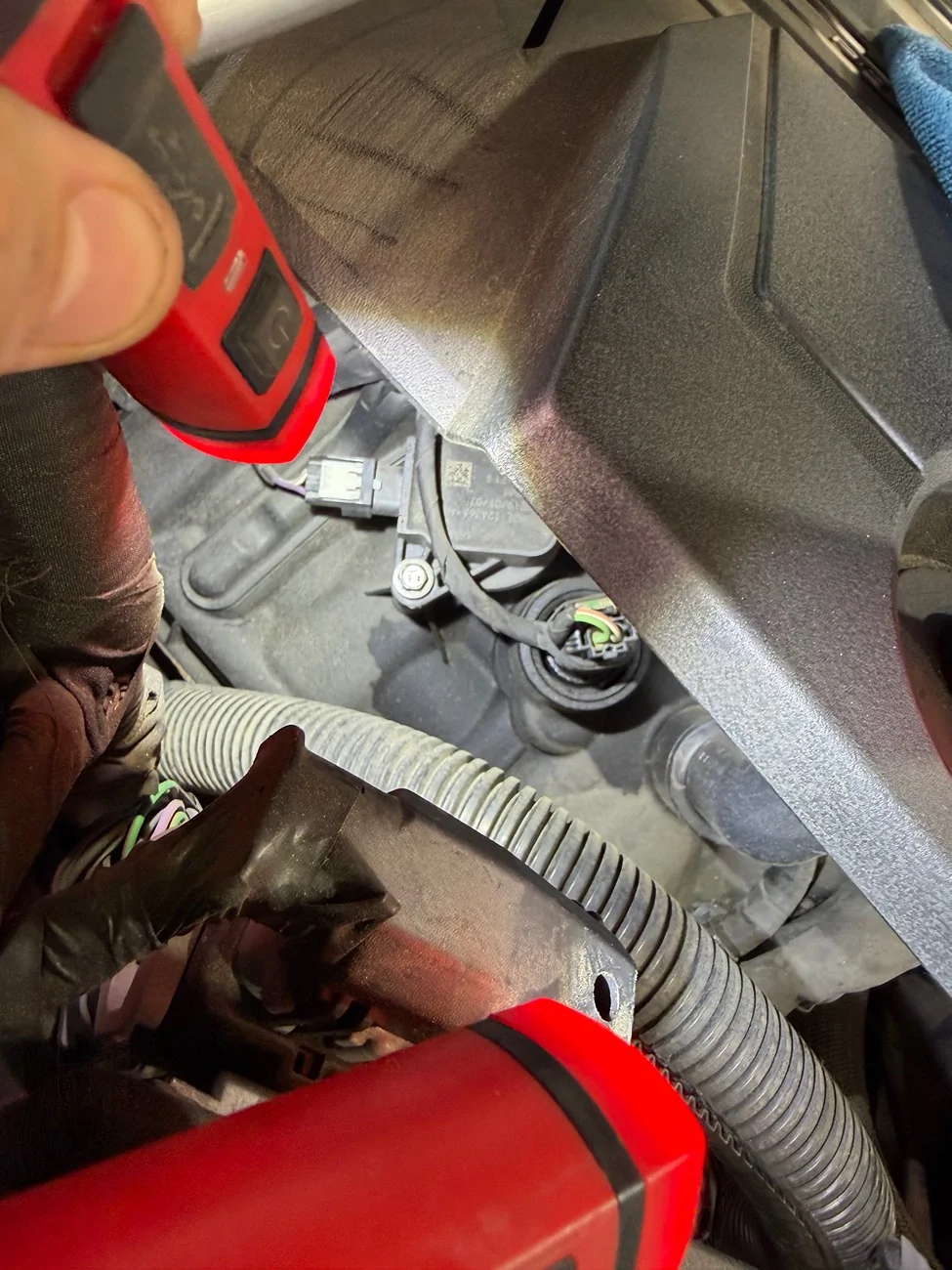

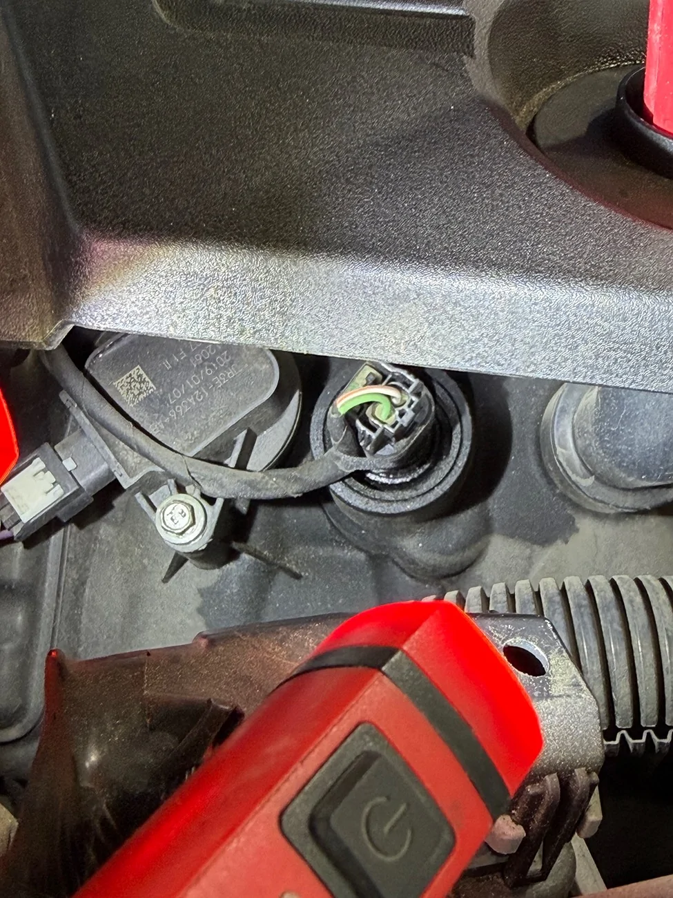

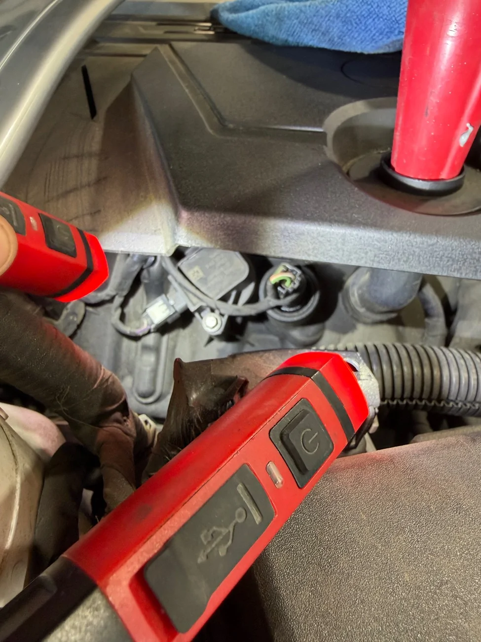

Looks like oil is coming out from there anyone one know what this is or the cause. It’s a 2019 mustang t

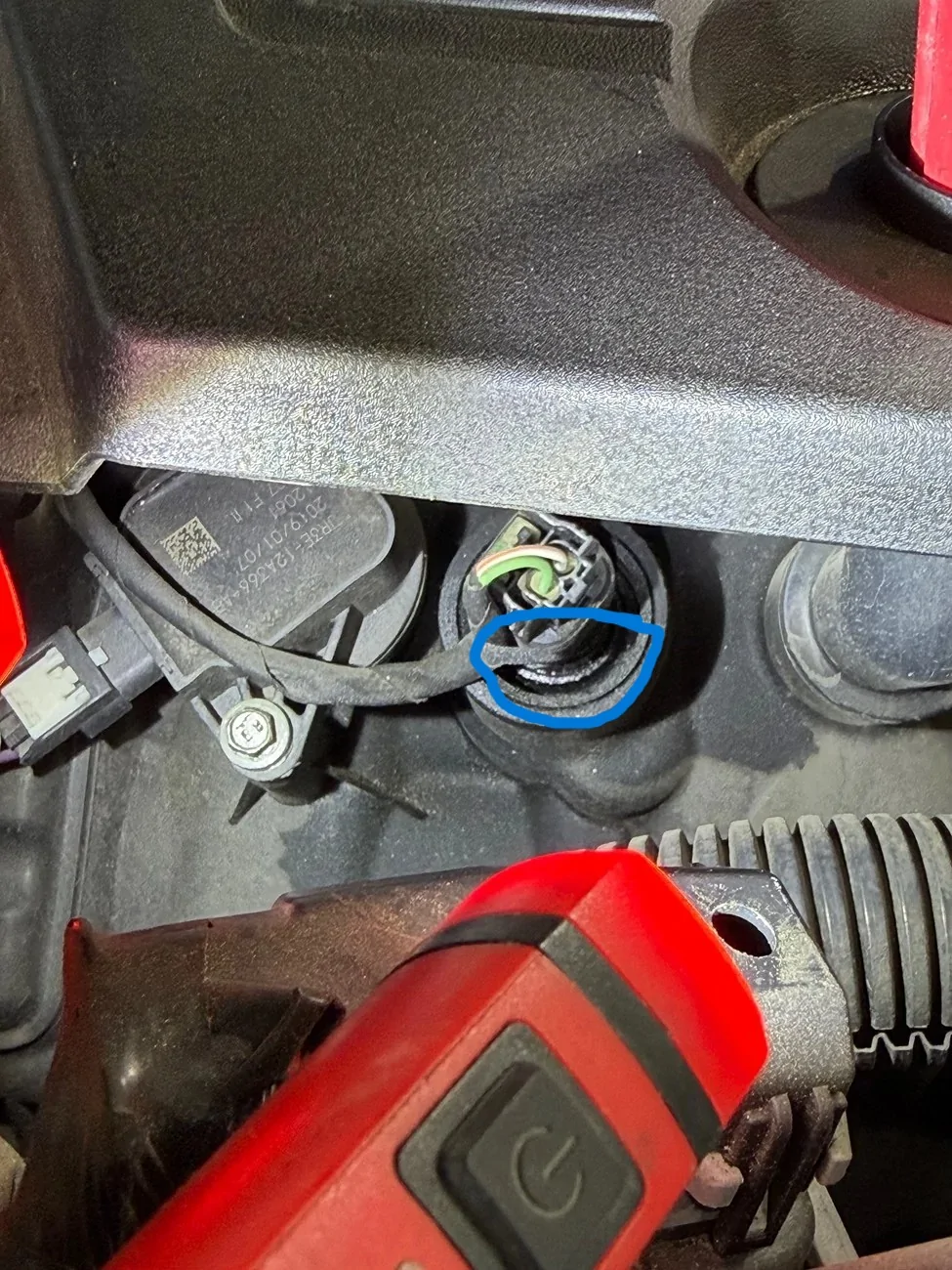

I still think it's the VTC oil control solenoid seal in the valve cover. If it were from the filler tube how would it get up in the circled area? Not trying to argue just my opinion.
100% coming from the VCT solenoid seal. It happens and bound to occur over time. If its not much you can either choose to ignore it or replace the entire valve cover. I dont think they make individual seals for that.
Mine leaked on my 2016 mustang for like 2 years and I opted to replace the valve covers with aluminum covers 2 weeks ago.

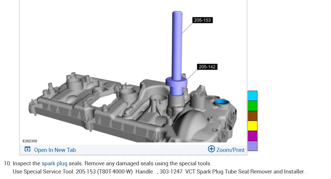

Looks like they do make seals the circled number calls for a quantity of 4 total so they are the same for all the solenoids. Personally I would do the same as you and swap to aluminum covers if I were going through the trouble to remove them.
Yeah you're right it's the seal.
