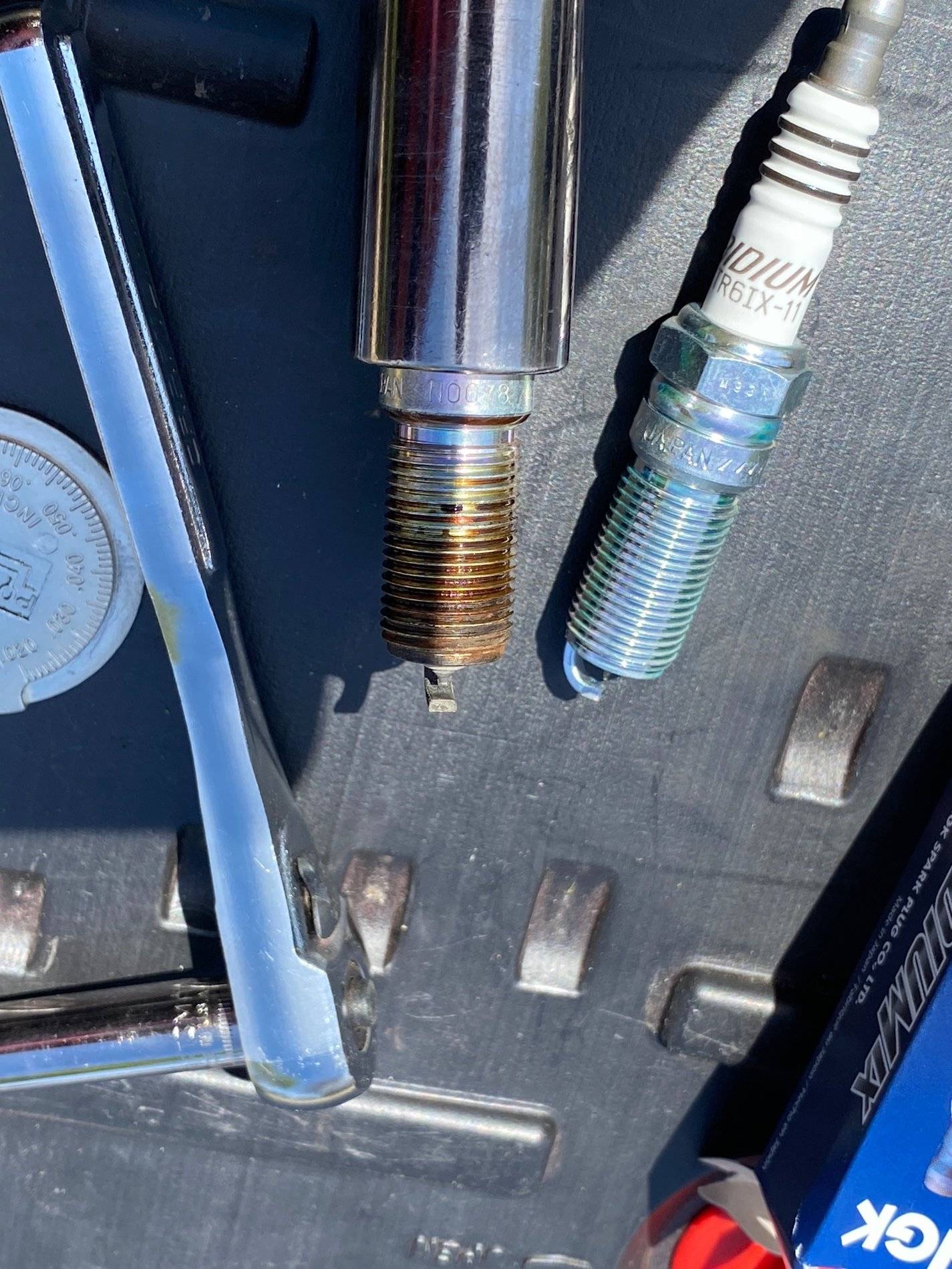

I have a 2017 GT Performance pack I bought used, 22k miles. Trying to track down an idle surging problem and started with the basics, new plugs, cleaned MAF. The idle isn't bad, just seems to sit for 10 seconds, bounce the rpm up, drop below idle and then repeat.

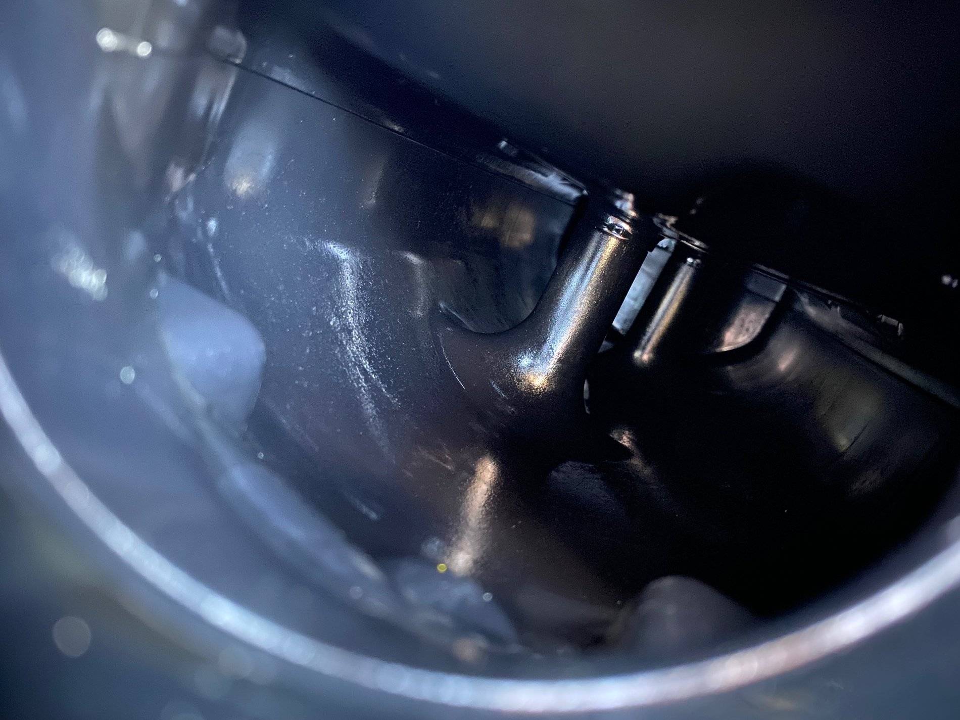

Noticed all 8 spark plug threads are soaked. Took the throttle body off to clean it and the intake manifold is wet too, not drenched, just a covered film basically on the inside.
Mods are as follows. PMAS cold air intake, Pipes long tube headers with high flow cats, billy boat cat back with x pipe, e85 tuned.

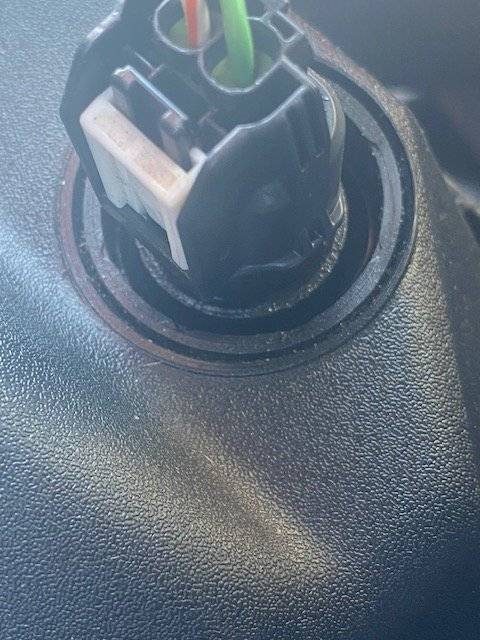

What am I looking at here? Intake manifold gasket? valve cover gasket? Don't really see any oil externally except around the connection in the picture. Manifold picture is upside down.

Most likely don’t have a leak. The oil inside the intake is blow by oil. If you don’t have a oil catch can you can look into one and that’s what those help for. Plugs look normal to me but wait for others to chime in.

Ahhh a catch can, I was planning on getting one just haven’t yet. Good call. I will wait for other input as well. Thanks!

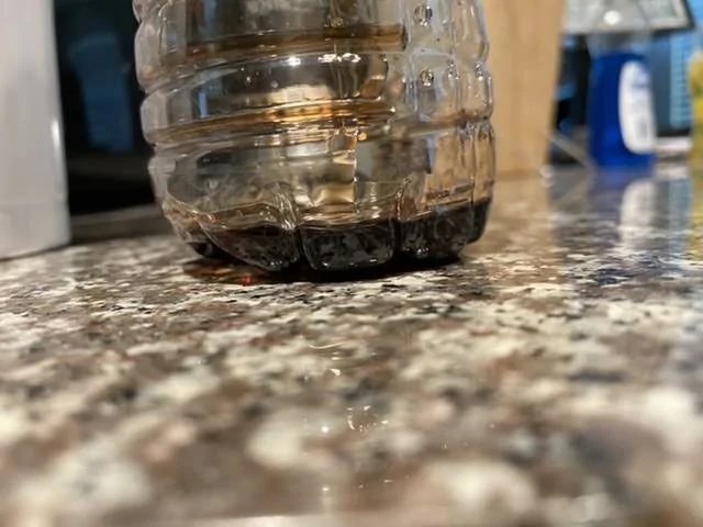

I agree on the catch can addition. That looks like blow by like @15GTPP mentioned.
This was my oil catch can dump at my last oil change. That’s about what I get out of it each time I empty it.
