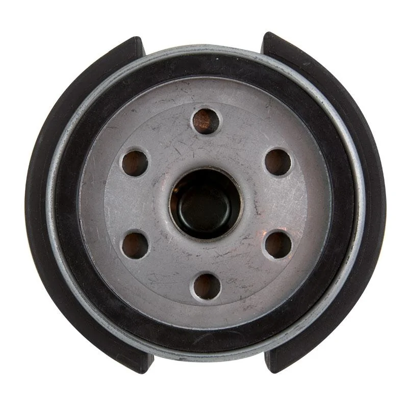

The auto manufacturers put a magnet in pan or end of drain plug and not in or around filter..Magnets affect springs and valve pressures in oil filters.

Have you tried the product yourself? Seems like a good product, but it looks like it would impede flow a bit.
No I haven't and I wondered about that myself. I sent the manufacturer an inquiry for the heck of it, though you can imagine what they'll say. Since I have lifetime oil changes I'm not going to worry about it as I would be hesitant to ask the dealer to drop anything into my filter regardless of the potential benefit.

I should state that I have not been a practicing spaceflight mechanical engineer for 8 years. I sold my soul to corporate America and am now best described as a shill (AKA consultant :p).
As the GT350 uses a composite pan and drain plug, there's no way to put a magnet on those parts. I'm not a fan of magnets on pans anyway as you have to remove the pan to clean the collected material.
I can't say anything emphatically, as mechanical systems are enigmatic. Software is easy; you can test and simulate an nauseum in simulated settings and get accurate results. Mechanical systems require time. Lots of it.
Modern engines have less and less ferrous material in them which make FilterMag like devices less effective than they would be in mostly steel engines. Aluminum is non-magnetic, after all. The debris that FilterMags collect is typically smaller than filter media can capture. It's possible that such small debris is mostly harmless as it's much smaller than most engine tolerances. That said, removing any ferrous debris from an engine using a FilterMag is notionally a good idea with no downside that I can surmise.

If these magnets we so good at collecting metal inside the filter, why don't the car manufacturers use them in every car they build ?
I'll stick with the FL2069 ST Motorcraft filter.
You'd think GM would've put them as OE on the C7Z, the CTSV and Camaros equipped with the same powerplant... but then agin, you can't stop RTV/silicon from blocking passages with a magnet either.

The magnets probably work, but I question the need. I have a '97 F150 with 200K miles and an '02 Excursion with 150K miles and neither uses oil ... and have never had a magnet. I'm definitely in favor of an early first oil change to get rid any manufacturing residue. IMHO good clean oil is the key to longevity. I'm a big fan of Mobil One, or Valvoline if not going synthetic. Part of the break in problems some folks are having may be due to the fact that the engine comes with synthetic oil. We've always used normal oil to break in our built engines, then switched to synthetic.

I think if anyone is really concerned about contamination and wear, on each oil change a sample should be drawn and sent to a lab that specials in analyzing for excessive wear and contamination. This usually indicates, whats in the oil, how much, and what the origin of a particular contaminant is (i.e. engine bearing, block, cam gears, camshaft, etc.)

Agreed. I've used Blackstone Laboratories in the past.

I'm not a nasa engineer, but I am a mechanic. I have been using these same filter magnets for years. They never wear out, last forever, and do a great job. I agree with spacebird 110%.
Before I found the filter magnets years ago I used a speaker magnet on the end of the oil filter.
I'm also a firm believer of Amsoil oils and lubricants.
