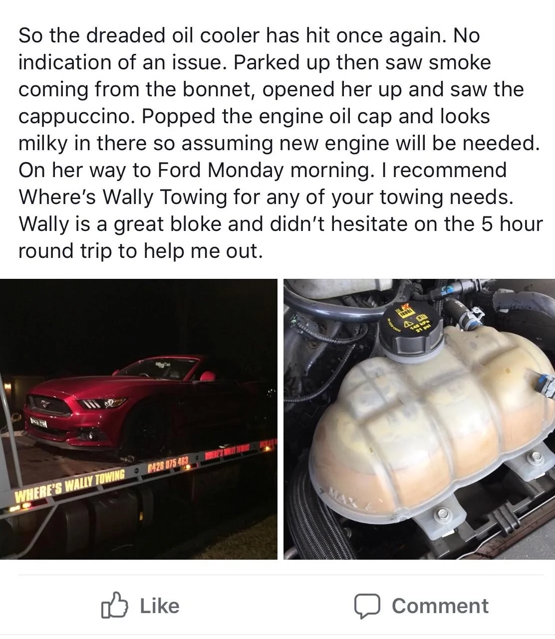

So another one has reportedly failed in the past couple of days causing catastrophic engine failure.
Ford seem to be honouring warranties at the moment, but don't appear to be doing anything proactive in order to resolve the issue before it occurs.
I'm particularly concerned about how these failures will be dealt with once our factory warranties expire. (Yes, I'm aware of Australian Consumer Laws, however would rather not have to fight tooth and nail to achieve a resolution).
We should also not have to explore third party options (and associated expense) to address this issue.
I agree Drewbo, however when I contacted Ford customer service 2 weeks ago the answer I was given " we cannot comment on what will happen after the warranty expires" so very non committal from ford.
In my situation I do a lot of long distance travel and rather not be stranded in the middle of nowhere waiting to be rescued,which can take up to 1-2 days. then have the hassle of arranging transport to finish the trip.
I have taken to option to purchase the Street fighter kit, I picked it up last week when I was in Adelaide.
