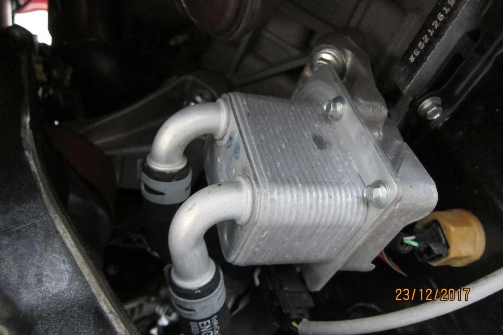

On the way out of Hamilton today I was following a 2018 Mustang GT and I thought I must take down the rego, because in NZ you have to pass over your rego to get parts at the Ford dealership.
Now I have my rego and the 2018 Mustang GT one, after business was done in Hamilton I was straight round to the Ford dealership to get an oil cooler for each of these cars
And wow what do you know they are different part numbers, looks like they have updated.
2016 Mustang GT FOGR3Z6A642C
2018 Mustang GT FOGR3Z6A642D
And for my Mustang GT (2016) the old part number has been superseded to the new part number.
Just thought I would let you all know.
I have ordered one for peace of mind.

12g just wondering do you know if we can check the part number on the unit/oil cooler itself?
I suspect it will have a part number somewhere but no sign of it from the shot that I took on my last oil change I did on my car. (Probably on top where we are unable to see)
I thought I would have the 2 oil coolers weighed when I have the new one fitted by the Ford dealer. This will take place in December this year in line with my next service.
I will post results after that.

I will be posting photos of the old oil cooler cut in half.
