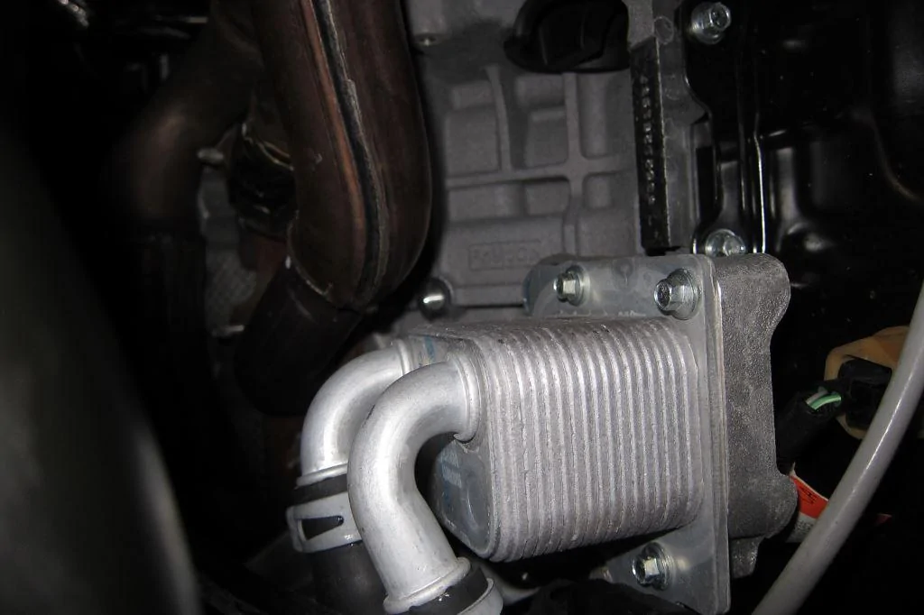

My mechanic who fitted the new oil cooler with the new engine remarked that whilst the dimensions of the unit were near identical, he said there are signs that the unit is different... Had slightly differences in design. Suggested it was clear that it was not an identical replacement unit.

Question is: How do we know if we go to the dealership and ask for it to be replaced (even if out of pocket to be safe) that we get the 'new' one?

Here are the photos, hope they are some help?
[MENTION=25292]TeamDenno[/MENTION]........if you get an opportunity, please post a pic of the new unit so we can compare it to 12g's pic.
