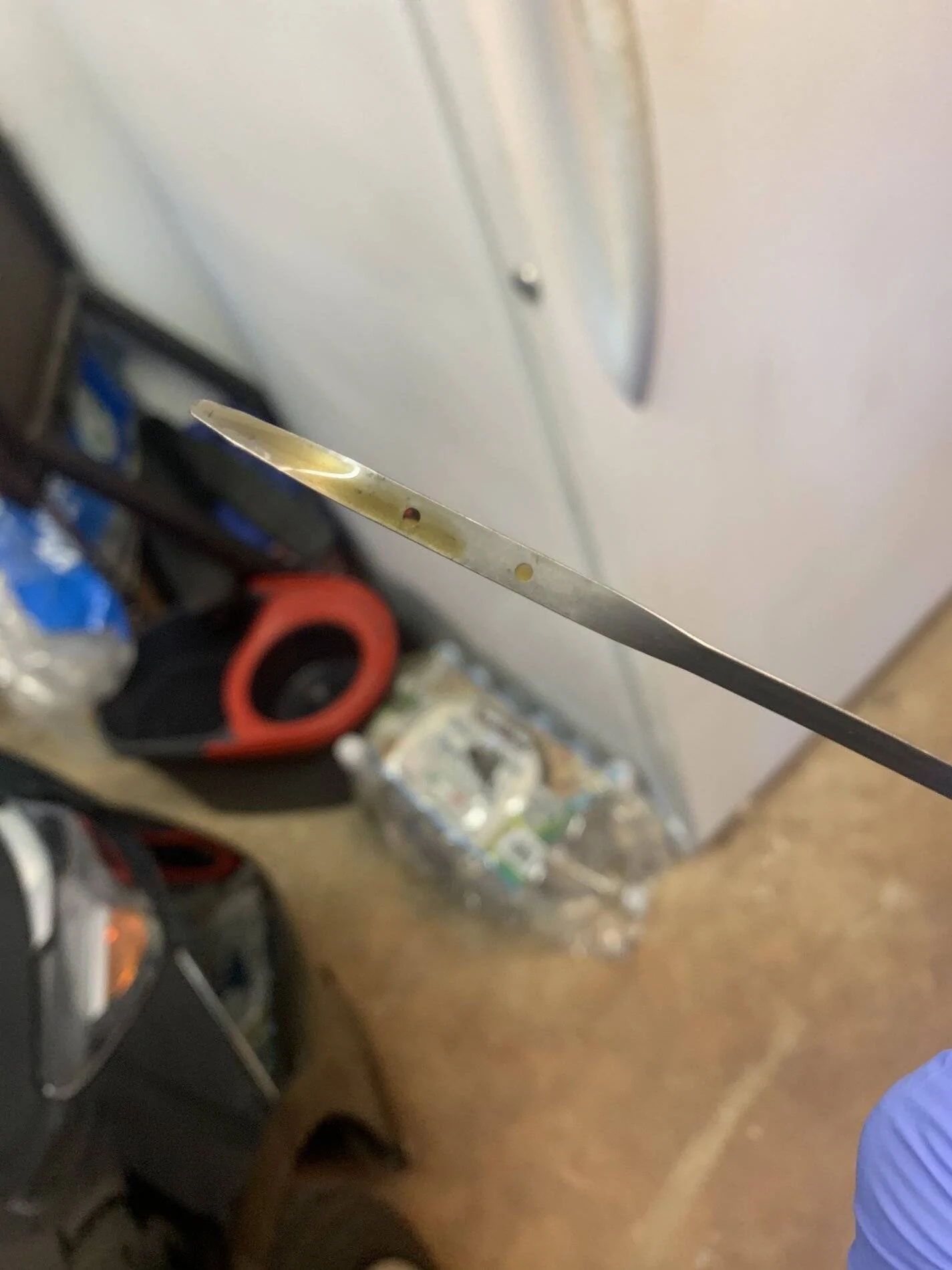

I pulled the dip stick this morning. About 1,600 miles and 2 months since the last oil change. Do you guys think this is a decent reading? Based on my own research I’m hopeful it’s pretty good.

Hard to say, but looks about 1/2 way between the two holes? Also depends on where the oil level was right after the oil change (the baseline level), and if checked with the car in the same exact spot the exact same way.

This level is meaningless without knowing how you drive your car,,,
1600 track car miles.. fantastic
1600 grandma miles.... not so good

Its had 2 or 3 canyon runs which is about 200 or so miles of pretty spirited driving on it.. and I normally get on it pretty hard and do about two or three hard 0-60 runs every time I drive it.
Then it's fine.
