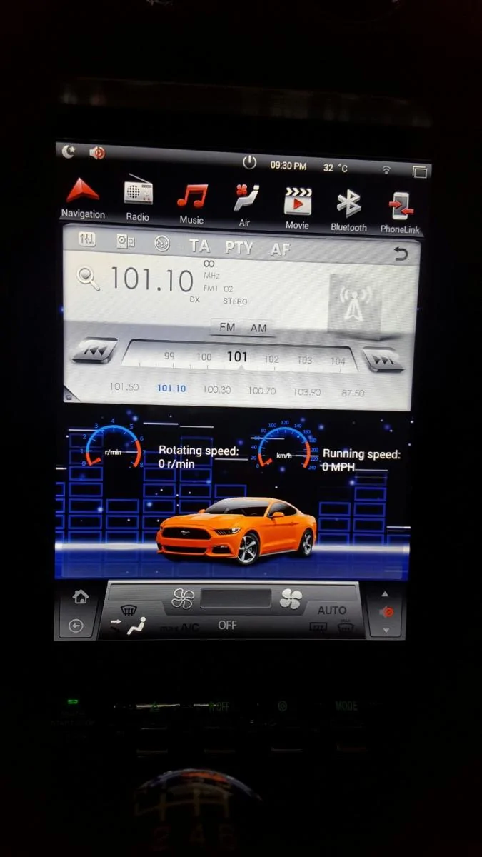

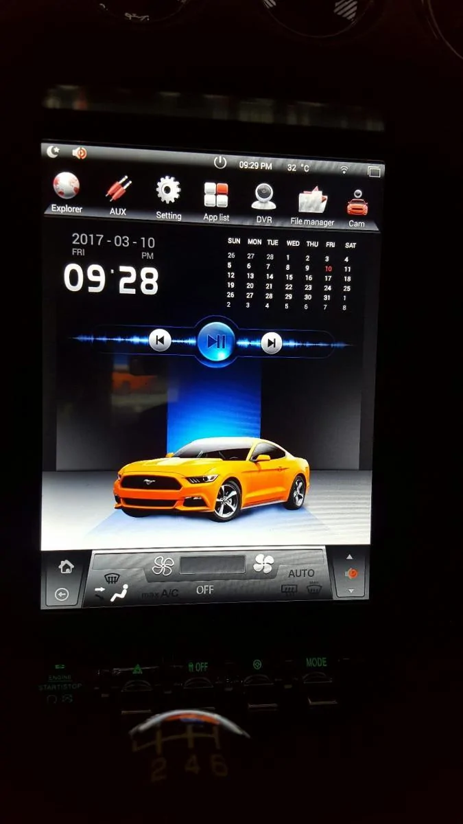

First off, screw you and your 32C outdoor temperature lol. I'm freezing my ass off over here.
Second, what launcher is that in the pics?? I like that dark and blue look.
Frenchy480
Jan 22, 2017
121
Phx/gilbert
2016 mustang gt pp shadow black
Lol yeah, it was almost 90 today. Had to turn the ac on.
I think I went to the system settings in Nova launcher and clicked on u/I style and also update mcu I think. I'll take a pic later after I get home. I've had a few different backgrounds and even different vehicles.

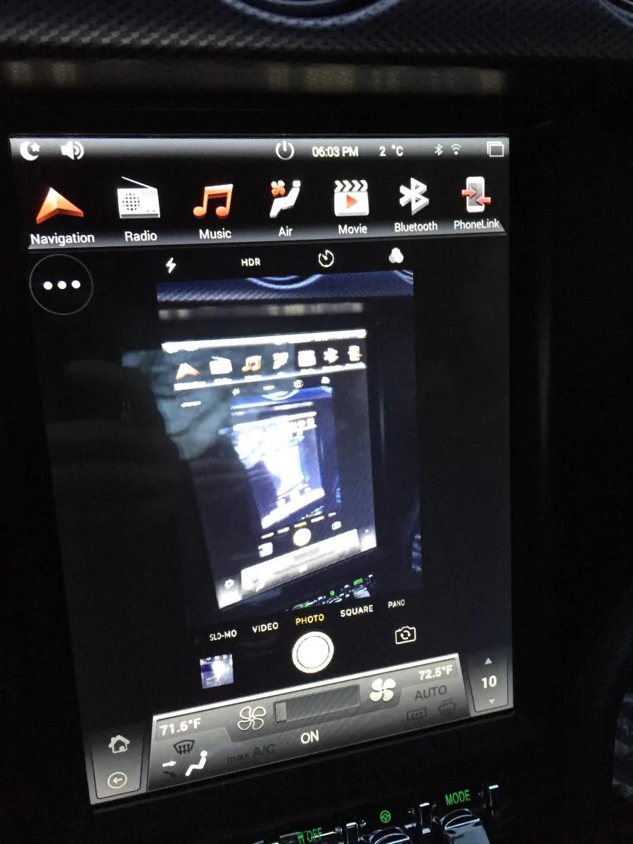

I got the mirroring to work with an Iphone using Phone link native app.
Just update the app. Didn't have to do anything on the phone. It connects to the unit wirelessly
