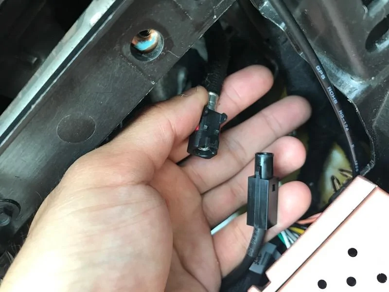

New issue could be loose connector but...
when the unit boots I only get sound out of front passenger speaker then if I shut it off and turn it back on I get front pass and driver rear speaker
Thats a loose connector. I had that exact issue. Its the single fat wire from the cd player. Once i got that connected firmly it doesnt happene anymore.
This one to be exact

The the radio antenna wire but will check later thanks man
