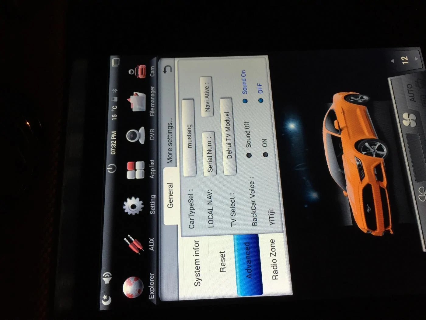

I don't remember where I saw it but... If you go to advanced setting there's an option for nav. Local nav or something like that... You need to change that option. This Friday I should get my new host and I'll make some tutorials.
You mean this screen. Clicking the Navi button does nothing for me.
It even shows OK on the Navigation settings next to Waze but still launches Chinese app.
No it was something else. I'll check in the code tonight. I'll let you know.

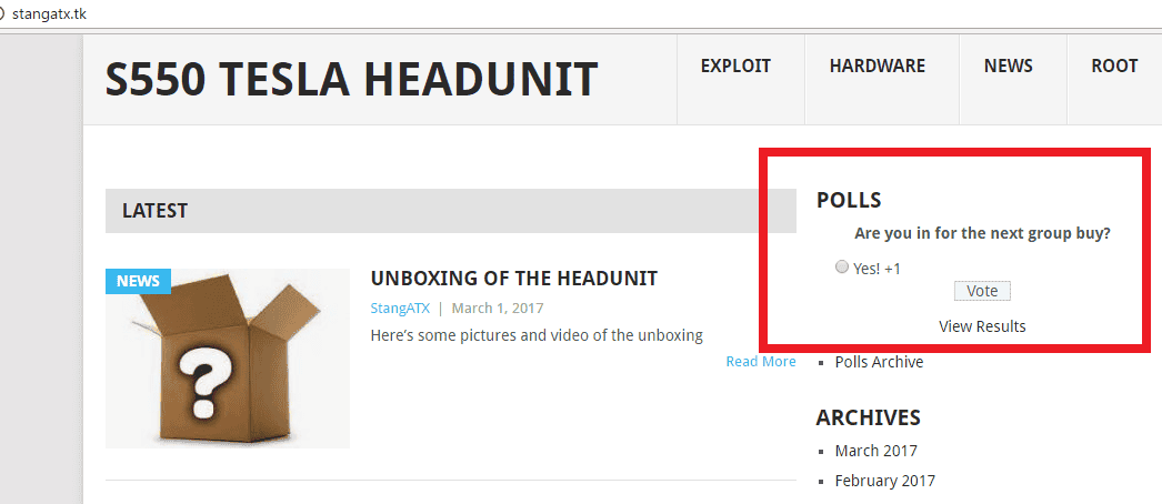

I can't locate the poll. Can you provide a link?
Top right. check out the screenshot. If you still don't see it. You might need to empty your cache and refresh the page.
