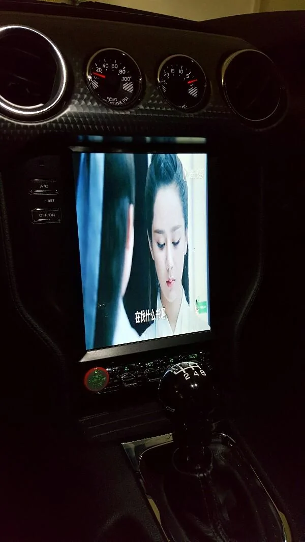

I haven't had much time to play around with the system yet but has anyone figured out how to change the pic on the startup screen? This randomly started showing up on my screen instead of the mustang.

Nevermind, figured it out after playing around with it. I had to do it through that change background screen that's in chinesse.
Is your shift knob illuminated or is it just from the flash of the camera?
