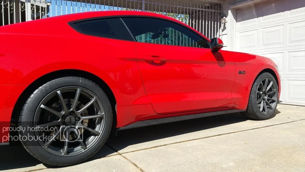

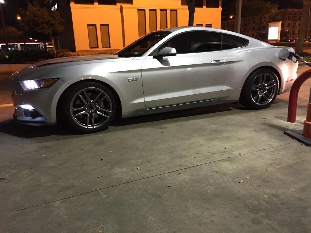

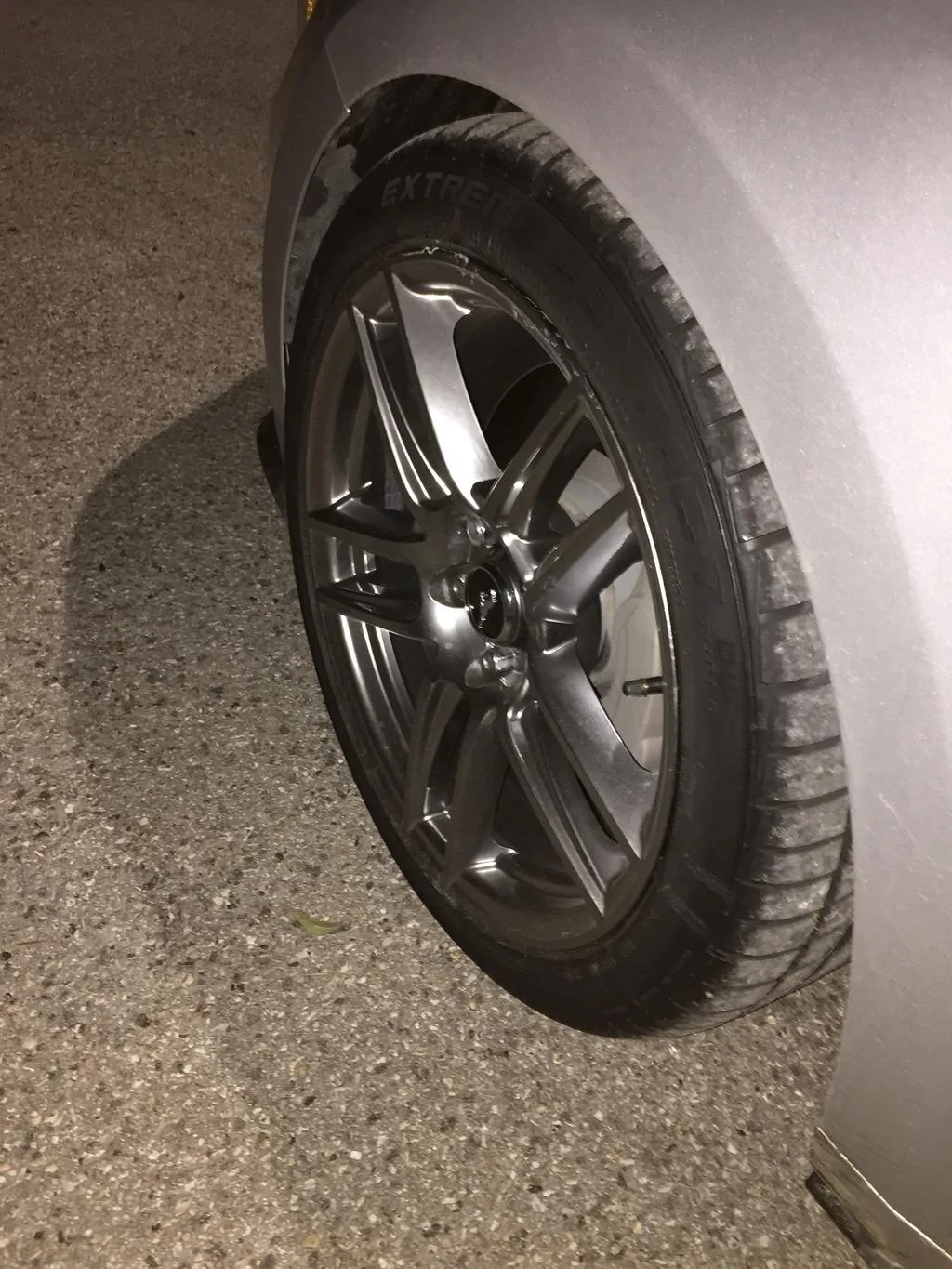

I will be getting 275/40/19 PSS on my 19x10 MMD +45. I have 5mm spacers for insurance to bring it to +40 like the rest of the people here. I will update when I get them installed

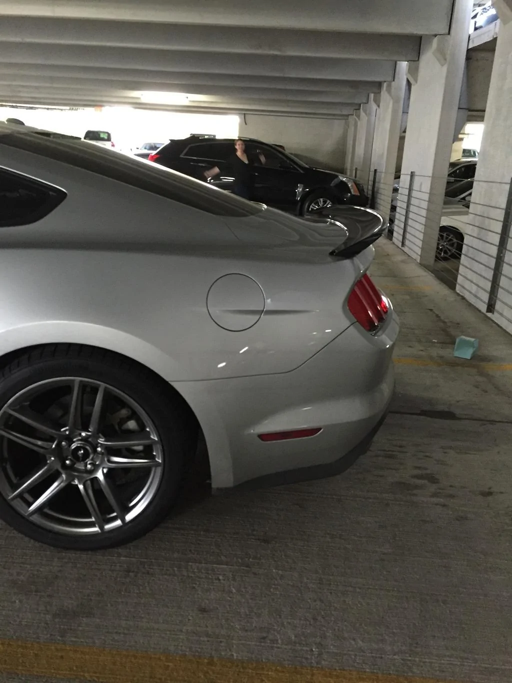

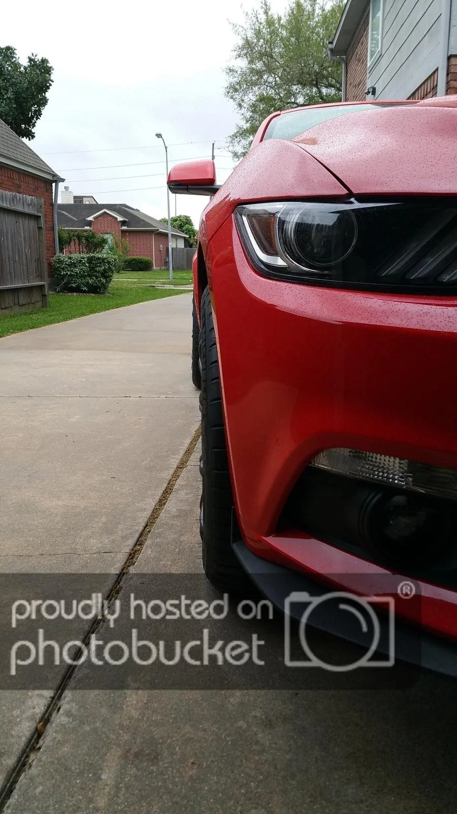

Boss 302S 19x10 wheels with 285/35r19 Continental Extreme Contact DW tires.
+47.5 offset with 5mm hubcentric spacers all around. It's very close, like 1-2mm of clearance from the strut. I will be fitting a set of 7mm spacer up front to check my comfort level on the lug nuts.
After installing running pony center caps I modified.
A pic with the new track pack spoiler installed just for fun.

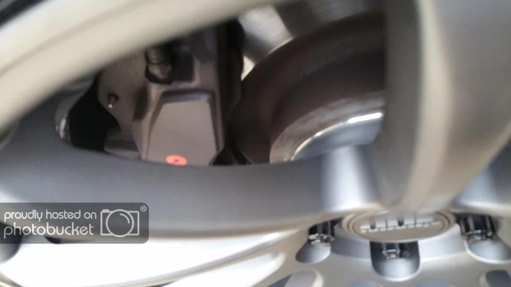

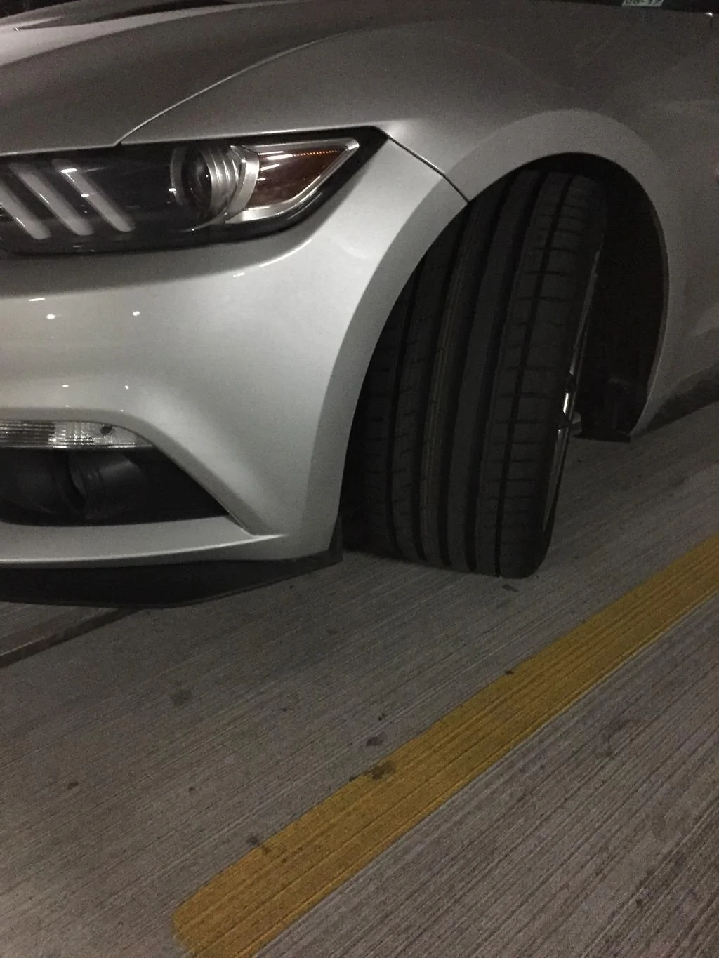

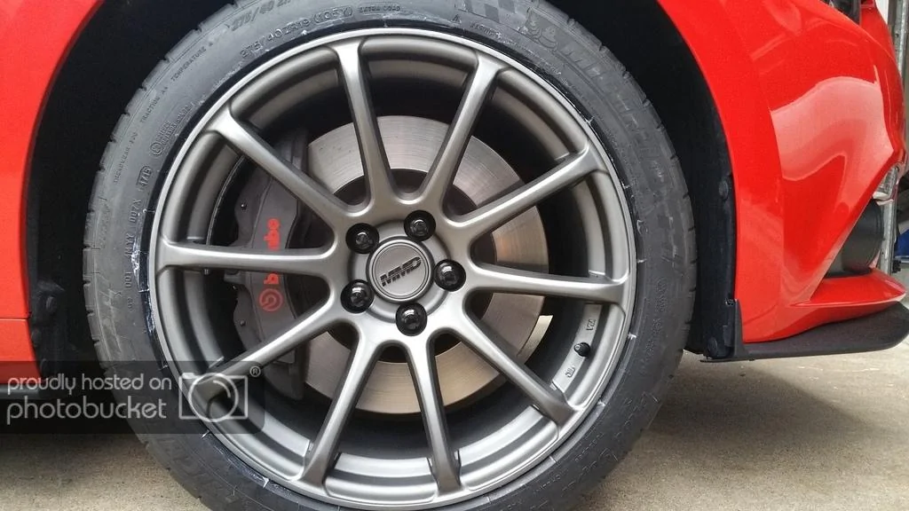

19x10 MMD Axiom +45 with 275/40/19 Michelin Pilot Super Sports, used 5mm hubcentric spacer in the front. Wouldve been very tight without it, cheap insurance. Im on stock PP suspension. I can already feel the car is more neutral and less understeery.
spacious with the caliper
front shocks recompressed after driving, stance looks nice
