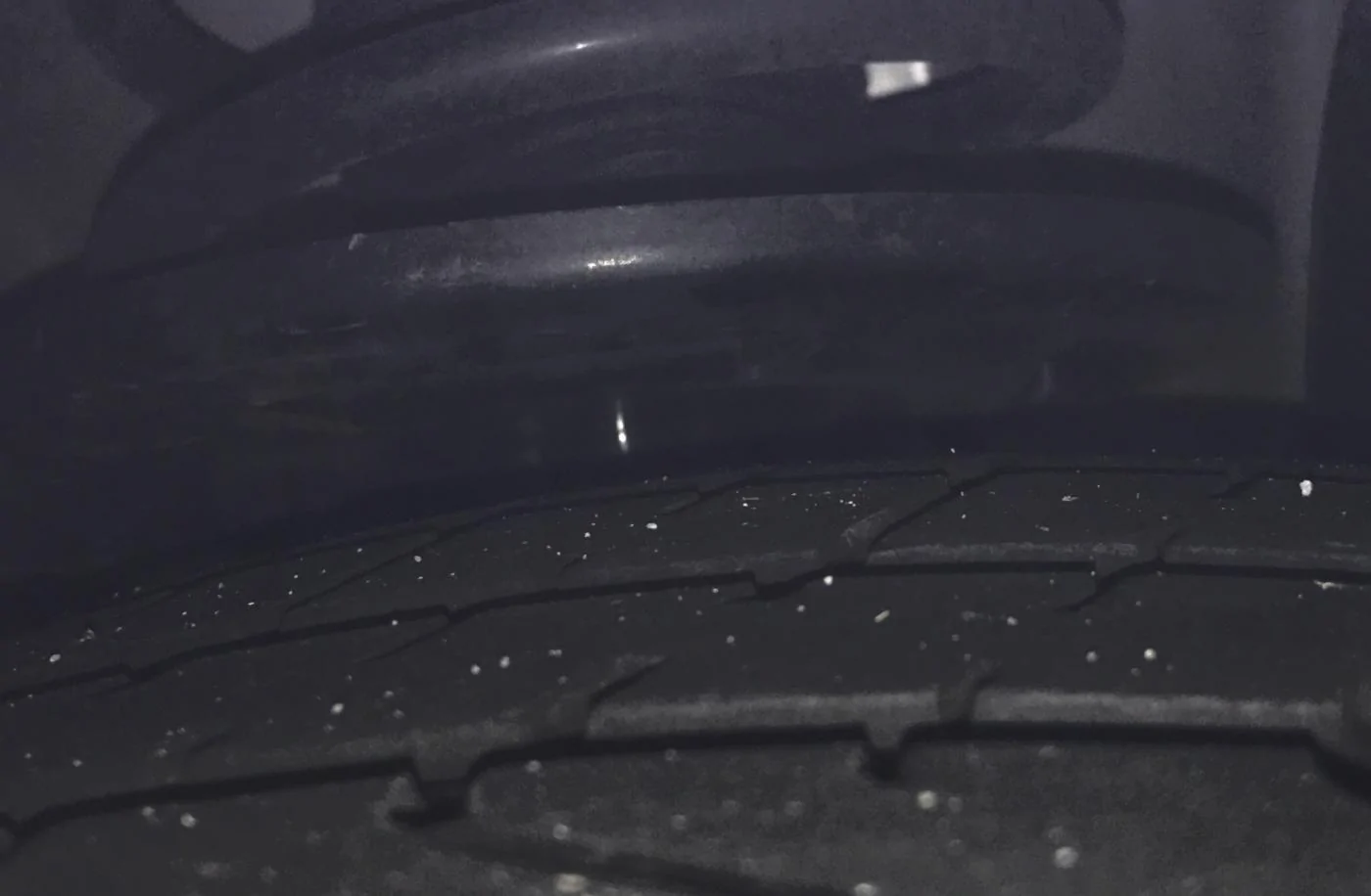

Question: I'm running 19x9.5 with 275/40/19's square PP wheels. I'm on 25mm adapters and it looks pretty tight up front under the strut like it might rub if I drop it any. Anyone out there running the same setup and what sort of springs. I'm thinking BMR minimal drop front springs and BMR .5" drop for the back but even the minimal drop front springs seem tight. Advice?

It's the location of the lower spring seat (which is fixed to the strut) that determines vertical clearance to the tire shoulder/tread. They don't move just because you put shorter springs on the car.
How tight is the clearance? Got a picture?

Can't upload from phone but about a small Mexican thumb is all that fits between tire and lower spring seat.
Actually see picture.

It'll look the same after you lower. Tire to car body structure/fender openings/etc., and the amount of shock bump travel (less because lowering moves the strut into 'bump' relative to its stock position) is what will change.

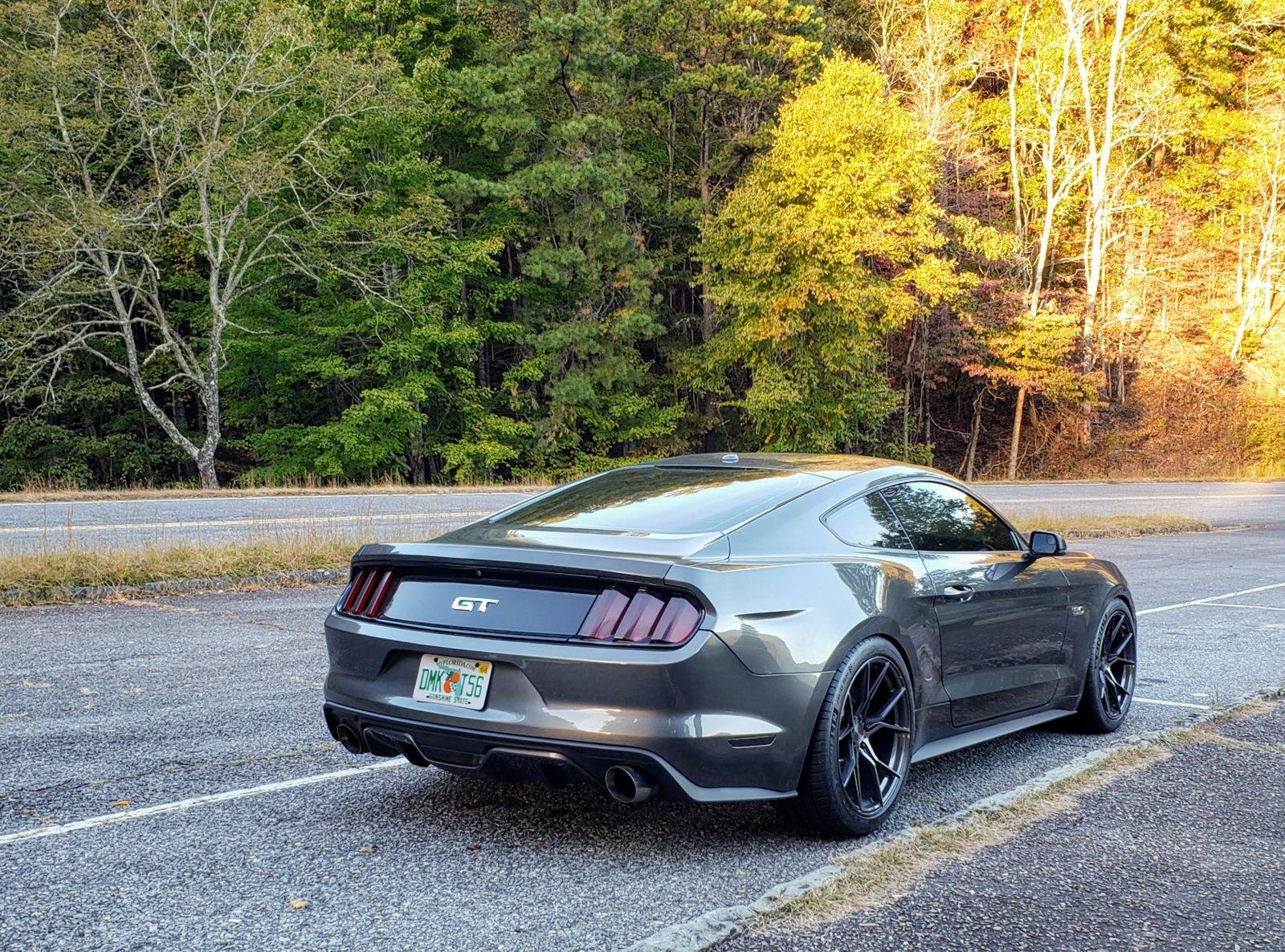

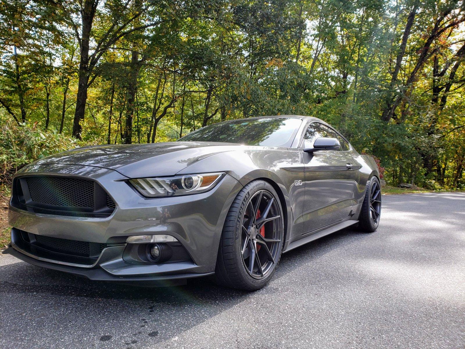

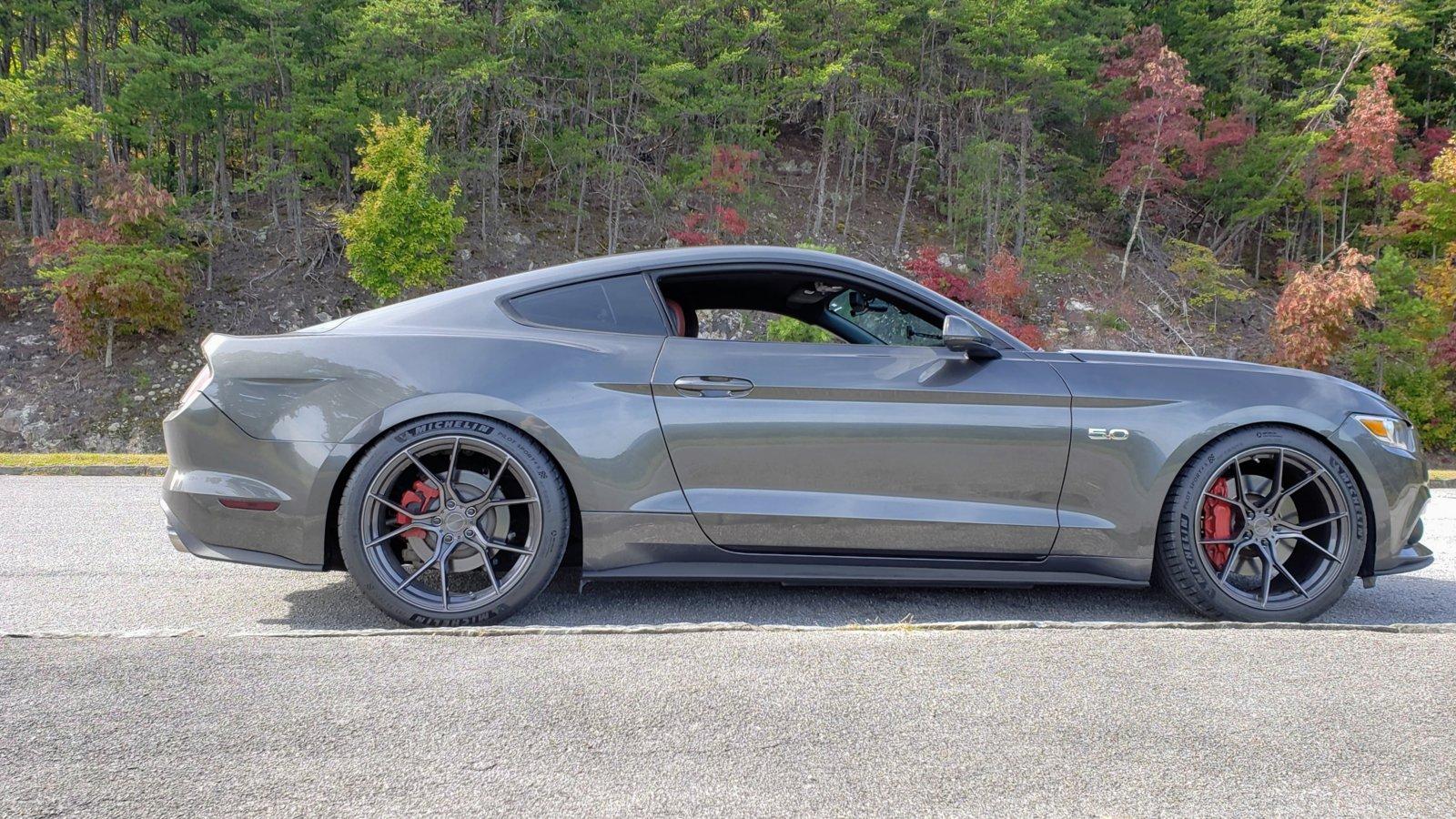

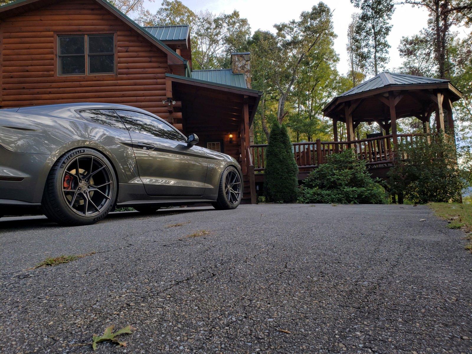

Stance SF07 20x10 +35
Michelin Pilot Sport 4S 285/35/20
Lowered on Eibach Pro Springs (springs should be well settled, installed 3 years ago)
Car feels planted when driving, recently took it through the Tail of the Dragon and it handled great. Tires also felt solid going through Newfound Gap in the Smoky Mountains in the rain.
No Fitment issues that i know of however probably couldn't go any lower without rubbing given the current offset.

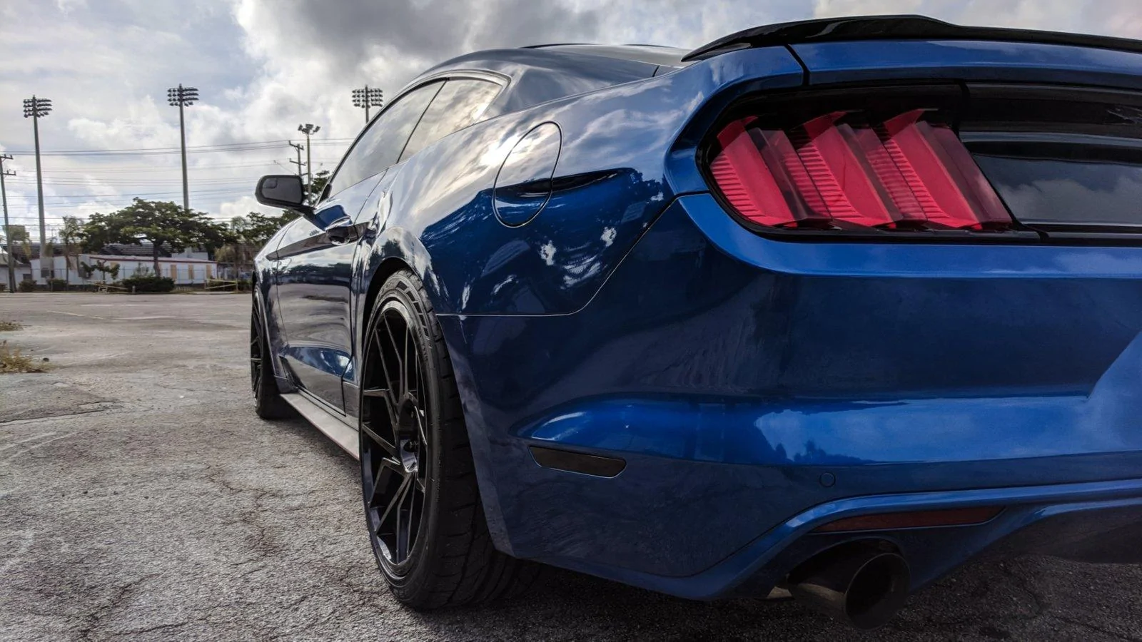

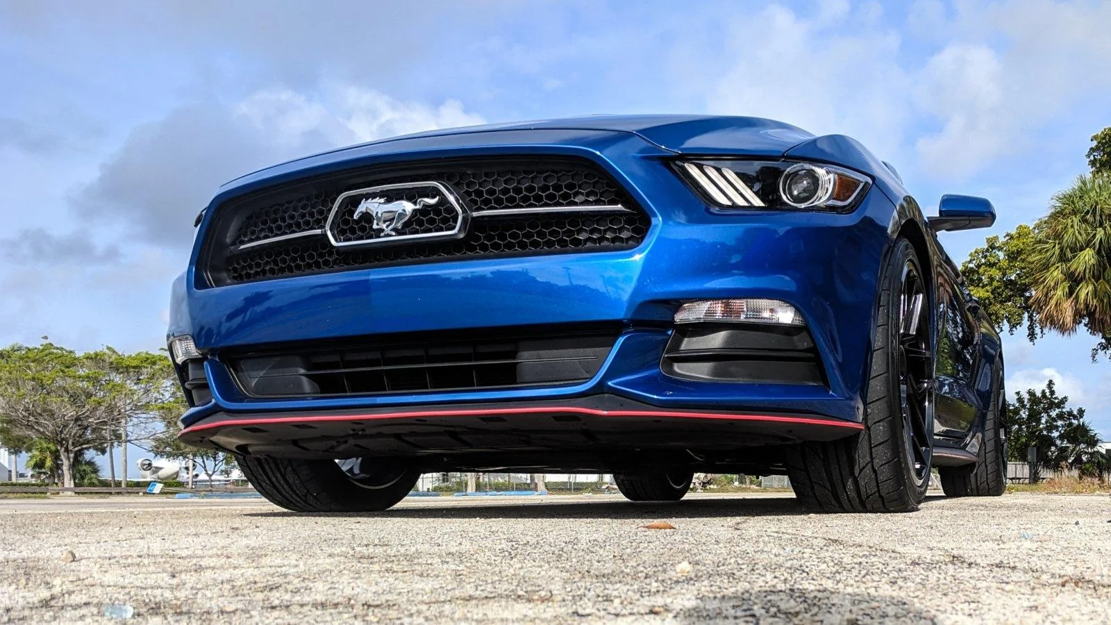

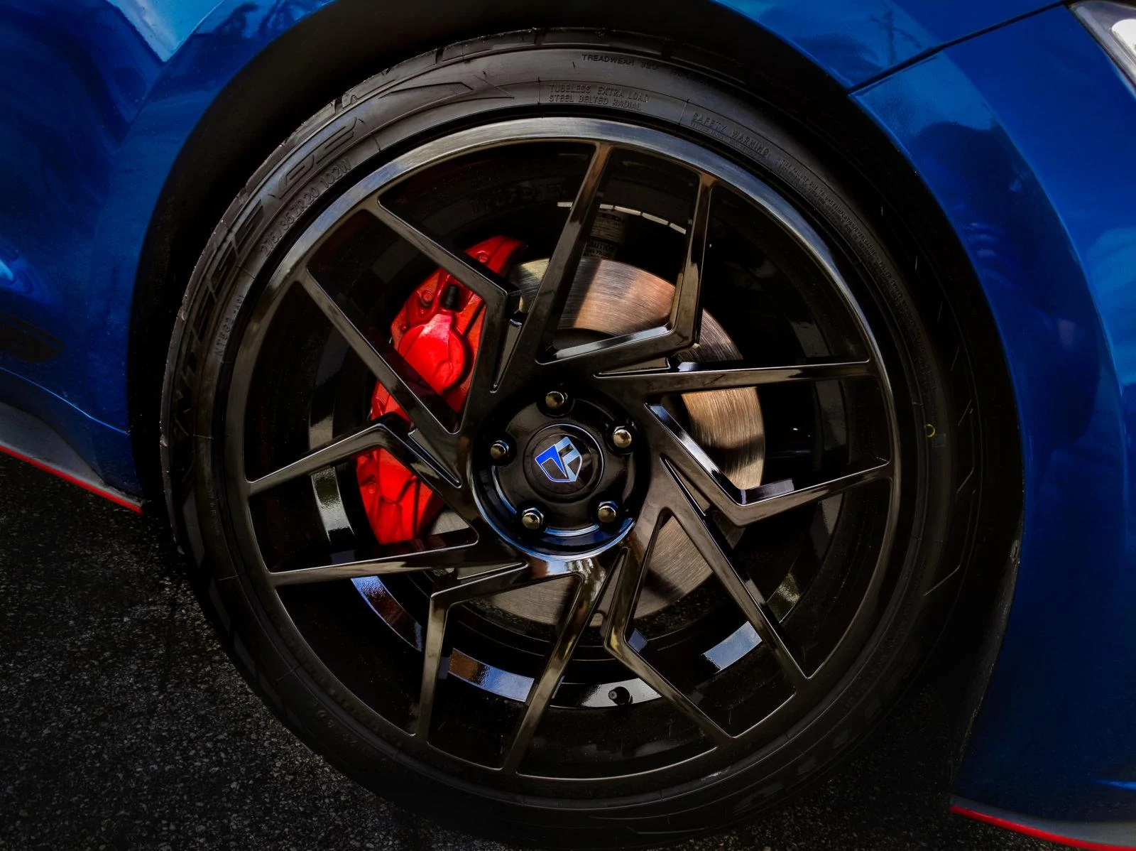

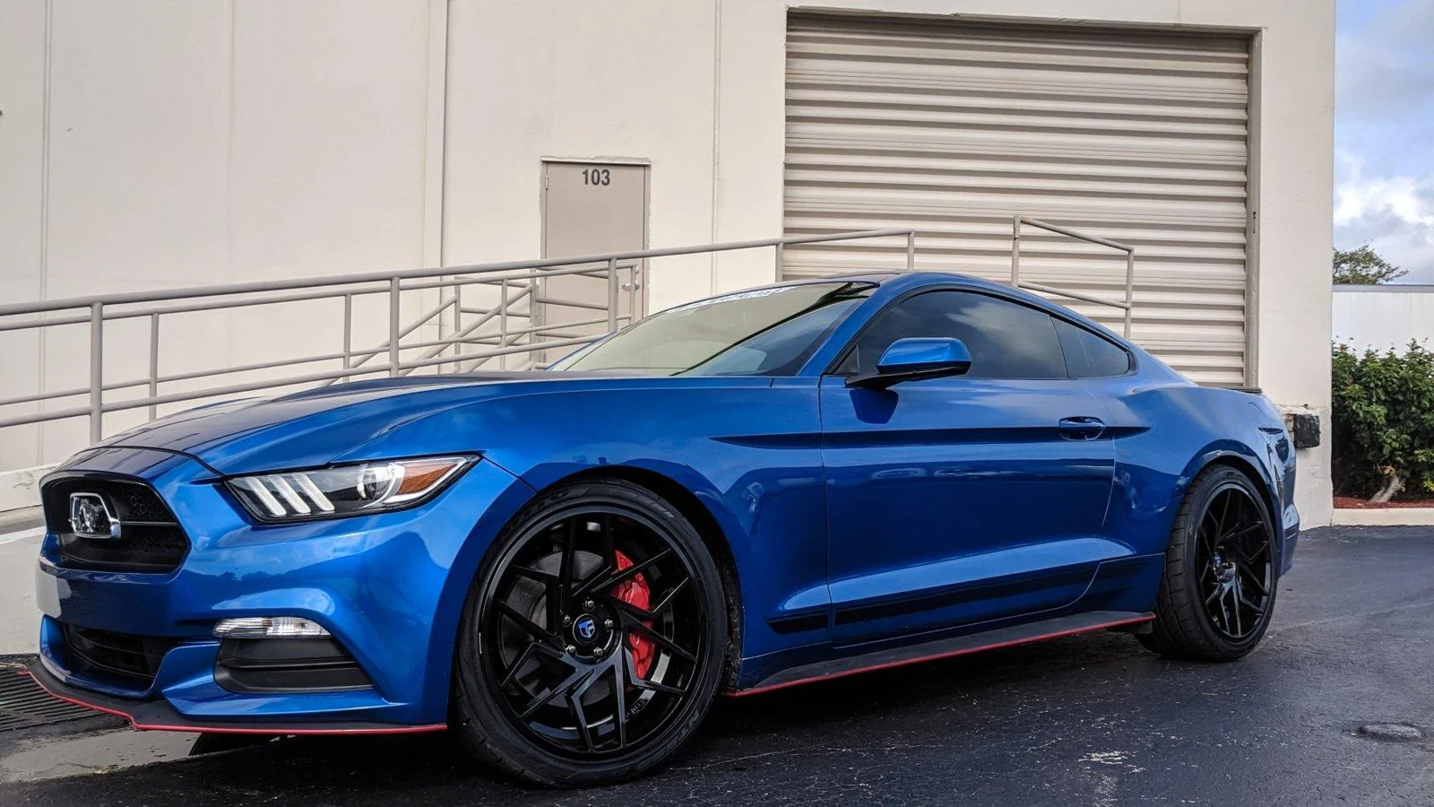

2017 Lightning Blue V6

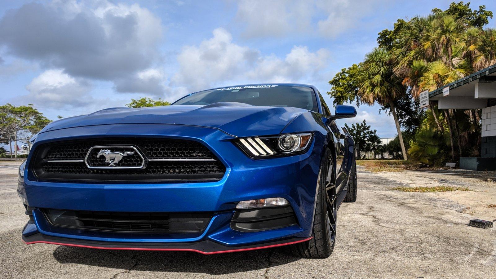

20x10 +42 with 275/35 NT555 G2s all around
These wheels are TruForm TF104, look even better on the car than I had imagined.
