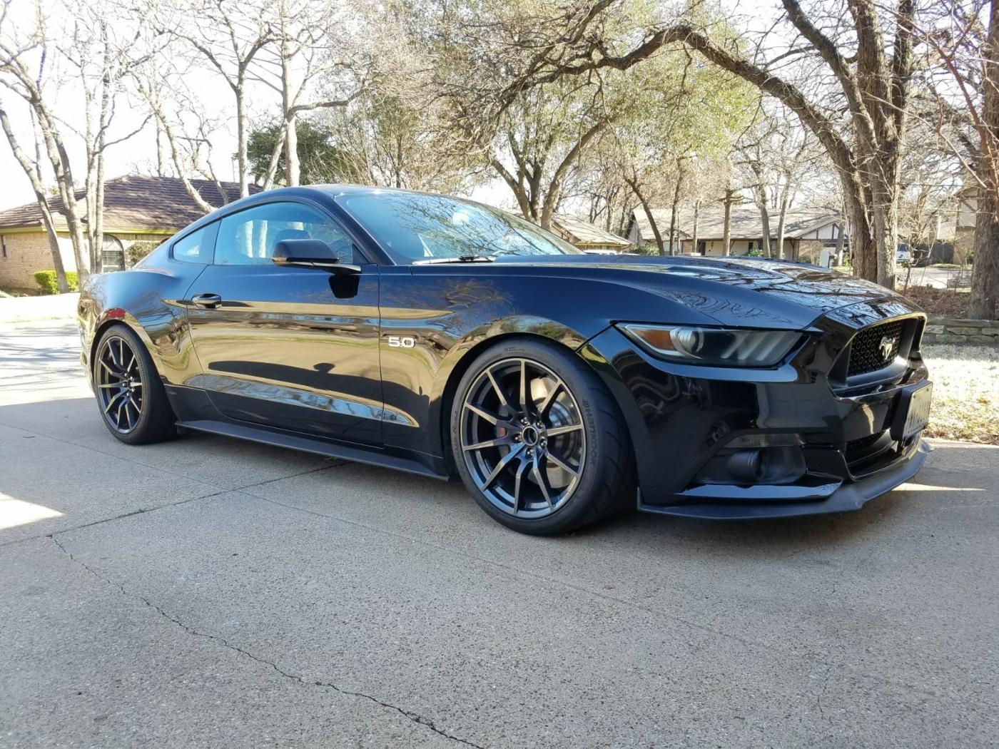

Track setup:
18x10 +42 Forgestar CF5
275/40/18 Bridgestone Potenza RE-11
No spacer required to fit but am installing a 5mm to aid in using camber bolt to increase available negative camber from max of -1.3 to hopefully -2.0 for track handling.

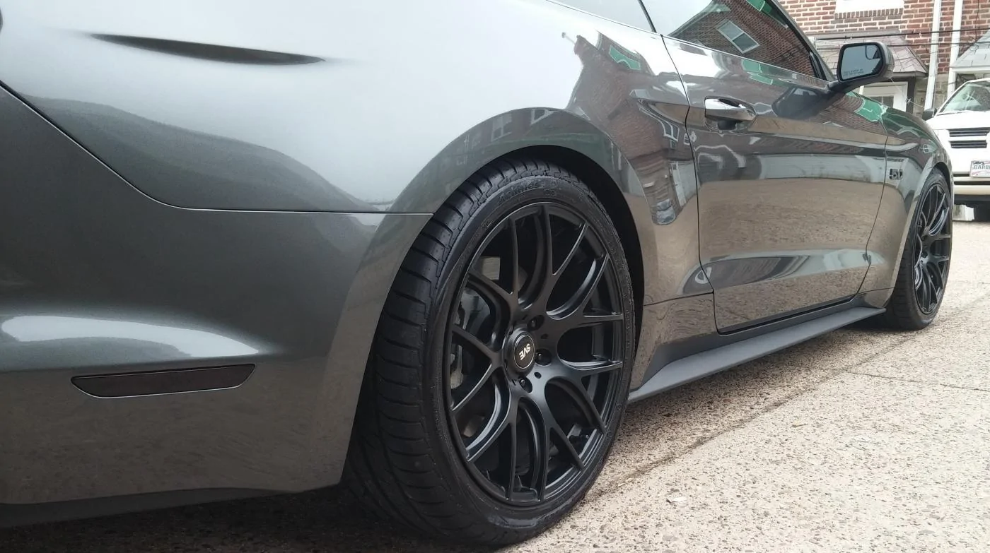

im 19x9.5 275/35 tire 35 offset i might get a 5mm spacer to see if it makes a diff.. pics for ref

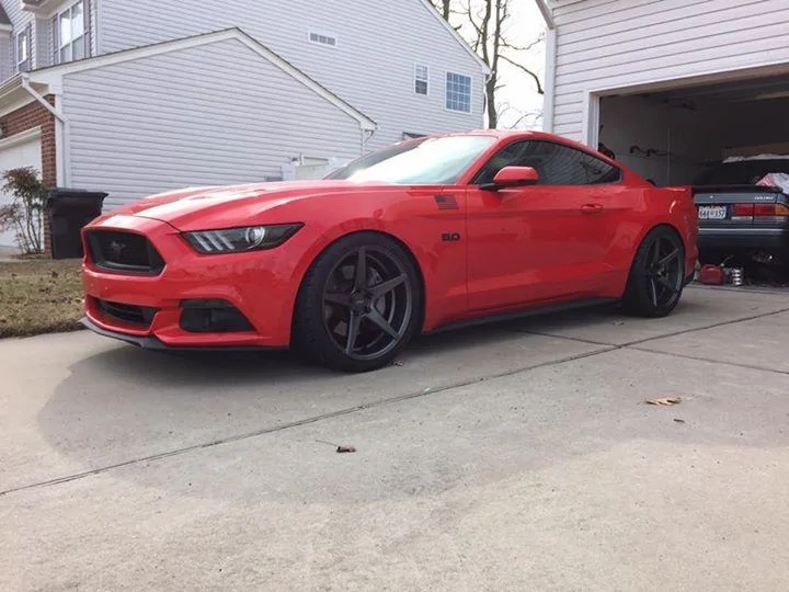

I am running a 19x10 square on 285/35/19 Continental Extremes. Lowered on BMR Springs w/FRP Track Shocks/Struts.
This looks amazing.... Pretty much the look I want to get. I'm also on the BMR Performance (SP080) springs... damn.
