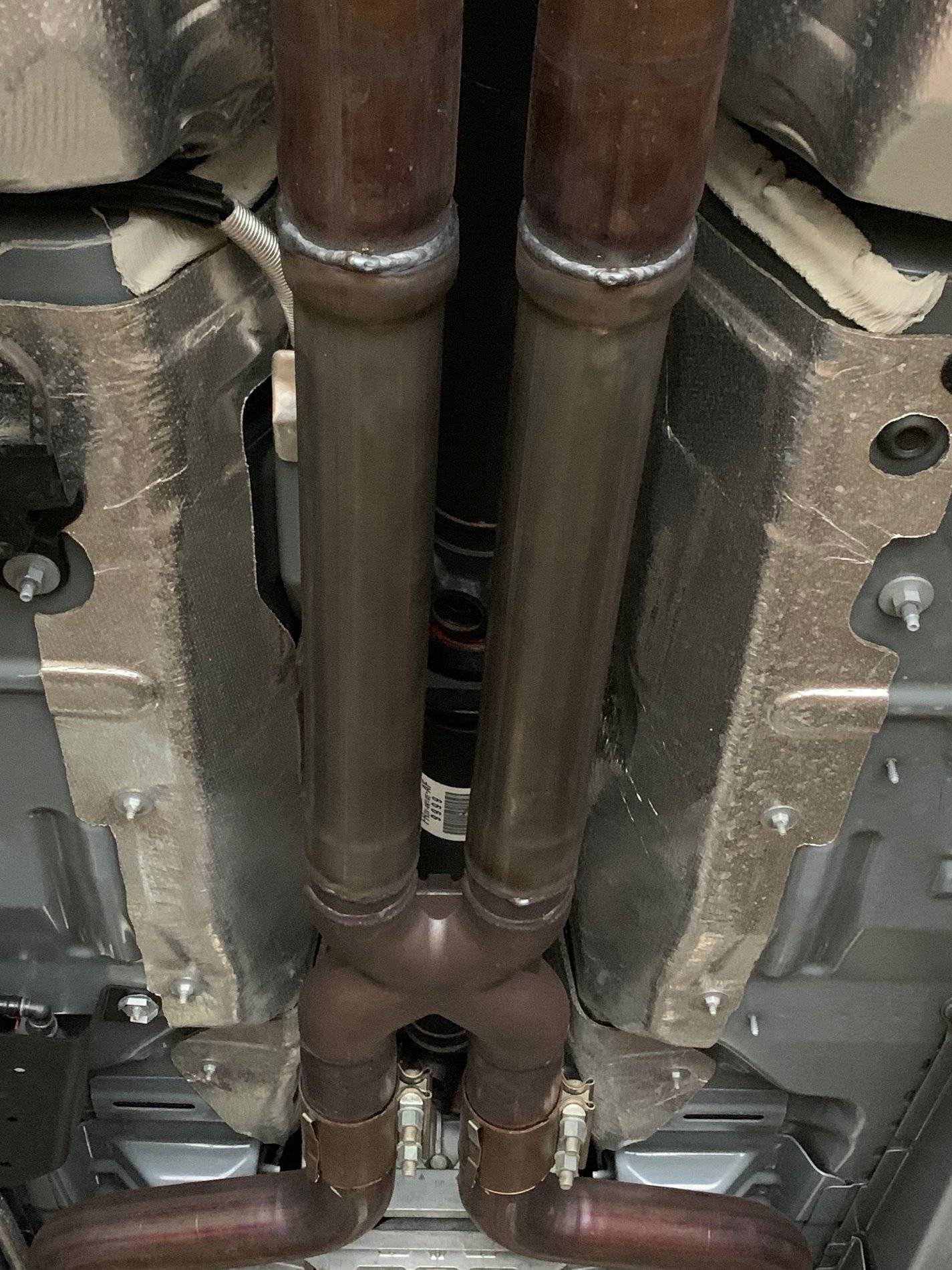

The OEM X-shape is already there before resonators, only cutting off resonators and welding in straight pipes instead. In my case the straight pipes made of T409 stainless steel. As for the price, if I go with say LTH(T409 steel) it would cost me $200 + installation $100. With straight pipes the cost $160 out the door. This shop is doing custom exhausts for years and I checked his work done for the other guys with GT350 and I like it, sound and craftsmanship wise.

So, just replaced resonators with straight pipes welded. The sound doesn't changed the note from the original, just make it louder(but not too loud) producing popping and burbling. I didn't noticed the droning either. Oh, and no additional clamps, it's cleaner this way. I like it so far. Good $160 spent IMO.
