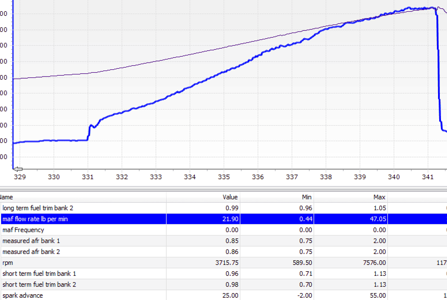

This is what frpp power pack 3 looks like. 47lb/min at 7500rpm. Working with a new tuner now hope to see over fitty

Does the maf flow really make a difference in terms of power correlation. My tune is way stronger with 44lb/min vs when it has a few lbs higher on a dif tune

If MAF is tuned correctly then yes, more MAF means more power.

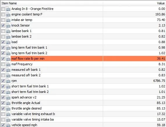

First time logging after getting a Steeda CAI intake and tune. Only other mod is Solo Mach XV catback. Just curious why I'm seeing values much lower than everyone in this thread? I'm in Phoenix, AZ with DA around 2080 this morning.

I saw a max of 45.99 lb/min on a Lund FF tune with only JLT intake and Gibson catback.
