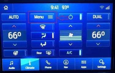

For the third time, I DID see your photos... BUT WHERE THE HELL IS THE MENU BUTTON YOU KEEP TALKING ABOUT? But never mind man. With that attitude, I'll just ask on the Bullitt forum. Thank you anyway.
Seriously?!!
You don't see the MENU button on the pic?
Yeah, now I do :D. When I help, I like to do it right. I had to reply about 3 times before you mentioned the menu button, but thanks anyway. I went to my car, and lo and behold, the button is also there (Duh!). And yes, the second page materialized, so puzzle solved :D.
