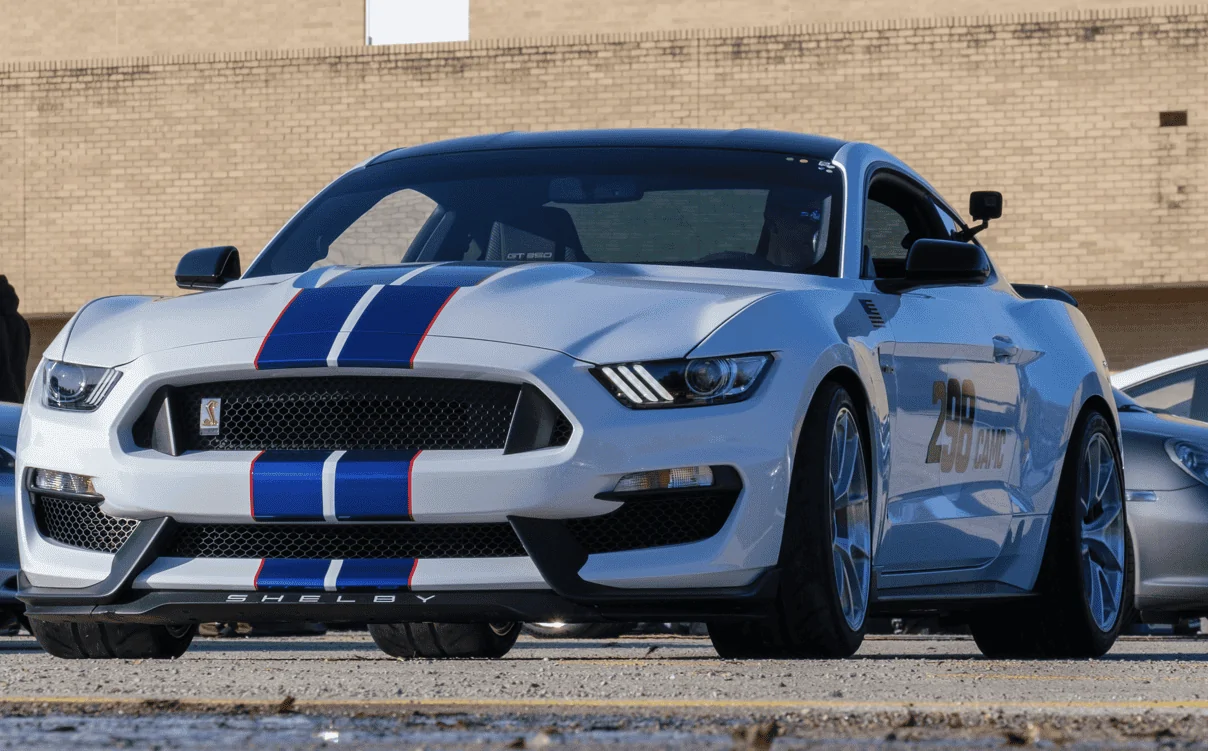

Sure do!Hey there Apex! I am currently looking at going to a square setup of your VS-5RS for my GT350. Specifically, the 19x11 (26 and 52).
Do you have any other pictures on a GT350 besides the April post on this thread of the blue GT350?
Looking damn good Kyle! Such pretty wheels. I like the color too instead of black. What tiers are you running?Can us mustang guys get the 19x12 for both front and rear? I see the current sale only allows the 19x12 for the rear only.

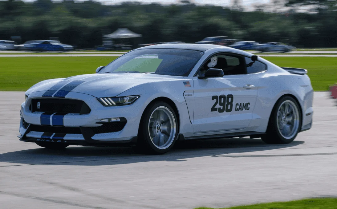

The best pic I have of my car with the VS-5RS in 19x11.5 square. Love the rims.
Falken RT660s. 305s front, 315 rear (I bought tires for the factory 10.5/11 wheels before the Apex black Friday sale). My next set will be 305 on all 4.Looking damn good Kyle! Such pretty wheels. I like the color too instead of black. What tiers are you running?
