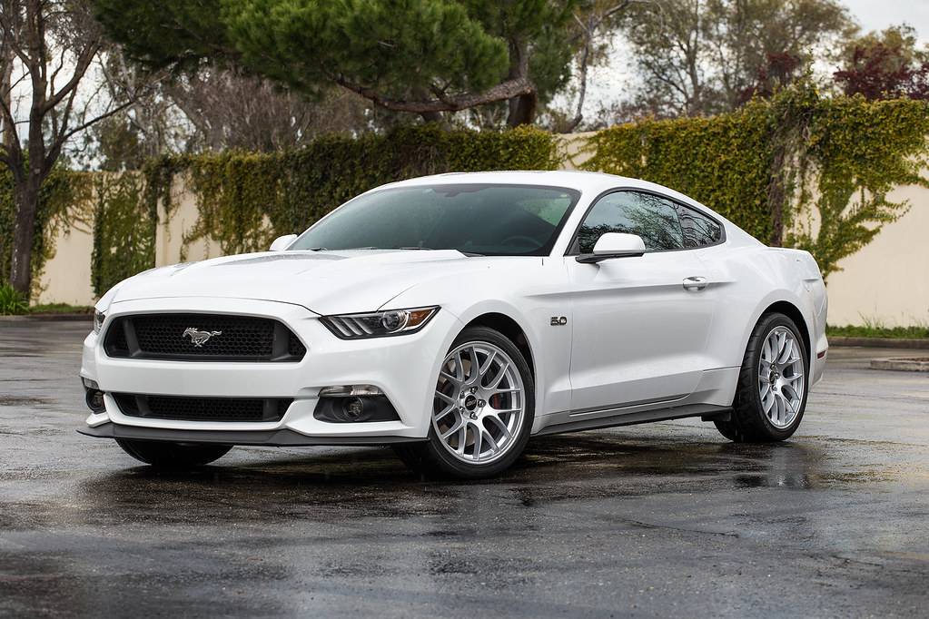

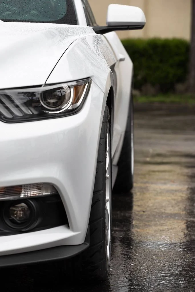

Hi, I looked through our database and couldn't find any S550s with the 19x9 up front unfortunately. The good news is the 19x9" ET34 and 19x10" ET40 sit fairly similar to each other on the outside, with the 9" wheel being about 1/4" more tucked in than the 10".
Here's a couple pictures of 19x10" ET40 all around
