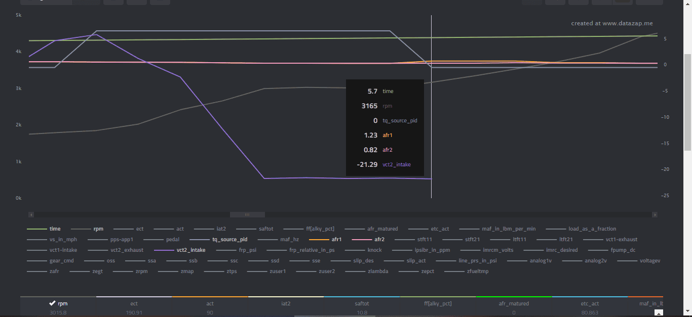

Thanks for that TX-Ripper. I didn't see that I guess. I don't even see where the hesitation occurs. I even blew up the logs huge and cut them to try to pinpoint the event. I'll have another look. Going from negative to positive or vice versa I presume. The one log is weird. for 2 milliseconds there is a spot that goes from .78 afr to 1.23 then back to .8 afr. Sort of coincides with the vct2_intake stopping and torque source dropping (below).
What is vct2-intake? Is there a reason that it just stops in a log? It went from -21.29 to completely gone. Variable cam timing I am assuming. tq_source_pid went from 7 to 0 at this same time. These events took place within 0.06 seconds. No idea what they are or if they're related.
Appreciate the time and advice. Any info on these PIDs?

My experience with the NGauge is sometimes PIDs just drop out and come back.
VCT intake is your intake cam PID and VCT exhaust his exhaust cam PID numbers one and two refer to bank one and bank two

If your car goes even 5% lean you’re going to feel that… 10% or more would be like closing your throttle as far as what the car would feel like

I'll look again at the logs for when the issue is occurring and focus in on the AFRs. But it's just coming off idle at the moment the pedal is pressed. I didn't notice any AFR changes in those areas previously but i'll check again.
