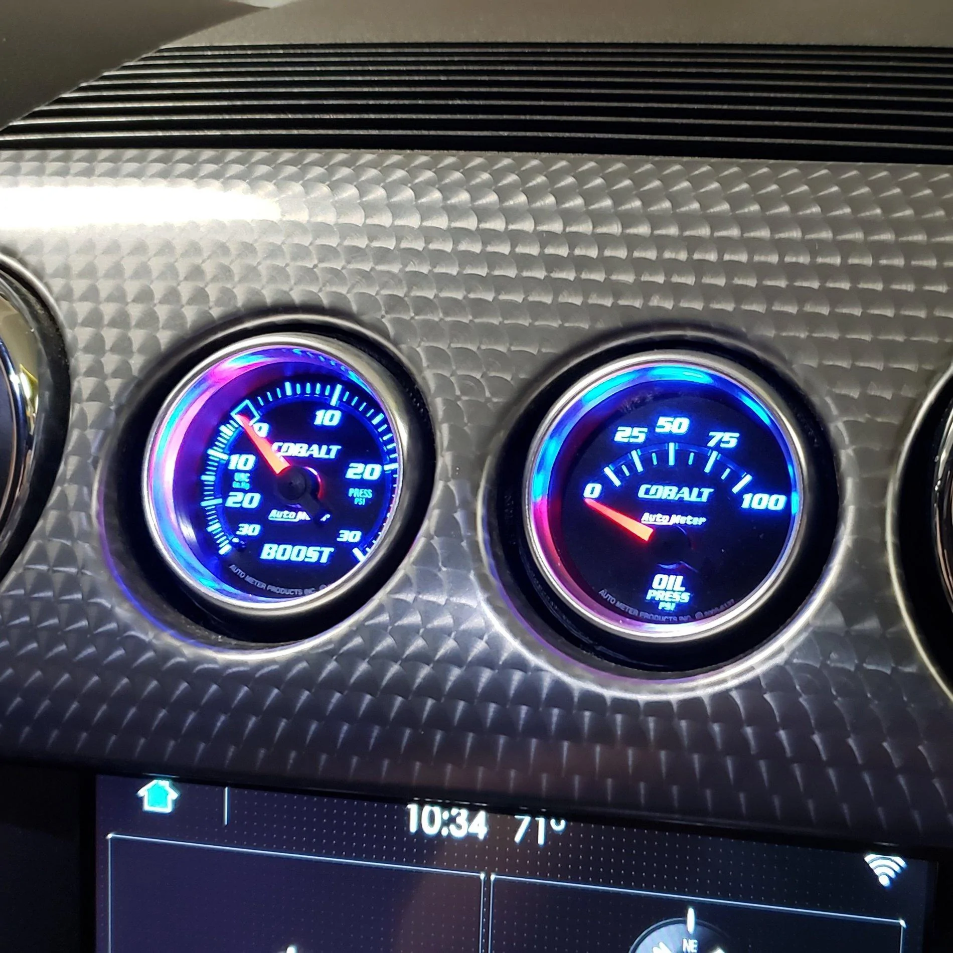

I had one in my car, was not accurate. It said i was making 14psi on an 82mm pulley lol. I changed out the eco gauges for real boost and oil pressure gauges and they look and work awesome.
Did you use a bracket to mount them

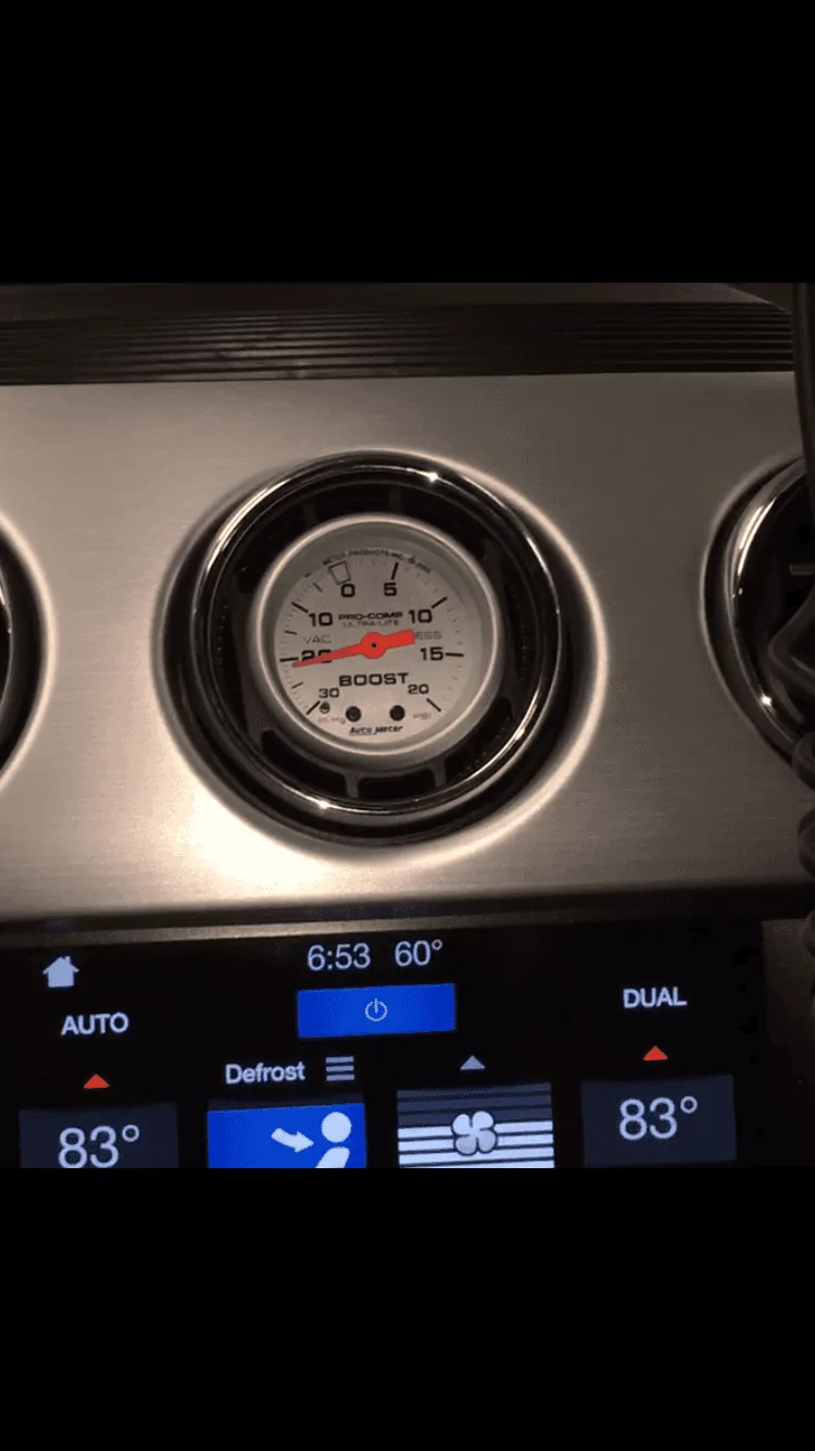

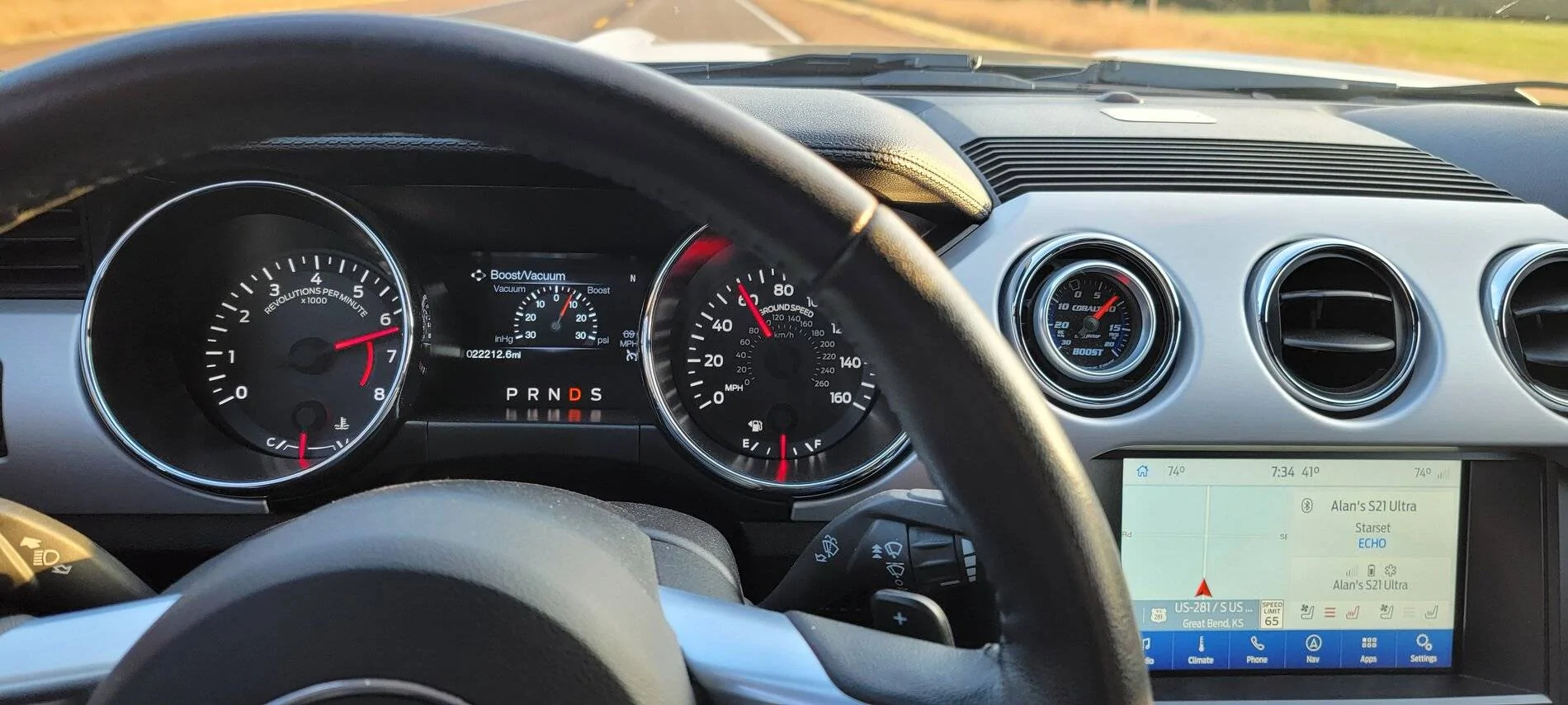

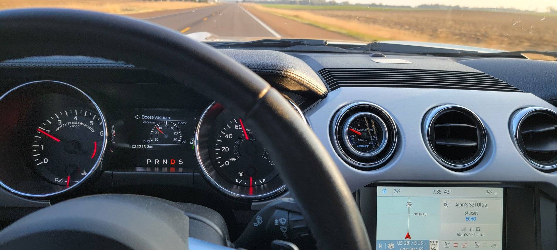

UPDATE:
I now have a real, mechanical boost gauge installed, and I can CONFIRM the in dash gauge pictured in my video is accurate.
This is on the Whipple Stage 1 kit/tune.

The factory gauge looks almost spot on with the mechanical gauge. Of course, the mechanical ones look sweet!!

I like load up and watch that factory boost/vacuum gauge in my cluster. VMP says my supercharger/pulley combo is good for max 10 pounds.
The gauge shows that as spot on.
