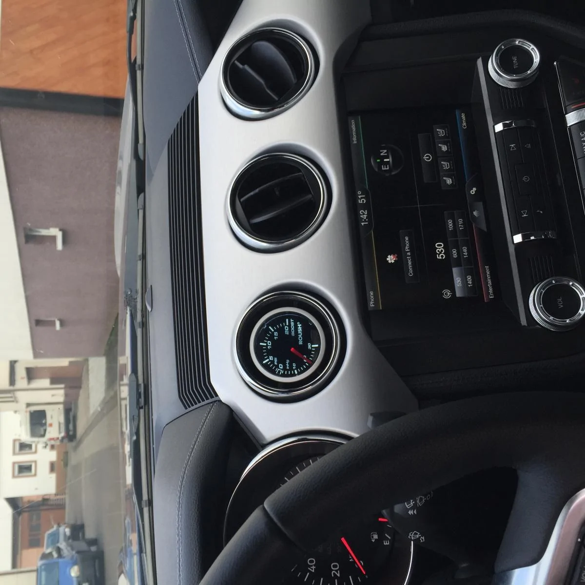

I just installed a boost gauge over the weekend and have a Roush blower. On the right side of the manifold (passenger) next to the blower there are two unused 1/8" ports (in the manifold) that are capped off, one in the middle and one in the back. I used a 1/8"x1/4" NPT compression fitting. You can also just use a 1/8" barb if you prefer.
Hope this helps.
