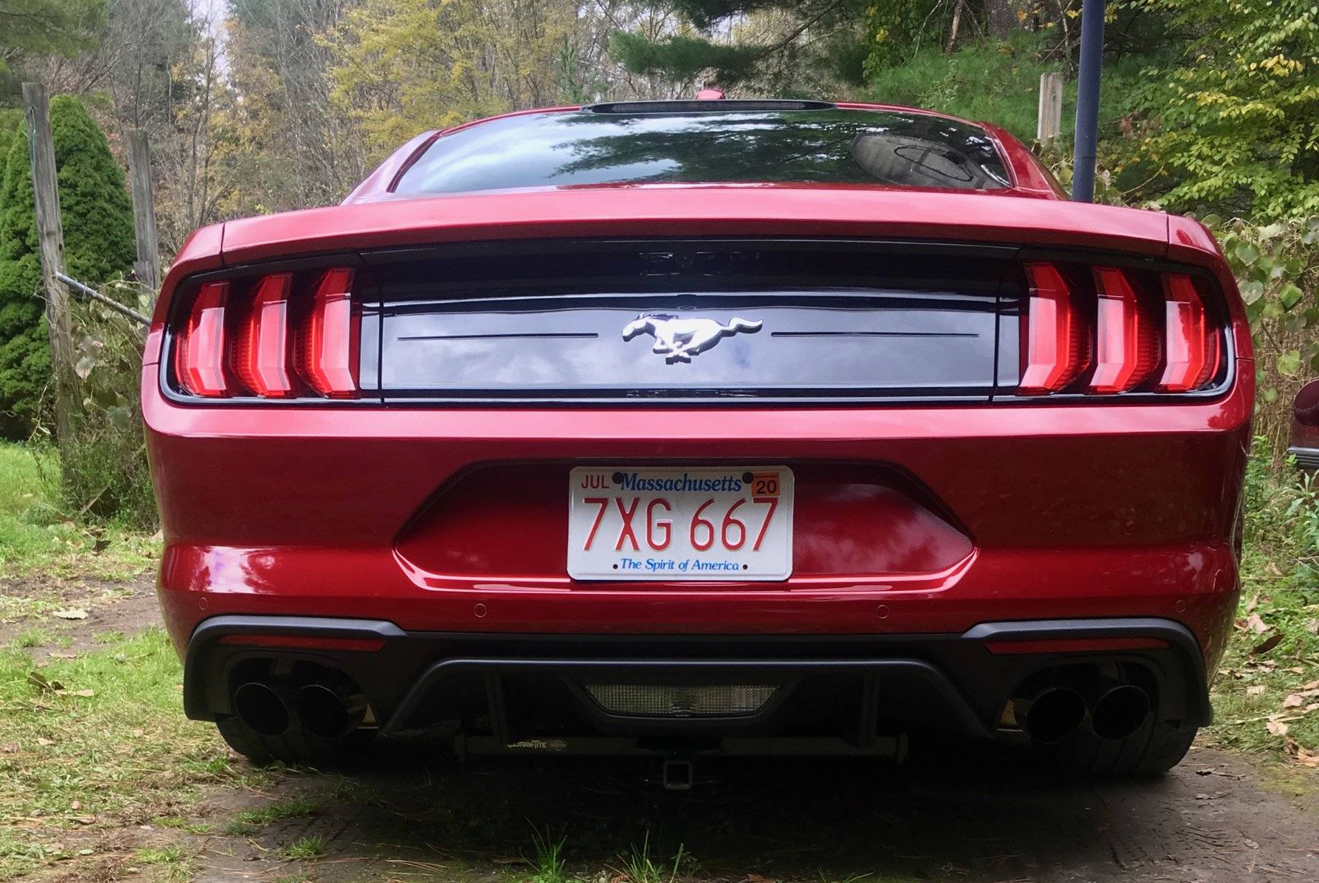

2019+ Eco's had AE as an option and are easily recognized by having quad tips...
Good to know, I've never seen an Ecoboost with that option. Now I kinda wonder how it sounds in track mode, lol. Off to Youtube.
It sounds about as good as it gets with the 2.3, resonator delete from the factory and in Track mode essentially a straight pipe. After I added a the Ford tune I got lots of pops and crackles on high RPM shifts (M6).
