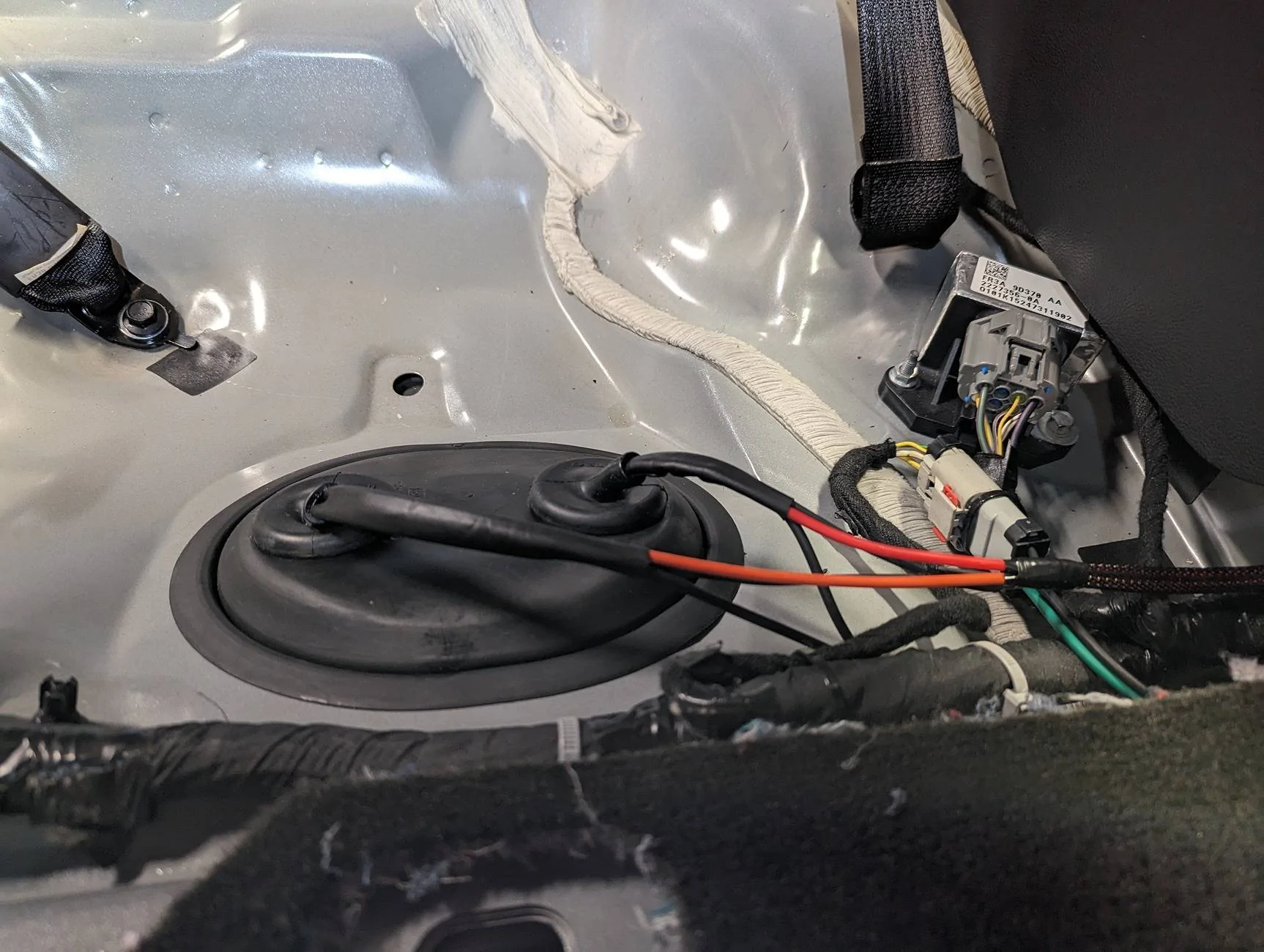

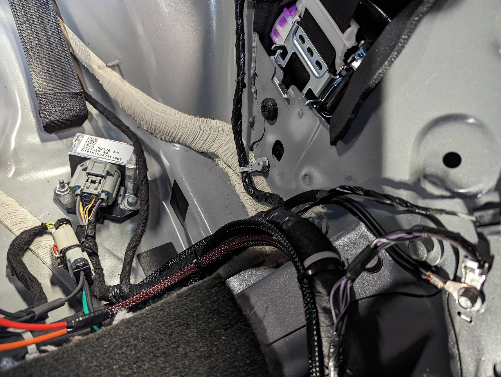

These pictures probably don't help much but Jon Bowen was always quick to respond when I had questions. Not a great tuner but he knows this fuel system.
