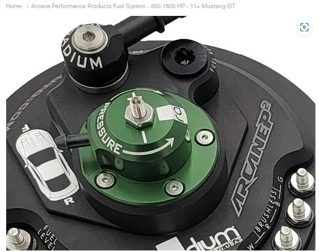

I'm doing the wiring for my stage 2 arcane fuel system right now, and was wondering if anyone has any pictures of what wires connect where on the radium fuel hat?

As with any brushed pump setup with the Radium bucket-
Disregard the "W" and "G" posts. These are only to be used for Brushless pumps.
For each pump (1 and 2 labelled on the hat) the "R" is for your power wire, and the "B" is for the ground. Radium did it this way to designate Black and Red. You can confirm this by looking at the bottom side where the pump pigtails connect, and the color of the wires should match up.
The orientation of the Fuel Level sender wires doesn't matter

Ok thanks. Does it matter which power leads I connect to each numbered pump?
Nope. The pumps and the "Controller" don't know which pump is which.

Will i need any special tools to set the regulator pressure? And what should I set it to?
My Radium hanger is set up for external/remote pressure regulation, but looking at the pictures, it looks like you simply just loosen the jam nut, and turn the Allen head screw in the desired direction. Your tuner will tell you what base pressure to set (Usually around 45-50 PSI static).
