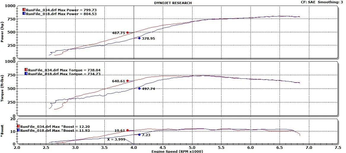

Okay, thanks. I have been looking for the graph that compares the two turbos you offer and shows where the bigger turbos begin to have a benefit over the smaller ones. Do you happen to have that available? I believe I have seen it before online somewhere...
Hello.
Here is a graph comparison we did a while ago. Please let us know if you have any other questions. This was done with an auto trans.

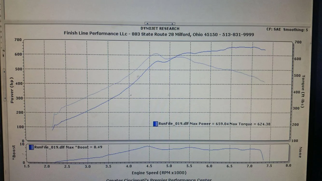

Here's the update... The aftermarket exhaust I put on the car created some issues. It has an X pipe and it seems that it is creating some boost irregularities. They are going to remove the X pipe at the beginning of the week and Dyno again using 10 PSI.

Good numbers for 8psi, congratz !
I would like to know how an X pipe causes boost irregularities ?
Will you be on 93 for the 10psi? What is your fuel setup? Which boost controller are you using? Installing my kit next week, can't wait!

Car is making great power for low boost. 10psi should be fine on 93
Yes - 93, JMS Pump Booster with the ID 1000's, Turbosmart E Boost Controller. I did the Beefcake Special.
Let me know how your install goes.
