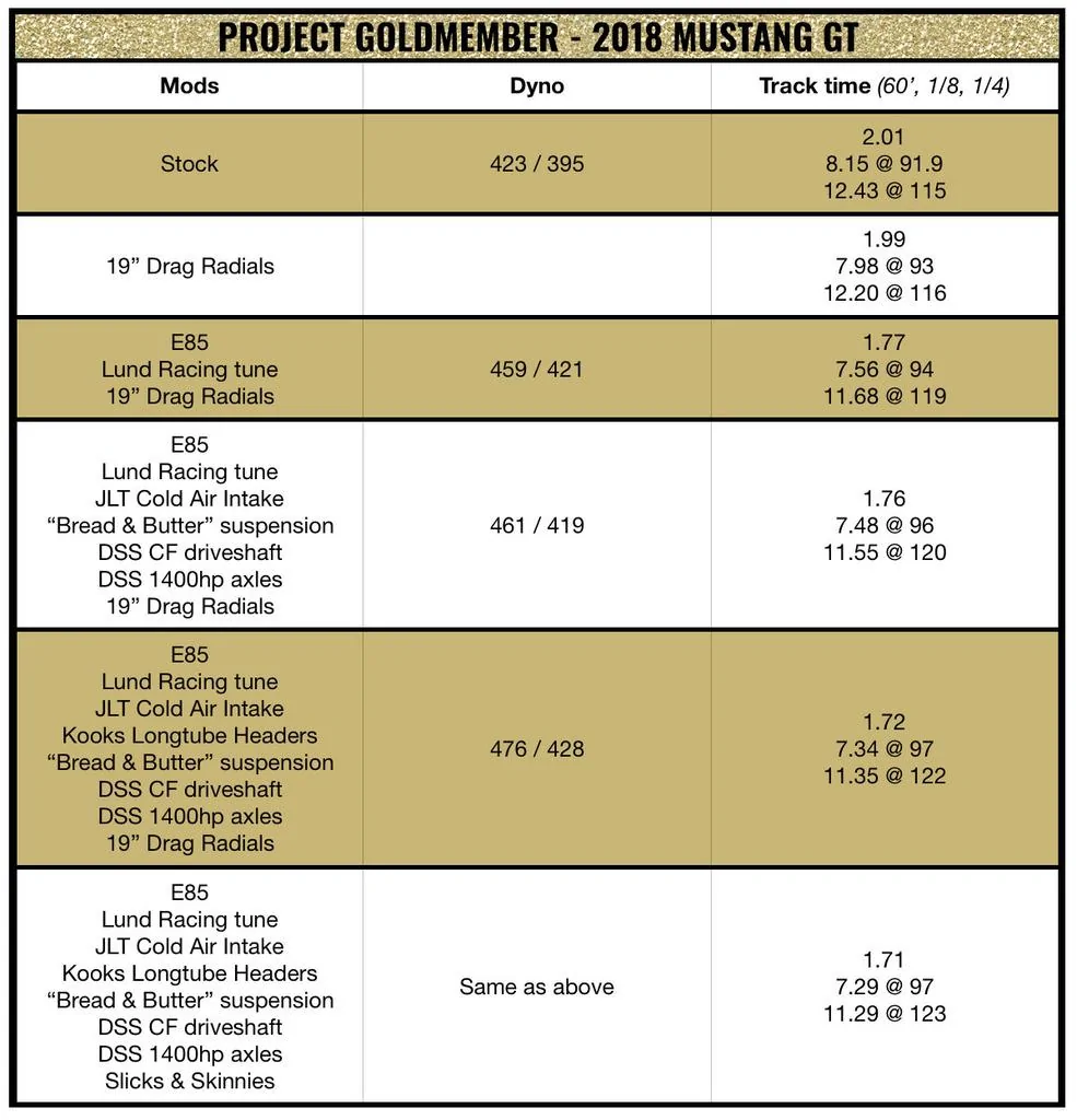

As far as the CAI is concerned this is a touchy subject. After much research myself i have concluded for a simple bolt on car/ lightly modified vehicles a CAI is utterly useless. The stock air box flows plenty and the majority of gains seen by the tune required CAI's are from the tune itself. For example project goldmember, Lethal performances own test car, saw a gain of about 2 rwhp when going from an E85 tune to an E85 tune with a JLT "CAI". I will post their chart below. This was shown on a 2018 car, now for a 15-17 if thats what you have there might be some gains from upgrading the stock box but in reality i wouldnt be surprised if it was noothing more than 5rwhp or so. In truth a drop in air filter and intake tube will likely net you the same results. Now on more heavier modified vehicles bigger intakes can provide more gains but these are the boosted applications or max effort NA builds. Your everyday tune and bolt on 5.0 wont see much however.

What's missing from the table above is the cost of each mod and $ per hp.
TRPCANA
Jun 15, 2019
150
110
2020 mustang GT
well for the question OP had about CAI, considering the JLT is $350 new, for a 2rwhp gain and a loss of tq POST e85 tune, doesn't really seem all that worth it to me. That same $350 can be invested into the BMR cradle lockout and some vertical links and net some better results due to the reduced wheel hop. It is OP's car however.

Easy there killer, im aware the year car he has. I don't have any 15-17 dyno data on hand at the moment so I provided what I had as an example, however the overall point still applies. On a mildly modified car, open element CAI's wont really add much and OP will see more result from the tune. I agree to stay away from the Steeda CAI, a few people have run into box fitment issues and quality problems, I had this issue as well. I also agree with the high IATs I have seen some in excess of 160 degrees.
