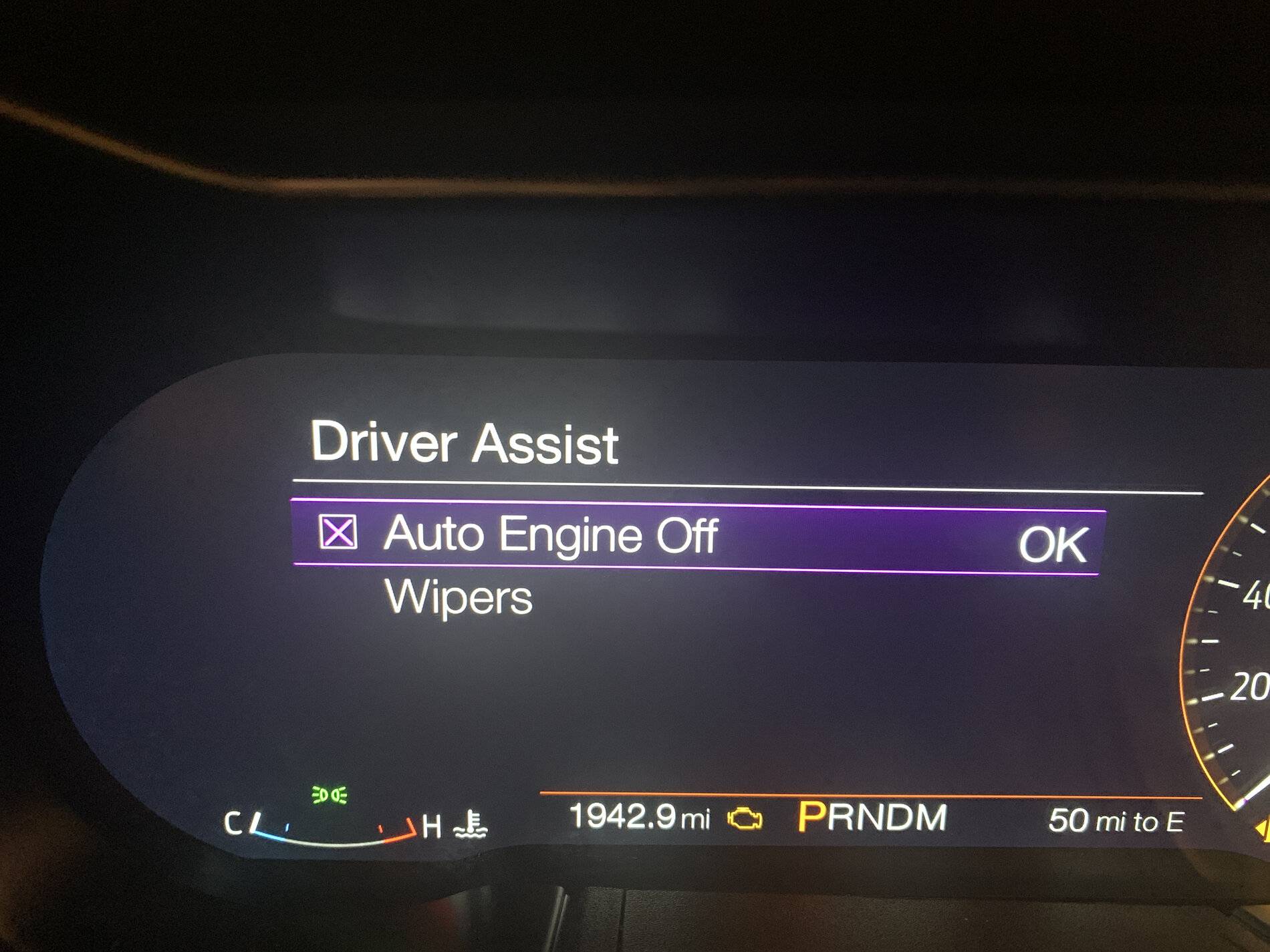

There is an “Auto Off” setting where the car will automatically turn off after 15 minutes if not doing anything. Simply uncheck that Auto Off feature and it will keep going.
Where is the Auto Off setting located, I have looked everywhere and no joy?

Settings button
Driver Assist
Then you see this:
Oh, I was thinking that you found a way to turn off the Battery Management System, this is what cuts off the power when the engine is not running.
I have no problem installing the SYNC updates using the USB stick and the engine "NOT" running, but I do hook up my battery charger during the procedure. But thee are other updates that show up when you do a "scan for updates" that are not available on Fords website and can only be download over Wi-Fi, these are the ones I am having problems with download and installation. The Battery Management System shuts down power before the download is complete.
