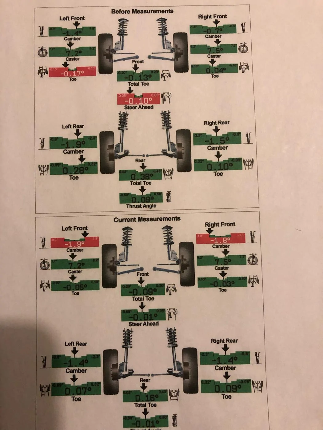

Finally was able to get alignment done. Didn't get as much camber as I had hoped, but better than what I started with,

I'm confused by this statement. Did you ask for more and they couldn't get there with the camber plates, or did they just not do what you asked? I have the Steeda camber plates and run -3° camber, with room to spare, that is why I ask.
I have the same issue. They could only get about -1.9 but want about -2.4. I'm curious about how to get more.

I just did my alignment this week and set camber at -2.2 no problem room to spare using Steeda plates.
