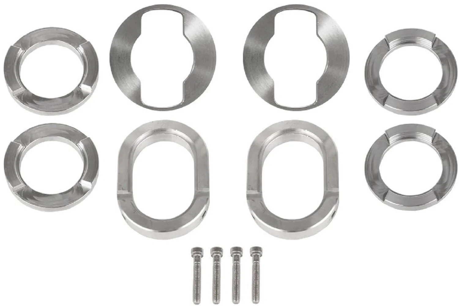

Hey @tj@steeda, any chance on redesigning the rear lower bushing isolation insert? That two-piece design is a royal PITA to install, actually took longer than the rest of the suspension combined.

I got Stop the Hop kit installed today and this is exactly what my installer told me. Nothing against Steeda but he told me that the 2-piece is a PITA and how hard it is to install when compared to the BMR CB005.

Learned a trick during my install. Grab 2, 12 inch 3/8 drive extensions and connect it together . Insert it in the subframe bushing hole and pry away while inserting the 2 pieces, some lube also helps. Took me less than 10 mins to install after i figure it out.
Sounds like you're 'drifting' things into alignment. If so, a length of steel round stock with a taper ground on one end might work even better.

Yeah sort of. Anything long and sturdy that fits into the subframe bushing bolt hole to give you leverage to move the rubber bushing for more space to slip in the support pieces.
I've installed those a number of times now. The concept of "it must be easy to install to be good" is ridiculous, first of all. It's certainly nice, sure. Secondly, no... it's not hard. It's frustrating, especially if it's your first time, sure, but not hard.
I put some Energy Suspension Lube on the back piece, use a angle pry bar, and pop the sombich in its slot, match the opposing side, then screw down the allen heads. You don't need to be nice to it. It takes very little time and you get the added benefit of covering significantly more surface area of the bushing you are intending to stabilize than the CB005's bushing piece. Steeda's bushing supports really are a great design from an engineering standpoint.

Yeah all those cut edits don't show how much cursing and headbanging was going on in that shop!
In my circle of car friends, we say that it's a job for Bill meaning total PITA.
As far as the install goes, I learned a really helpful trick. I removed the rear wheels, lubed the hell out of everything and used my trusty C-Clamp to guide things in.
The first side took me 3 hours and when I came up with the clamp thing, the other side took 15 minutes.

Oh yeah I got that girl nice and wet before ramming that piece in there but it still protested quite a bit. Not my first rodeo, can't remember exactly how many I've had to install. Still, not a fan of installing those rear lower pieces. If the customer is happy I guess all is good, I just know that won't be the IRS bushing isolation kit I install if I ever got an S550. Love the rest of the Steeda product line though!
