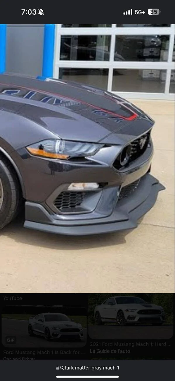

Also off topic, but without getting a whole “mach 1 bumper” is there a splitter attachment that’s similar and compatible with the stock pp1 front splitter? I swear every one I find is for “GT without performance pack”
If anyone has a link for one or something similar please lmk!

Similar to that, but I like the things on the side that poke up as well. Everyone I find like that says it’s not compatible with PP1 splitter.
