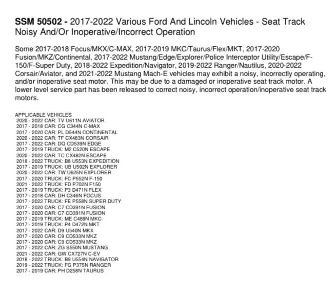

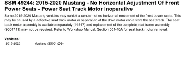

Here's the only SSM's related to S550 power seat motor issues. Granted OP has a 2022, but that isn't to say the SSM issues noted below are only segregated to pre-2022's...
SSM 49244:
SSM 50502:
SSM 49244:
SSM 50502:
Thanks a lot
