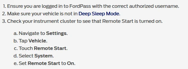

As far as remote start goes (assuming you mean that and not auto start) then this would be what to check:
