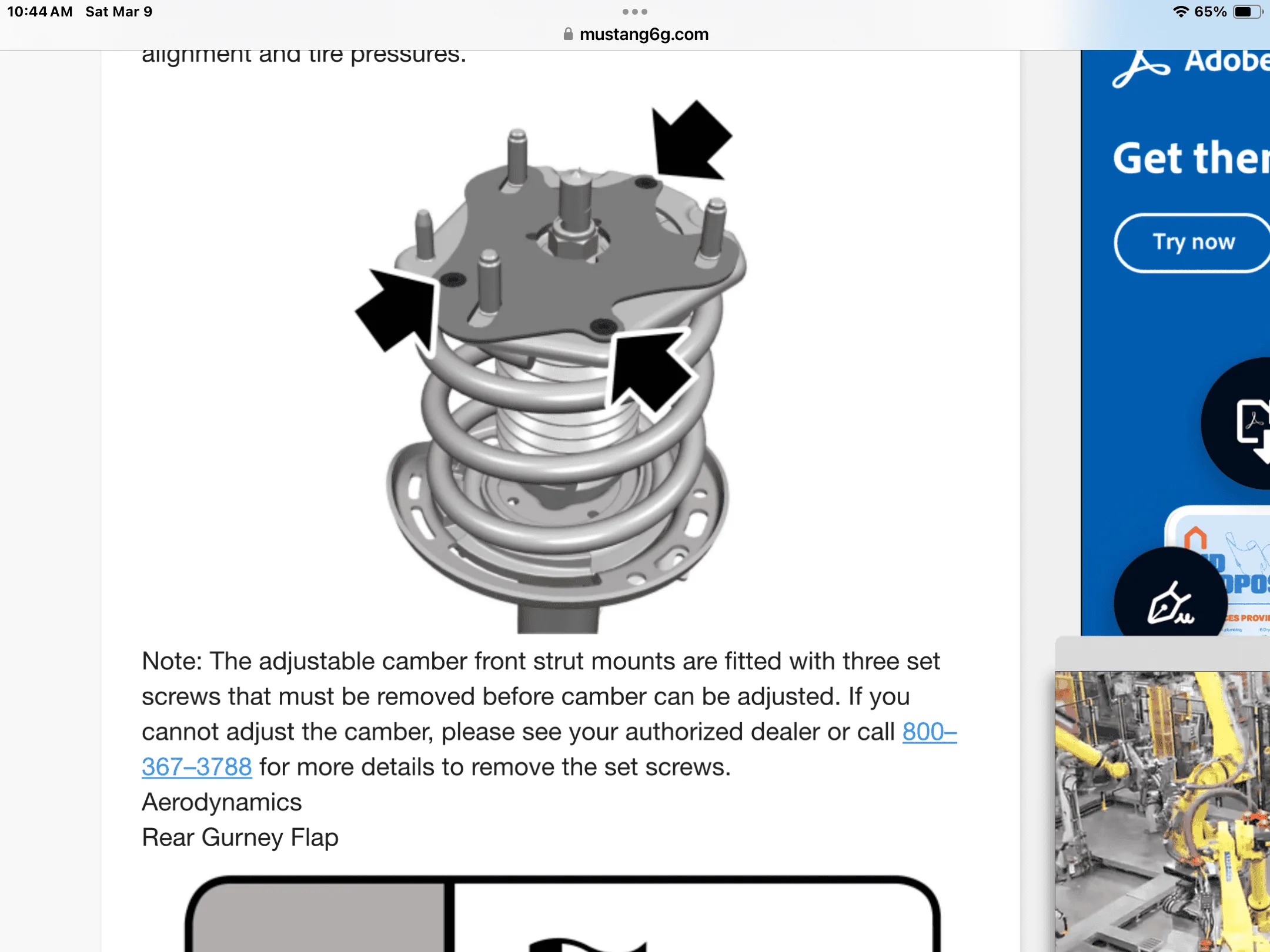

These three set screw need to be removed before you can make adjustments to the camber plates

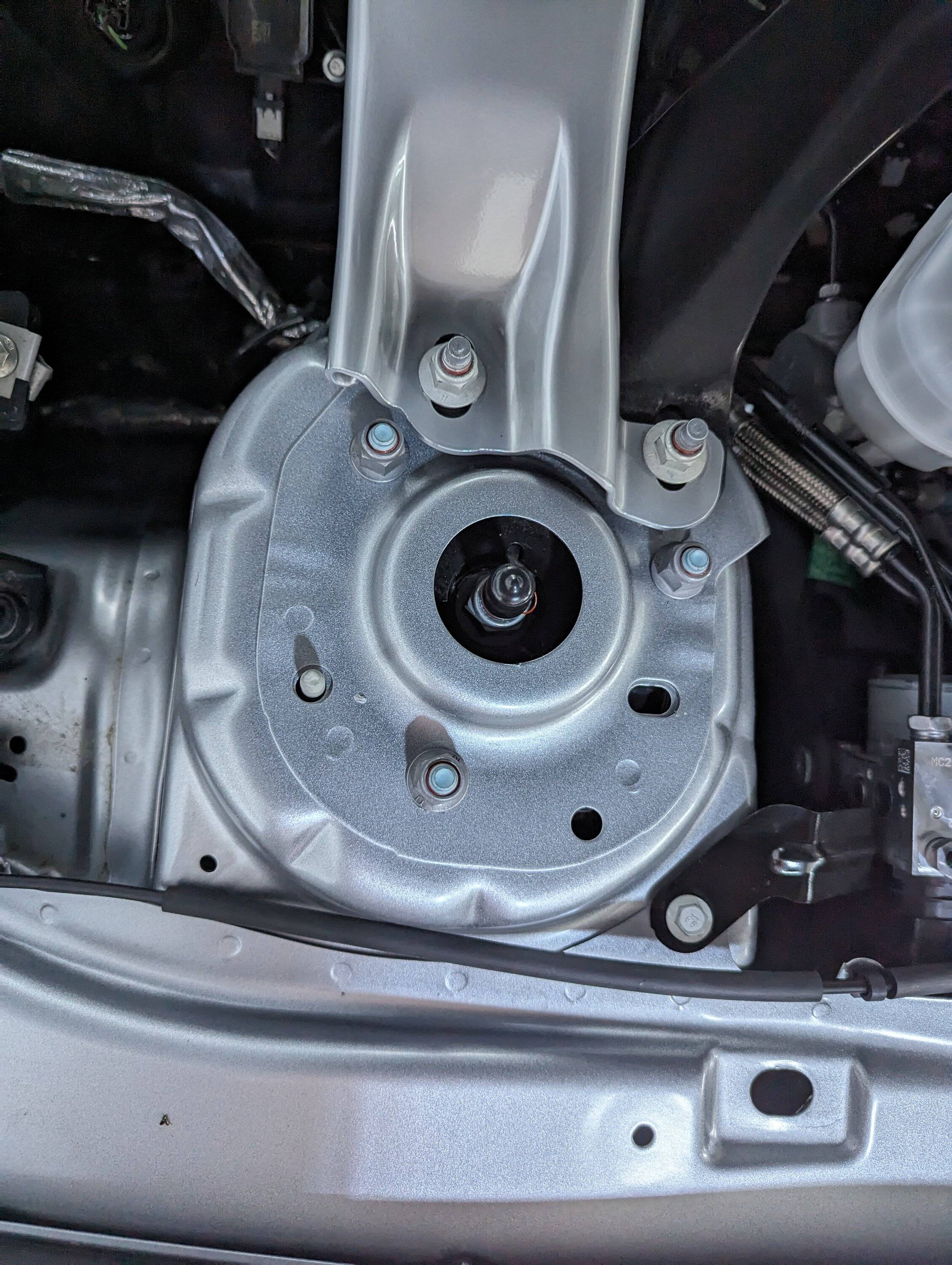

Do you have to remove the shock assembly to do that? I don't have access to those set screws.
