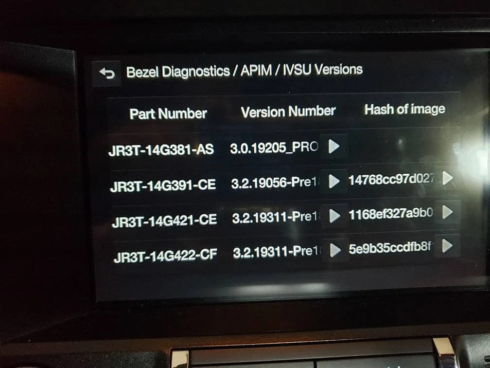

Here is what I have when I get to that screen (2016 GT)
Version is Build 19205_PRODUCT
Navigation maps Version: NA 1 19

Some great info:Short notes (for those 19s with 3.3):
-in the diagnostic menu, check your version numbers. There should be 5 files.
-*21-CAC is the updated MAP. *22-CAF is the updated Voice Nav

..........But still shows 1.18 maps. So how can we get that fixed? No way I'd download everything again just for that, but curious what's the cure. Thx.
Known Issue on existing v3.2 /3.3. No fix until Ford releases v3.4(Unless you use Cyanlabs update method)
If you want to confirm you have the NA 1.19 update pull the IVSU screen and compare it to what has been posted here a few times.

Thanks brother. But you missed what I said right before what you quoted: 'My car checks out okay', referring to those 2 files, which are indeed on my IVSU screen. And nav voice commands seem to work as well (just tried the restaurant one). But now I have a new question for you :D: Are there any other uses for that diagnostic menu, other than just seeing stuff? Can you change anything? Thx.
Lol!!.. I did my bad!.. BUT.. word is Ford might be releasing v3.4 early August...Maybe! As for the diagnostic screen, I dont think any changes there are permanent. Kind of "read only"

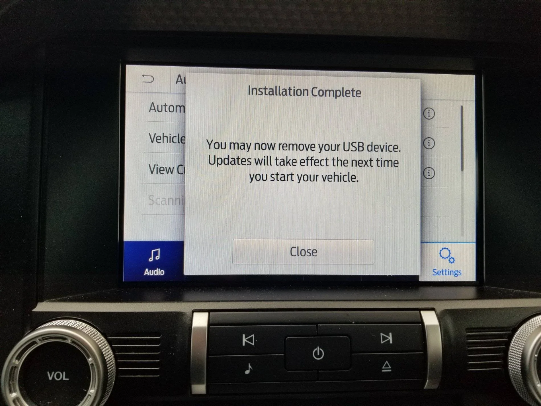

Well after seeing some people having success with just letting the update go longer after the first message of it being done I took the plunge. I decided to drive around for a bit. Saw the update finished message then it rebooted. Got the 2nd system update message. Took about 60 mins and all went well. Voice navigation works. I didn't even bother to see if it showed the correct maps version or not.
Did you this message?
