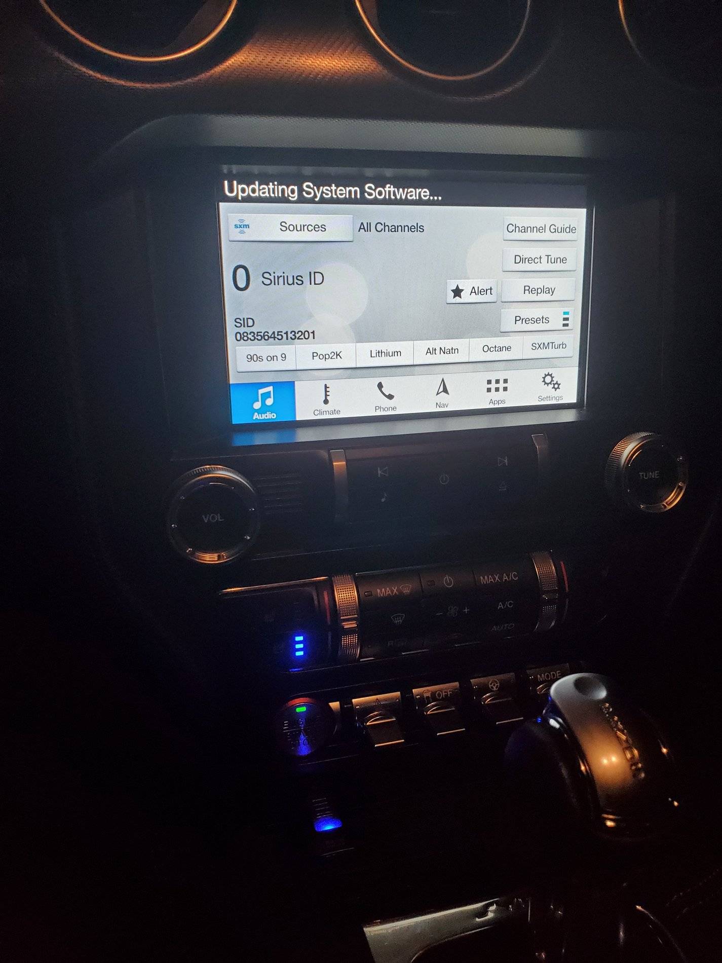

Morning. Another day, another saga in the update wars. :) My car turned off after 45 min of updating (it was cranked with a huge shop fan blowing on it) so I am going to update the sync version and try 1.19 again.
Stay tuned!
Stay tuned!
Why oh why didn’t you just disable the auto off function? Good luck but don’t be surprised if you get an error message.
