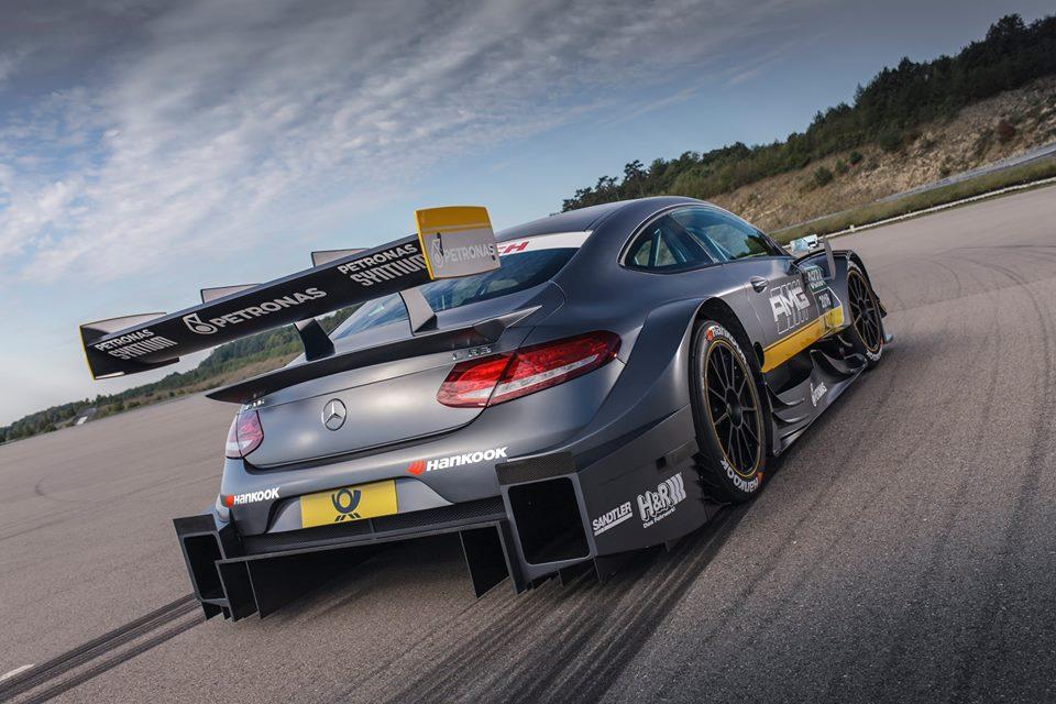

I suppose that's why DTM race cars have their diffusers stick out so far. The angle has to be shallow or else you get flow separation.
