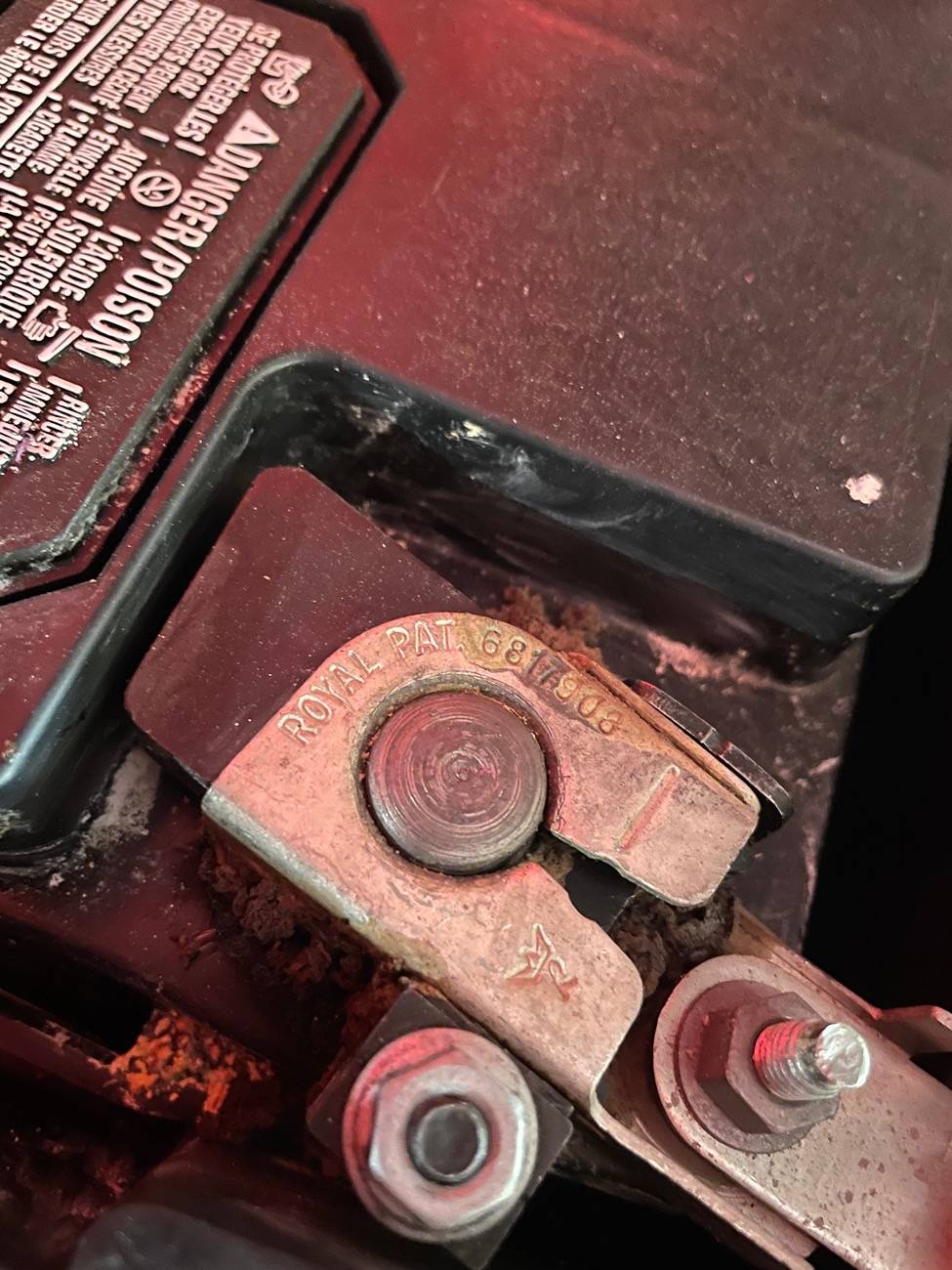

I’m a pure novice/beginner to working on my car. Im replacing the canister purge valve because I threw a CEL. The YT video I watched said to disconnect the negative battery terminal before starting. I started doing that only to discover that I can’t even get it loose enough to remove the terminal. I can only get it to wiggle side to side. Tried to retighten and it won’t tighten either. Long story short, do I have to disconnect the negative battery terminal to do the replacement or could I relatively safely go without?

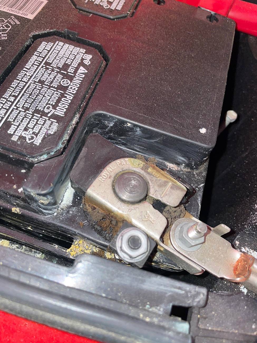

Thanks for replying! No worries on the battery… it’s going to more experienced hands tomorrow. I noticed some crap around the terminal. Is this corrosion or something else?

Corrosion. Not a serious amount but corrosion none the less. Nothing a stiff brush and a baking soda solution can't fix.
That’s what I figured. Could this amount of corrosion be the cause of that terminal being stuck though?

Hard to say without being hands on. Looking at your pictures I'd say maybe. Sometimes the clamp just deforms the lead post a small amount. But it can be enough to make it difficult to remove.
Also, which bolt did you loosen? The one to remove the clamp is the one beside the clamp, not the one attaching the cable.

I second this. On mine recently I found that the lower "jaw" of the negative terminal had slightly deformed the battery post. I could spin it but not lift it off. Unbolted the whole negative terminal clamp and the positive and lifted the battery out so that I could gently lever the negative clamp off the post. It had sort of bitten into the lead post. Much easier to sort out on the bench than in the car.

Just loosen it up, put a large flat heat screwdriver in middle of clamp twist to spread it, keep wiggling it'll come loose. Wire brush the dialectic grease on port battery posts.

Yup, I'd try as mentioned above.
Loosen the clamp and it should lift straight off.
If not, wiggle the clamp while lifting up.
If it still wont come off, then spread the loosened clamp a bit with a flat blade screwdriver while wiggling and lifting up.
