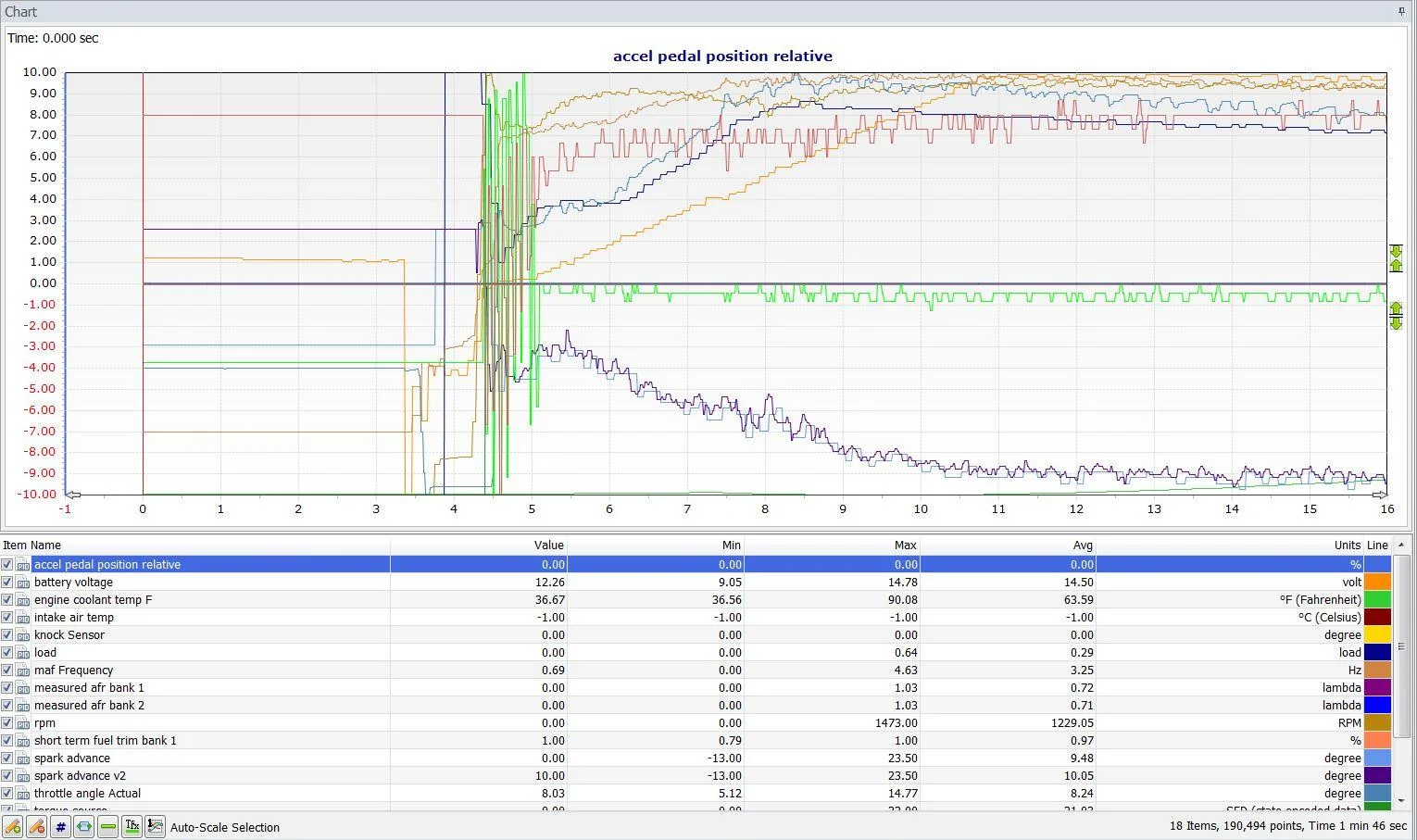

Quick little addendum: Edelbrock sent me a VMP-style brass charge sensor with a mini harness adapter (I'll solder it later) and a tune update to reflect the new RTD curve. We might have a winner! Not only did the first couple of runs read the correct temperature, but it also seems to have stopped the coughing and stumbling on cold start as well! It's going to be 9*F here tomorrow, so I'll try it again tomorrow to verify.
It's odd, almost like even though the data logs SAID the ecu saw the correct temp, it was trying to start with the -74* temp that the dash cluster saw. Who knows. Still keeping my appointment on the 7th with the local guy to iron out drivability (slight surging on maintenance throttle), but at least as of right now I think it's fair to say that it was the temp sensor and the tune's interpretation of it causing the issues. Fingers crossed!

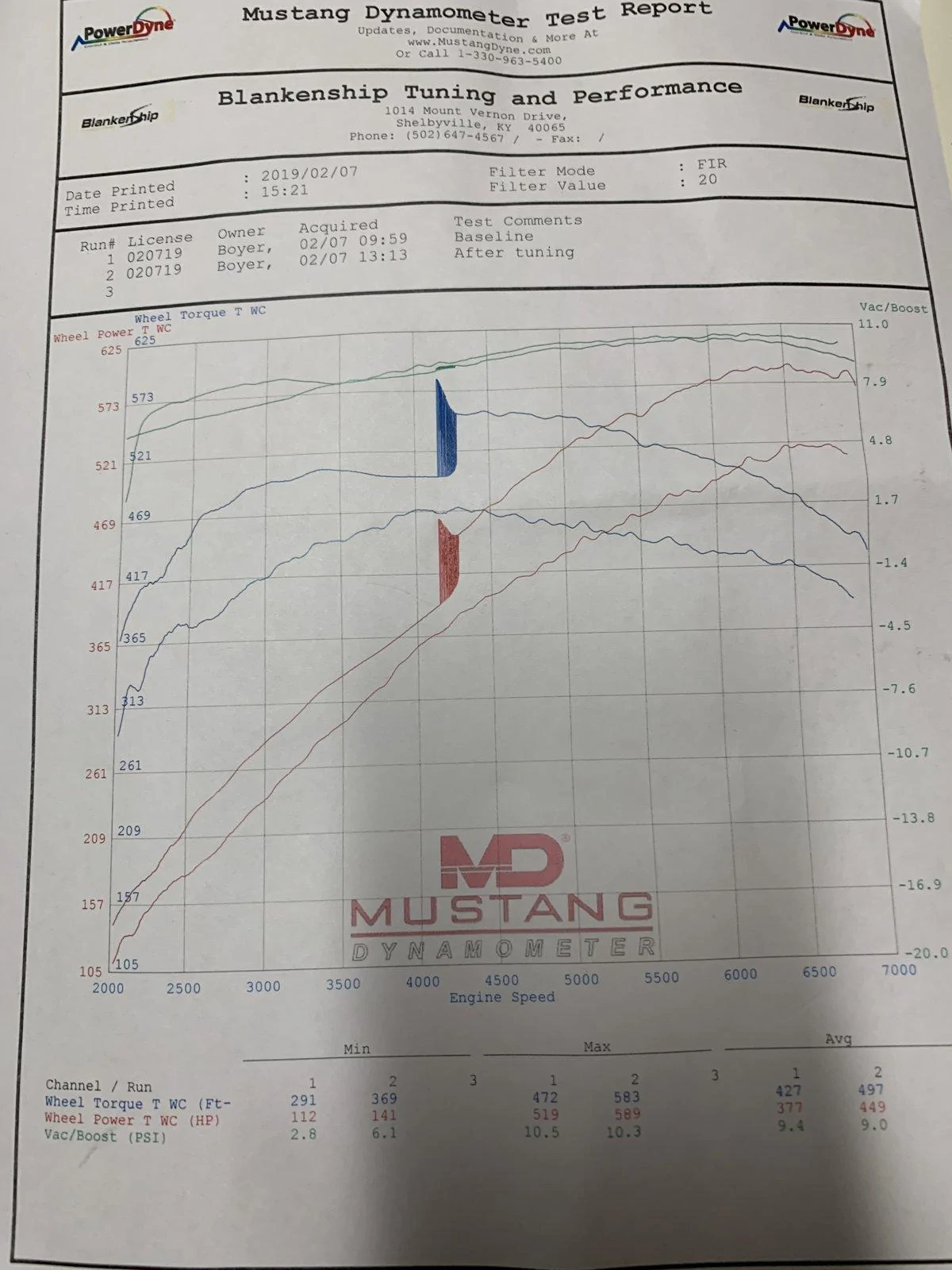

Done, and OMG is it a night and day difference.
The Edelbrock tune was putting down 519whp and 472 ftlb. With this guy being conservative (at my explicit direction) his tune put down 583whp and 550 ftlb. He said the drivability issues were all in Edelbrock’s torque tables and the throttle body hunting for the right torque output. The engine just FEELS happier, and so much smoother through the entire range. My only problem now? Clutch slippage if I ever put stickies on it!
If you ever need a tuner, I can now swear by Lee Blankenship in Shelbyville, KY.

@Jobodizo Those are awesome gains! Is this on 93? How much boost?
Jobodizo
Jobodizo
May 16, 2016
68
621
210
Kentucky
2015 DIB GT
93 on about 10.5psi. Stock headers, cats, and air box.
