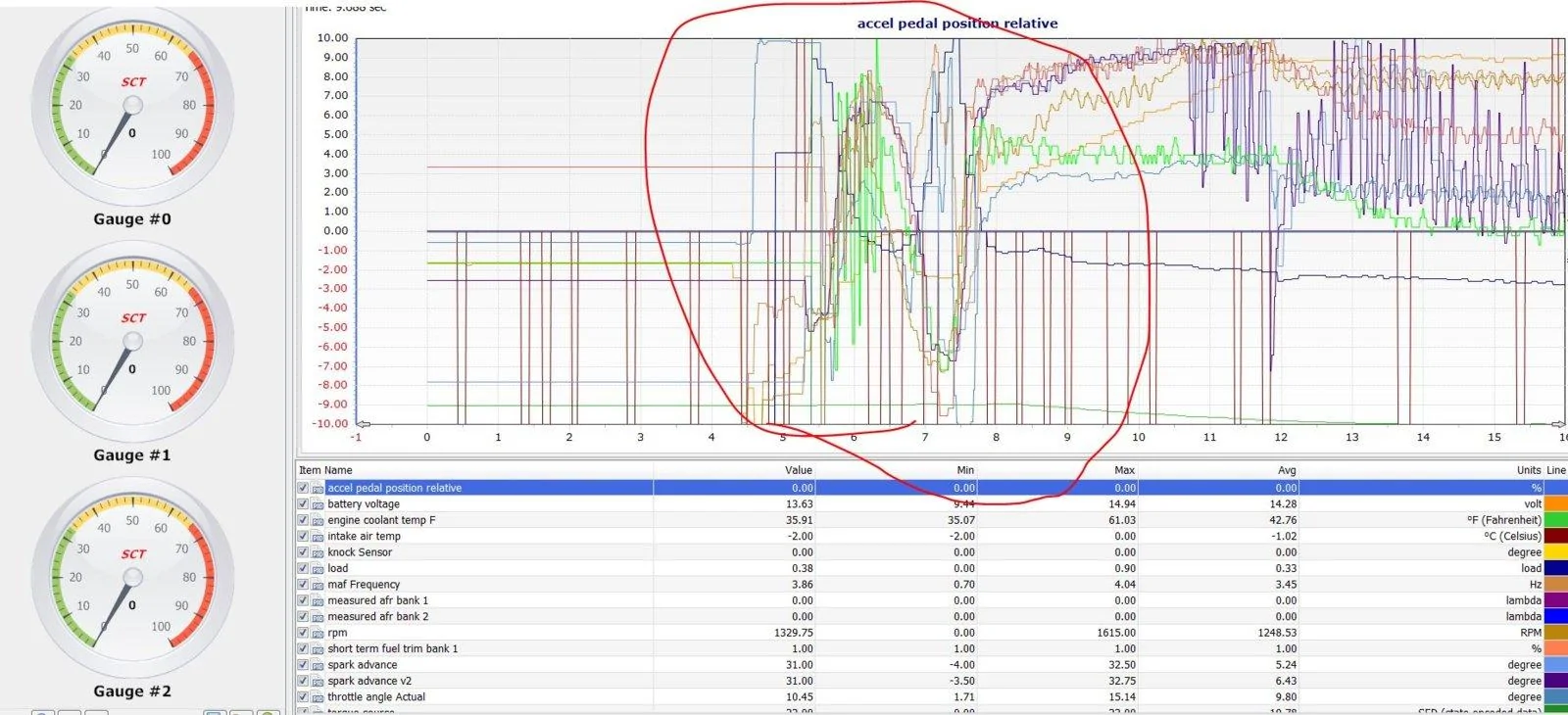

I was able to get a datalog of the car and a hard start. It's not as bad as I've seen (doesn't pause cranking and then have to continue it) but it's there. @ugstang17 I don't know what I'm looking at. I'd appreciate it if you could take a look when you have a moment:

Feel for you bro, hope they get it figured out. From my experience the manufacturers usually do a poor job at writing tunes. They design and build their system and then get their shop car running good so they can send it out for CARB certification and that’s about all they do before selling kits for a bunch of vehicles that most likely won’t work on the exact tune their shop car runs on. They do this because they know the buyer isn’t going to uninstall something that took all that hard work to install and can be made to run great with a custom tune. So, to them, mission accomplished, they sold the hardware (which is their end goal). Hoping they can figure it out for you, but I wouldn’t hold my breath.

Looks like you didn't use livelink to datalog but rather chose to use the X4. Unable to ascertain much. Idle rpm level looks good considering the OAT. Also keep in mind that the fist initial start after a reload of a tune will crank for while. Idle seems typical for an FI setup cold start.
Advice - Stay off the throttle on a drive by wire car during the start cycle, Plenty of guys want to cycle the peddle before starting the car like its it linkage throttle carb'd hot rod. Its not. Simply start the car and allow it to idle down on its own. In cold weather on an FI setup it will take a few minutes. Give it the time. Not doing this can cause rich starts in my personal experience on some tunes. My FI car with cams and LT's would start fine and find idle as long as I never touched the throttle at start up and gave the car 2-3 minutes to settle before attempting to rev the engine or drive the car. It was like that on 2 different tunes. It would rich start and not hold idle for up to 3-4 minutes if I tried pumping the throttle like I was priming the carb or crack the throttle soon after startup. Leaving that throttle alone I never had any issues. Taught me a valuable lesson with these drive by wire cars.

@ugstang17 I actually did use the LiveLink software. I just looked more closely and realized there's nothing populated for AFR. Very strange.
Trust me, I have to audibly remind myself in these situations not to touch the throttle. These cars aren't like the 50 yo classics in the garage, and all that would do is lean out the attempt to start.
I don't mind extended crank time or giving the car time to settle into idle; quite frankly I let the idle drop to ~750 before taking off even when it was NA. What's getting me is the STRUGGLE to start. It feels like a car with a points distributor that hasn't been started in months trying coax itself to life. More specifically, the dip at about 7 seconds on the chart below where it seems like it's going to die before it finally builds RPM.

send me the excel file so I can look at it on Live link II.

Yip. That I see. Probably as mentioned it has to so with being 50 state C.A.R.B. compliant would be my guess. That all would be in the tune. THe Canned tunes for these turn key packages aren't the best in the world. Even if they put down a dyno number the power is hampered from getting to the ground through all kinds of nanny strategies and soforth that on the track the car runs hardly better than it would stock.
