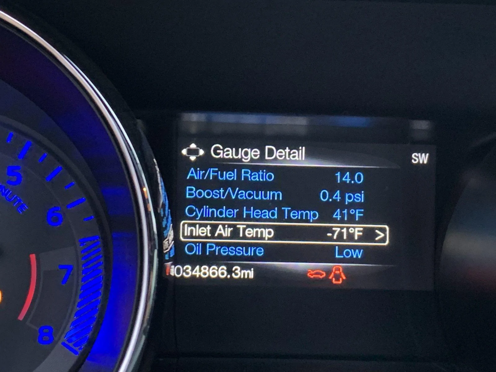

So Edelbrock sent me new harnesses overnight. Throttle body error is gone. Now it’s just -71*F in my runners...thoughts?

@Jobodizo Is that with the vehicle on or off?

What does it read when on?

Going to hold off starting at for now. It’s run rich a few times now because of the IAT error, and I’m starting to get worried for my spark plugs and O2 sensors. Just spent the last hour and 15 minutes on the phone with Edelbrock tech support. With their supplied harness plugged in, I was reading -71° F and with the original harness plugged into the MAF sensor I was reading 169° F. Reverted back to the stock tune while I was on the phone with them and started getting an accurate reading with it plugged directly in. At this point I think the prevailing thought is that now there is an issue with the tune.

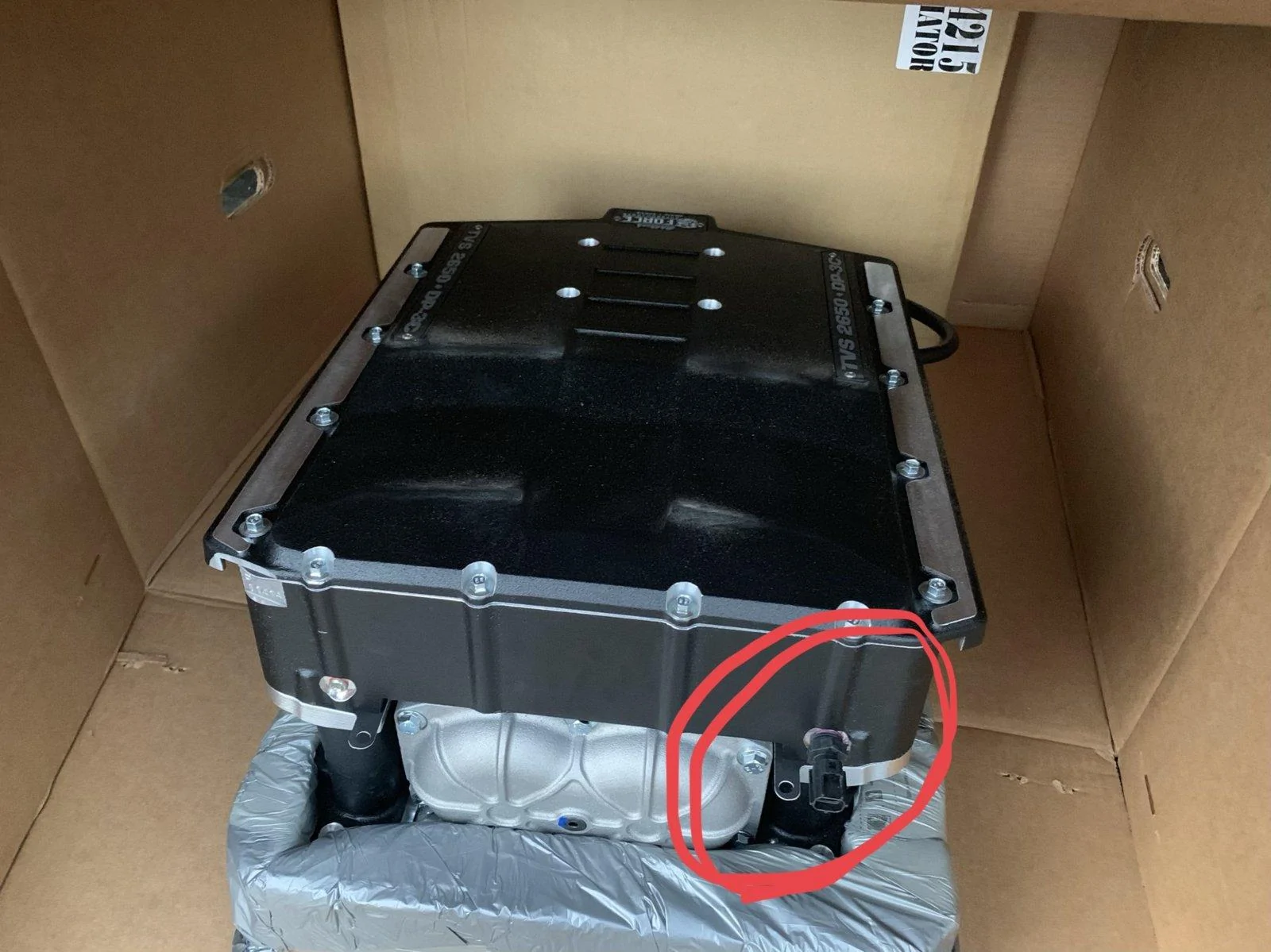

You've got this if Edelbrock will simply send you another temp sensor to install.....assuming it isn't buried in the SC housing and not accessible. My IAT sensor is exposed and mounted right on an intake runner on the passenger side between Cyl 2-3. But that is a 2300 TVS Ford Racing setup. The edelbrock as I recall from seeing the build videos may have the sensor in a different or tighter location.

@ugstang17 can and will do. The sensor isn’t quite that easy to get to, but it is accessible.

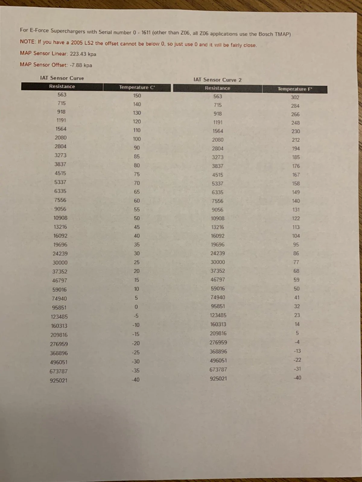

I was able to talk to somebody else, and he was able to give me their resistance curve for the temperature sensor in the runners. It’s sleeting outside right now, but I’ll get outside first thing tomorrow morning and check it out. Here it is if anybody is interested:

The 14F - 212F range has the same resistance as the pdf file I attached. That's good to know. Ford just does not provide the full range since it isn't applicable to IAT2 apparently. I could only speculate as to why the reading on the display screen is now working properly. The only possibility is if the voltage on the system was so low that the ECU could not produce the 5vdc out IAT so the drop measured was way off. That is a spitting in the wind hunch. These S550's are so bizarre compared to my 14 and 13 GT setups. I am really starting to miss them. I may even hold off doing any more, take the deep plunge (my idea of spending big anyway) and trading for a 13/14 GT500 this summer. I keep saying this but I have to get the Ford tech manuals and prints for this platform.
I would def start the car and let it idle up and see if the IAT is rising as it naturally will as the engine warms up and the car is sitting still with the open element air intake device. I'd still check the resistance afterward and see that it matches what the sheet says the resistance at that temp should be.
