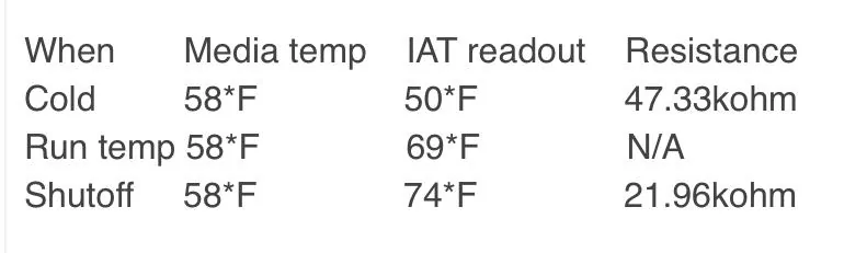

Ok here we go:
Couldn’t get run resistance obviously, because the engine would code for an open circuit. The 21 number is after 10-15 seconds of heat soak with me jumping out, unplugging, getting the meter on it. Numbers essentially track when you consider it was IAT of 86* by the time I reconnected the sensor and checked again.
The IAT appeared as normal and the car restarted just fine after this. It’s supposed to be in the 50s here through Wednesday morning, so if this is a cold-related thing I might not get my -71 until then. I’ll update if it pops up again. Intermittent weirdness is almost scarier than consistent. :crying:

The readings are showing low but they are close. 50F on the sheet indicates 50.016K and your actual is 47.33K (2.686K diff). The 74F is 21.9K and actual should be just under 30K. Since the sensor is not linear, I cannot calculate exact temps but it does appear that the sensor is reading low. It appears that the sensor is not providing the proper temp range. Have you rung our your wiring harness to make sure you don't have an intermittent open? I am trying to figure out why your kohm readings are low (temp display should be reading higher) yet the -71F on the display indicates that the sensor is reading greater than 1 megohm though it is only rated to -40F.
21.96kohm should be indicating a temp closer to 90F and not 74F according to the chart.
47.33kohm on your initial reading is within 1 degree of proper reading according to the chart.
How long does the car have to run to get the -71F temp? Or does it read like that after sitting overnight? Try to get a reading on that sensor when the display is showing -71F. There is something very odd going on there. given the OAT's the IAT range at warm up and sitting at idle should be 40-120F. That would be a resistance reading anywhere between 75K and 11K on the sensor. When the display indicates -71 if you take your reading on the sensor as you have and it reads within this range, then I suggest you have a corrupted tune file. The only other possibility would be that they installed the wrong IAT sensor (assuming other vehicles may use another sensor range) or the sensor itself is bad. You have verified your wiring several times so I doubt there is an issue there.
Otherwise as I would have to do at work some times, pick the phone up and call the tech support guys and tell them your findings. Maybe they have run across this before as well. Having done tech support in the past I kept a running log of problems so I cold see trends. They surely do the same thing. If I can be of more help let me know. Just PM me.
