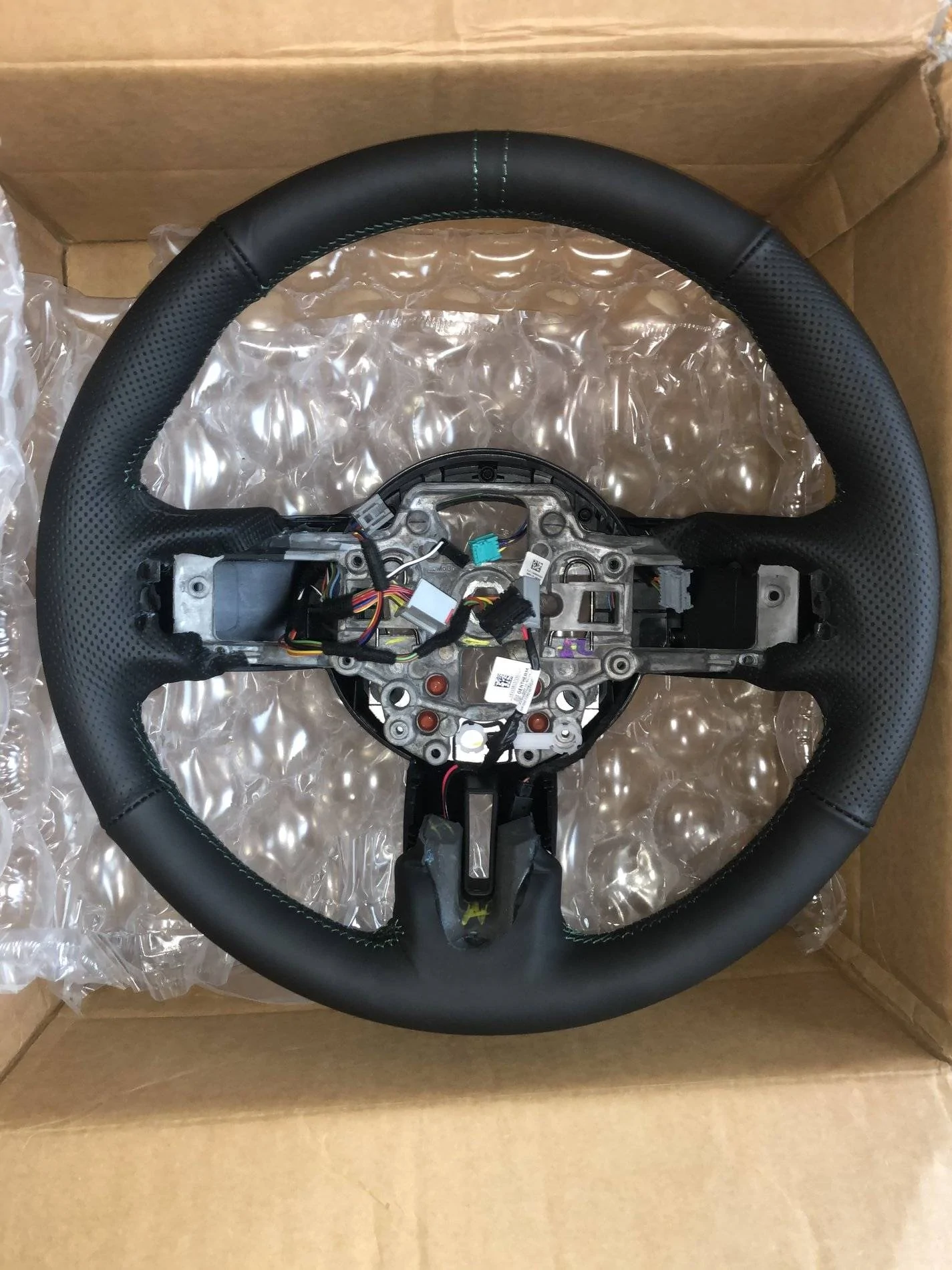

Need help with steering wheel wiring

I sent my steering wheel to get reupholstered and the wires came back different. Can anyone help me fix this I’m not sure the right spot for them to go.

Pull off the back panel. Then match the switches to the plugs and route accordingly. I know that the main harness plug should be at 12 o'clock. Can't remember the colors for the other switches. But the switches match the plug colors

There is a great video that CJ Pony parts did on replacing the steering wheel. You can use that as reference. It helped me when I have to re-route the wires. You can find it on Youtube.
