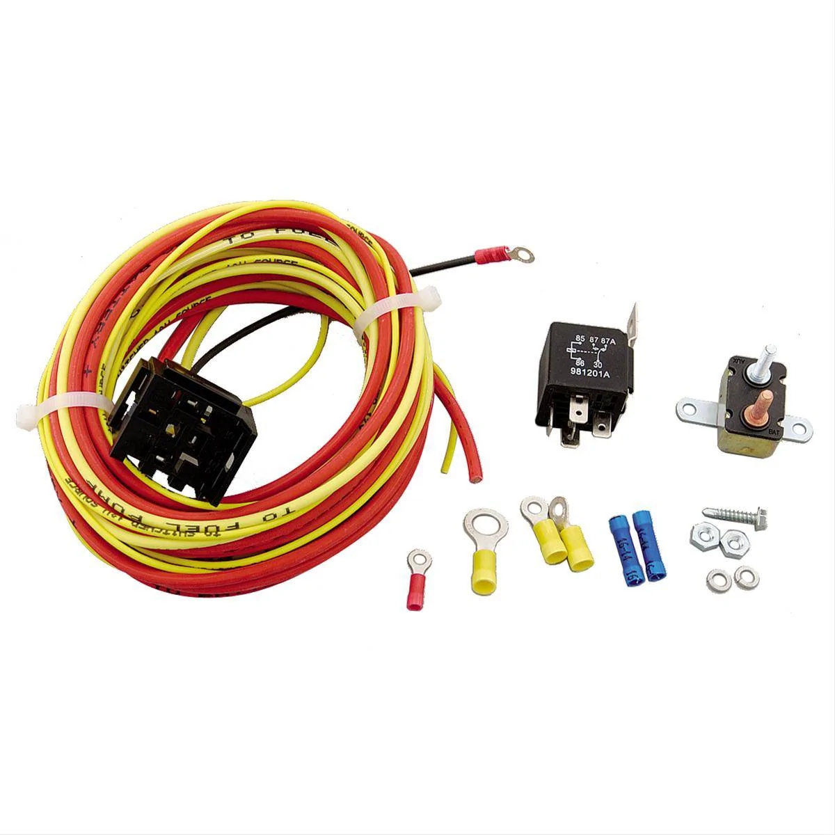

You might not want to do this. The window defroster is a timed circuit that will automatically shut off after a while. Is that going to be a problem for your diff cooler? Will you remember to turn it back on when you're doing laps?
I would just wire in a new circuit with a dedicated toggle switch or have it live all the time with thermostat control. That way you won't need to even think about it's operation.
