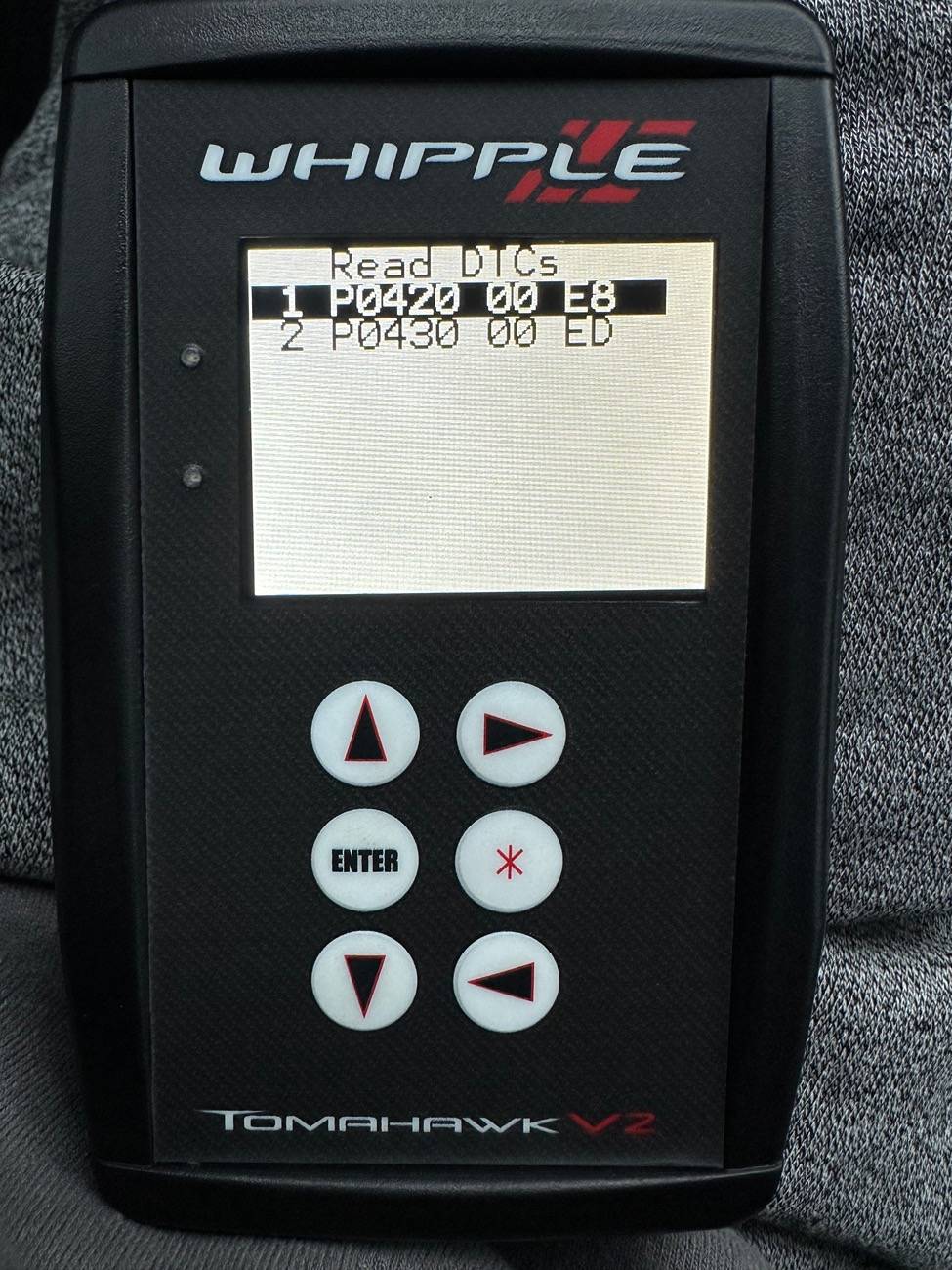

Those codes are low catalyst system efficiency which is what you would expect if you don't have cats on your ride...
Won't affect how the car runs so enjoy the blower!
These are while the cats were still on.
