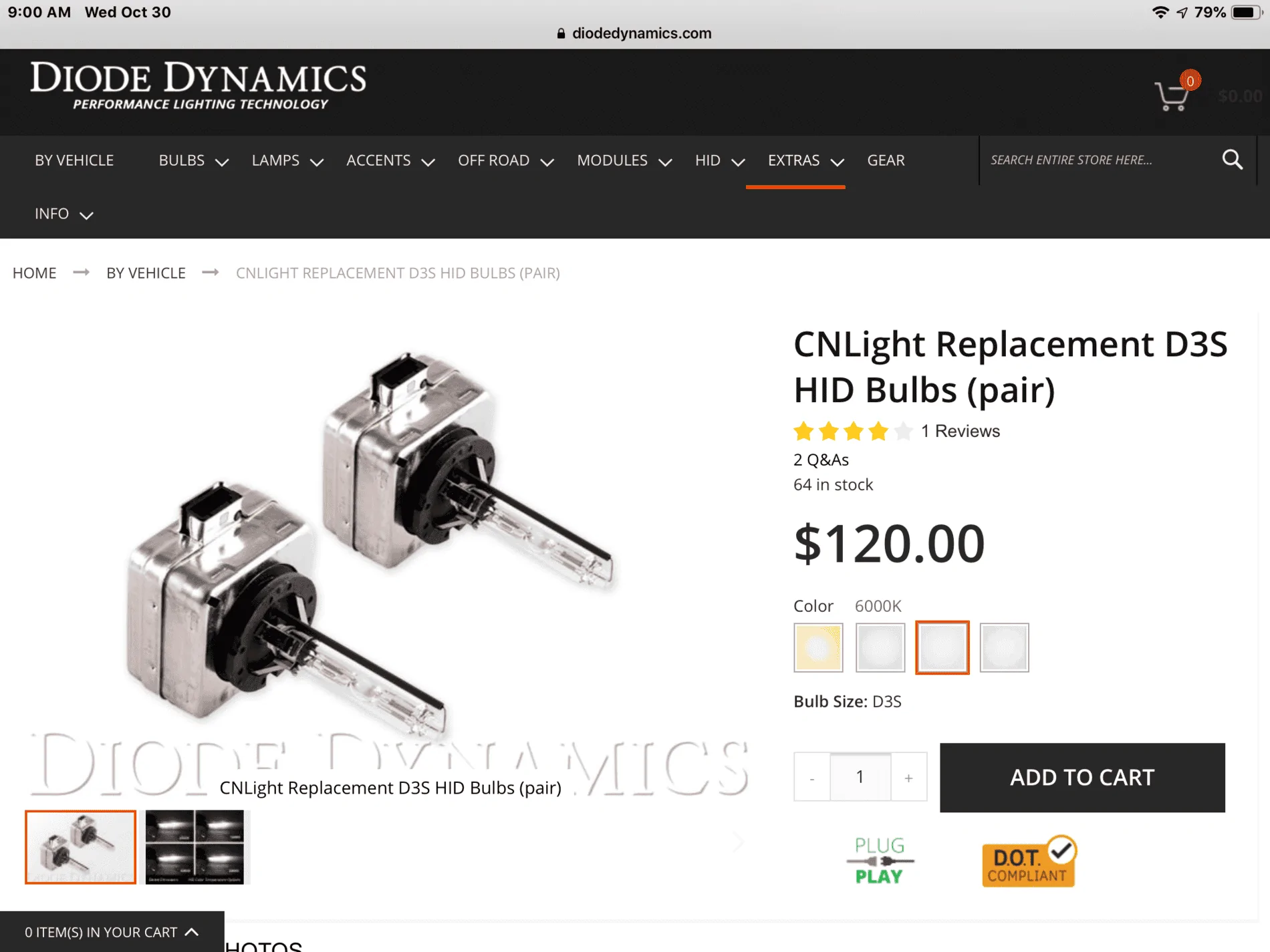

Wondering how these stack up to the Osram
PHILIPS Xenon X-TremeVision Gen2 +150% D3S HID Xenon Bulbs Set Of Two 42403XV2C1
I’ve installed them and they are a great bulb. In fact one of the best selling premium and close to the more pure white. They are a big step up from OEM. If you are looking for a more bright white you would be happy with those.
now why I don’t run them myself. Humans can’t see depth as well the higher towards the ultra violet spectrum, some like me are a little more sensitive. In HID applications I lose a lot of depth the closer to 6k I get. With LED it’s not as noticeable to me. But for what ever HID it is. A 5500 for me really drops off. So the 4200-4300k that the night breakers give out give me a little more punch. And a touch brighter. Most people it doesn’t effect though. If you are looking for the brightest bulb you can get and the best you can see with the NB’s are about it. But the XTV are extremely close and usually more popular due to the price point. I also swing on the Osram sack as their customer service has been great for me.
