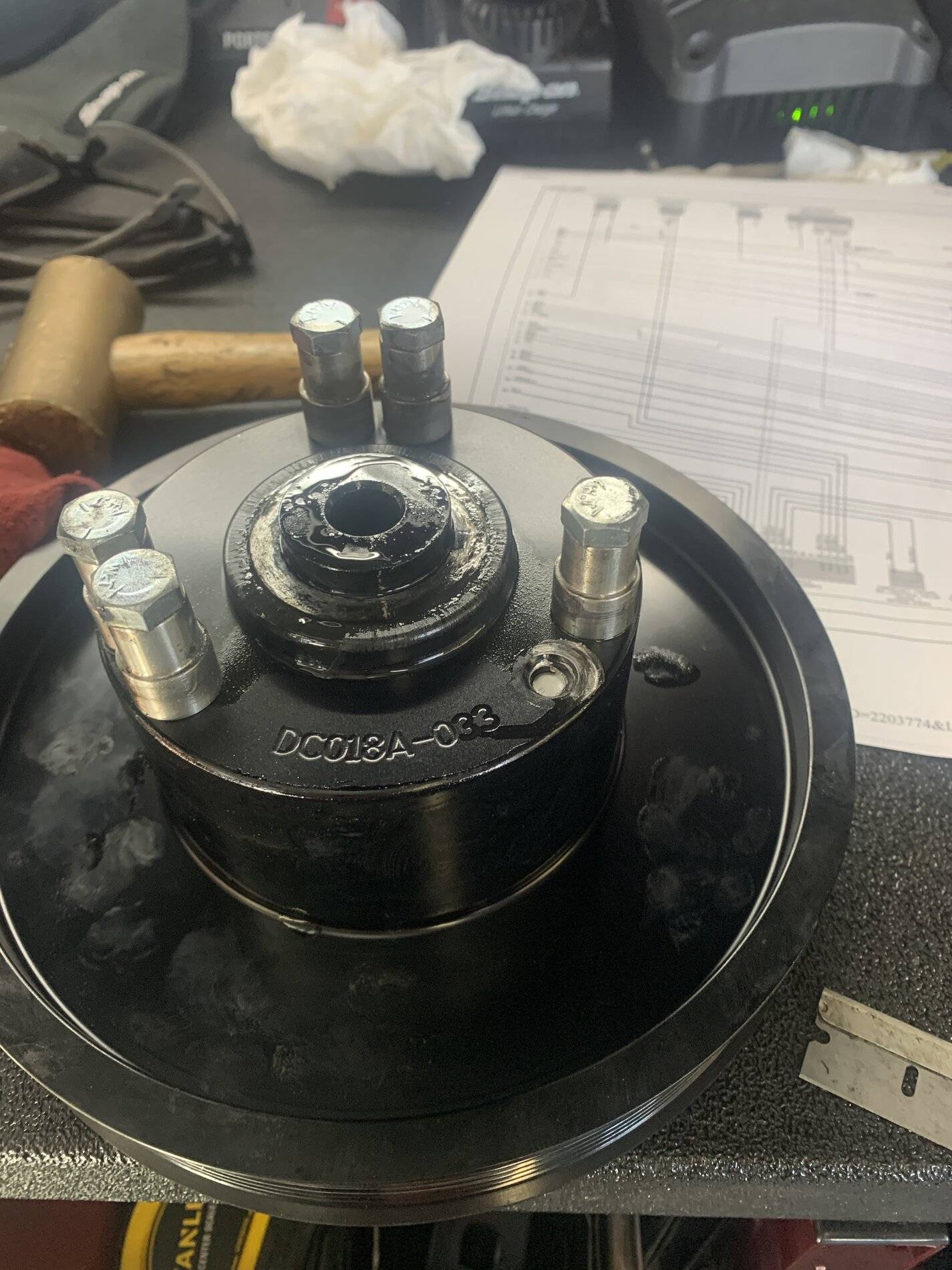

Pretty sure this is the problem

Interesting.. I think this should be an easy fix then? Just wonder what caused it.. Maybe back when the surging or tension issues were going on?

For those of us aspiring to learn more, what is that part? ;)

It was one of the cam locks on the procharger stage 2 pulley. It broke off and was stuck between the balancer and the timing cover causing the noise. I was able to get the portion of broken bolt out of the procharger pulley with a ez out and I replaced all of the bolts.

Just curious how you were still getting noise with the belts off

Because the broken bolt&cam lock were wedged between the balancer and the timing cover. With the blower crank pulley removed I was able to get it out with a magnet

Great detective work! :thumbsup:
