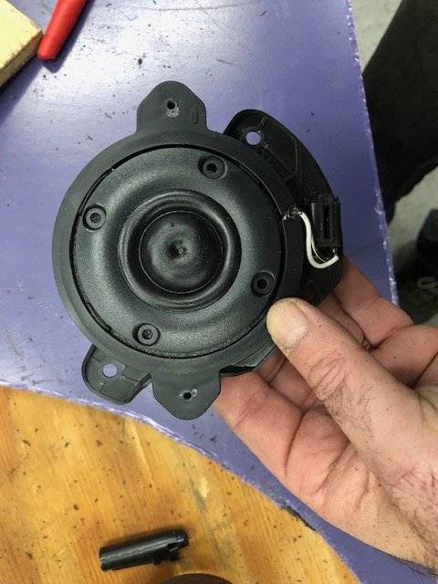

Good thanks. I had to correct a few DSP settings and set the amp sensitivities and now everything works and sounds good as far as imaging goes. I wanted that all looked after before I took the doors apart. I disconnected the factory tweeter and have one door panel off and have been fooling around with speaker mounting. It looks the Metra adaptor will put the woofer in perfect position. I just need to get some foam. I'm not sure why a custom adaptor would be required? I made a PVC adaptor ring to mount inside the factory 3 1/2" adaptor which looks like it will work for mounting the 3 inch tweeter. No pics yet. I need some foam for that speaker too. I've got a pile of sound deadening that needs to be applied so that is my next task.

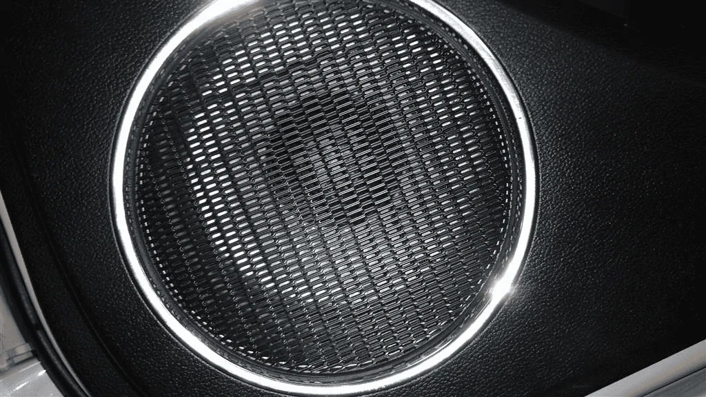

Glad to hear it. Be aware that even from the factory, the midbass does not line up with the grill on the door. You don't even think of this as a possibility (at least I didn't) so you get a nasty surprise when replacing the midbasses. Don't be surprised when you mount your new midbass and you look through the grill and it's not lined up. Check my build thread for more info.

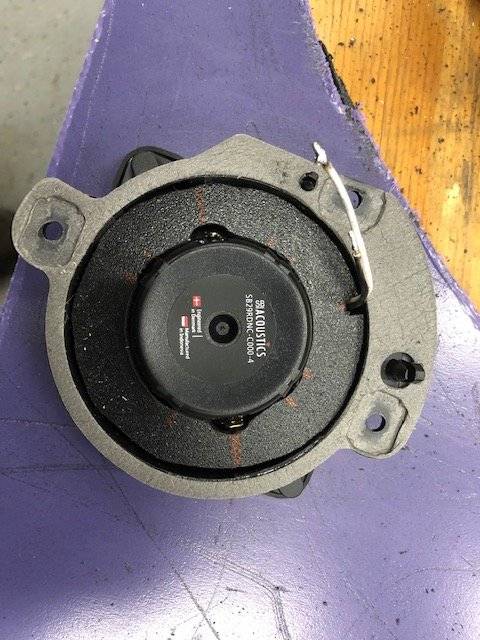

I have no extra height for a mounting plate for the 3 1/2 speakers which is why I made an adapter to go inside the factory mounting plate. Of course that only works if the speaker is smaller and has no flange like my SB Acoustics.

Slow progress but the passenger door is now sound deadened with Kolossus and the speakers are wired and trial mounted. The large tweeter is mounted on a PVC ring glued inside the factory bracket.

I haven't installed the 4 screws yet but they go through the flange to the PVC ring mounted inside the bracket.

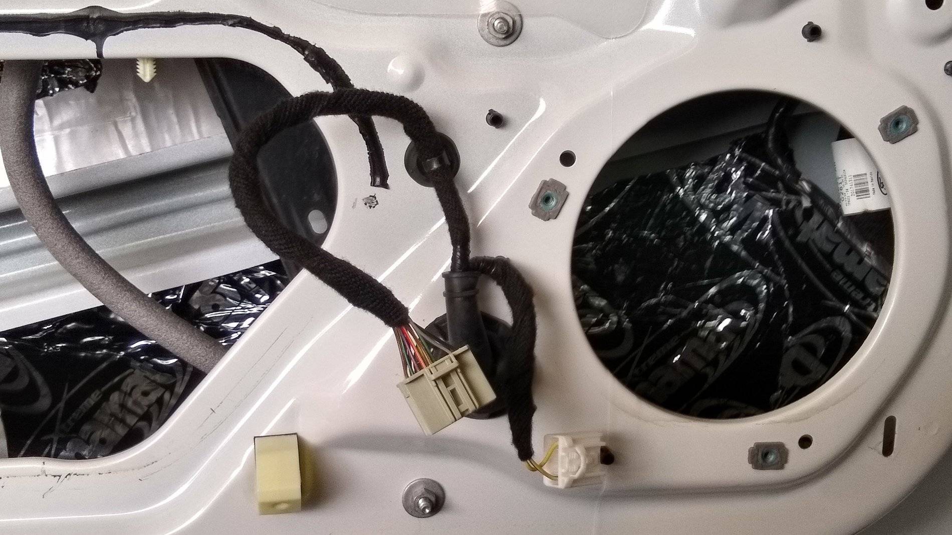

One thing I am not sure about is how much sound deadening to apply to the inner door. Do I just need to apply to points that might contact the door panel?

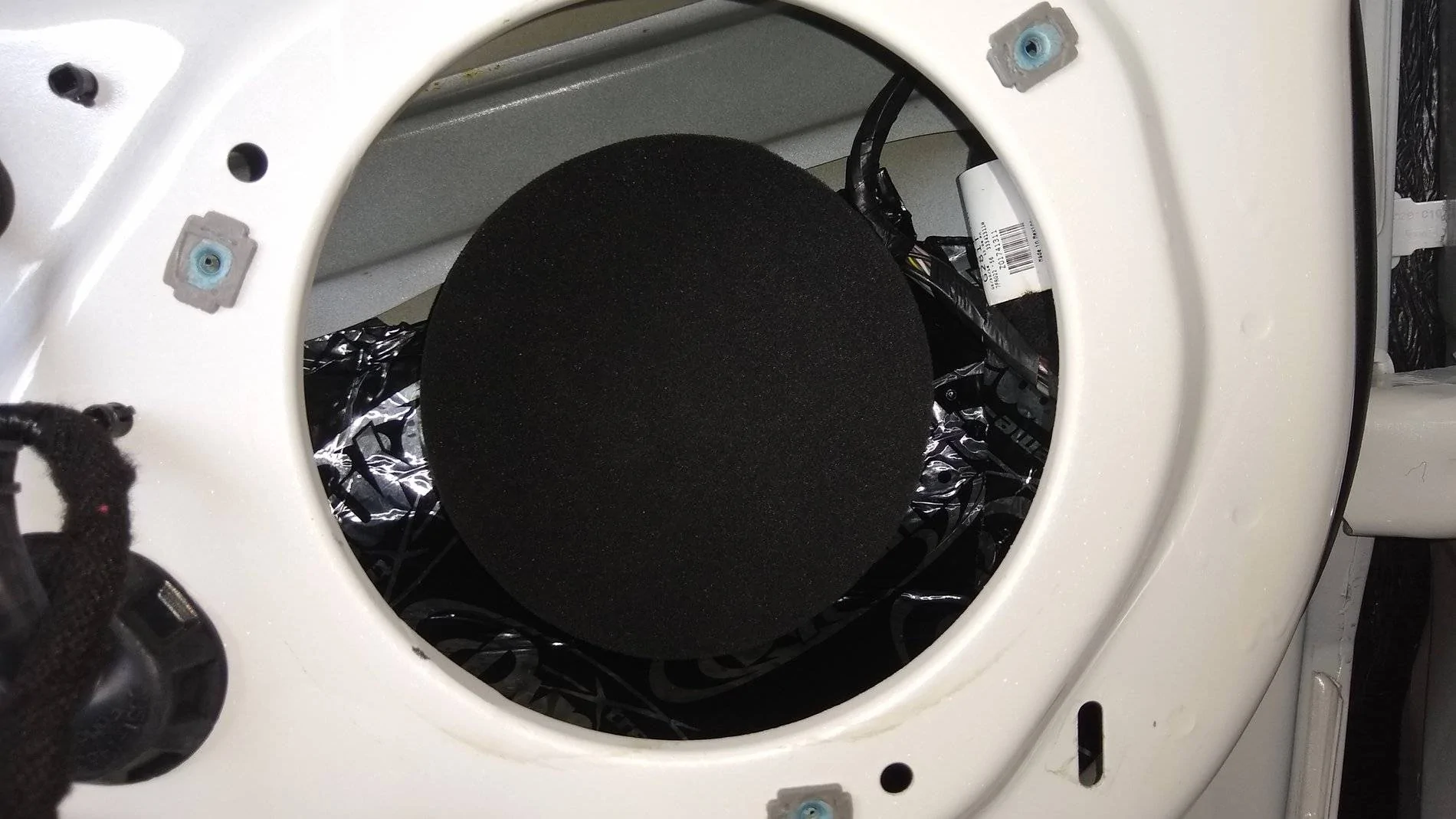

For the sound deadening it's really about how far do you want or NEED to take it. Some people will cover every single inch of sheetmetal and hole that isn't used to mount the door panel itself. That takes a lot of time and a lot of material. The doors have those huge L-shaped holes in them. There really isn't much to deaden, unless you want to cover up that hole. I had a bad experience in a previous vehicle where I went nuts on the inner door panel and then had a lot of trouble with the release rod that connected the door handle to the mechanism, as well as fitment of the door panel itself. I didn't put any deadening on the inner door panel. YMMV.

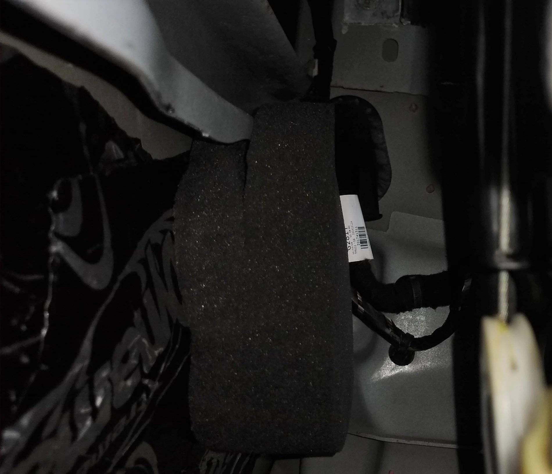

I did put a considerable amount of matting on the outer door panel. I put two layers of it on the lower part of the outer door skin. Basically, underneath the crashbar, from front to back. I also used the large foam "plug" from a Fast Rings set behind the midbass.
If you have the material and the desire, you could put small pieces in strategic spots on the back of the door panel itself. I noted there were some thinnish areas, but I didn't have a whole lot of matting.

I did the same inside the door except no foam. All I have done on the inner door is line the big plastic liner and put some smaller pieces in areas I thought might contact the door panel. I hope to install the panel and check for interference and then finish the other door tomorrow. I'm in isolation (again) so I have some time :)
