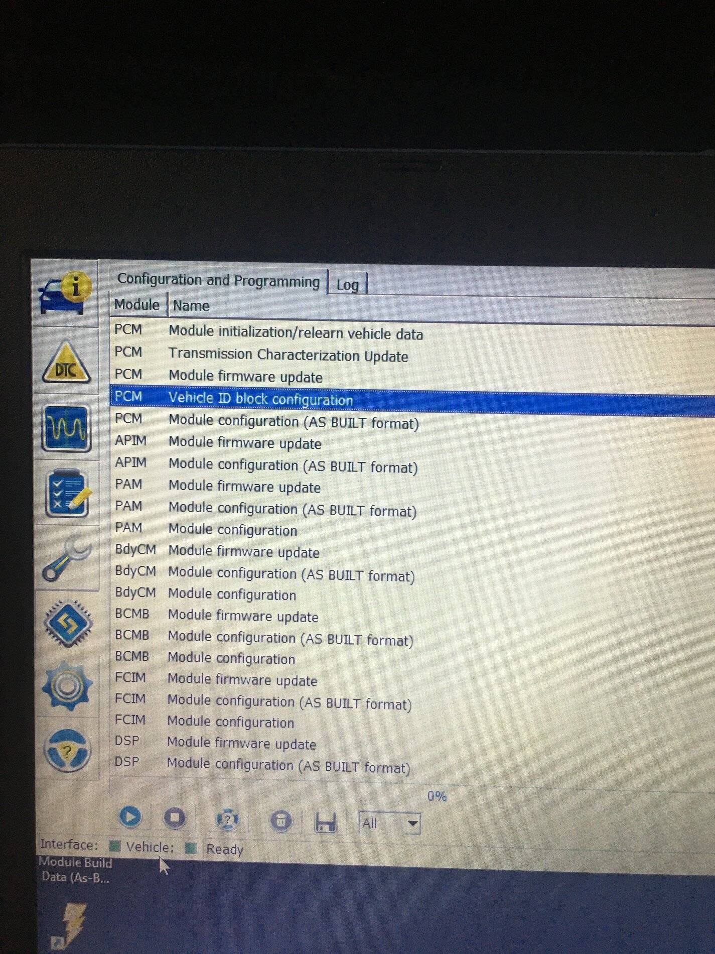

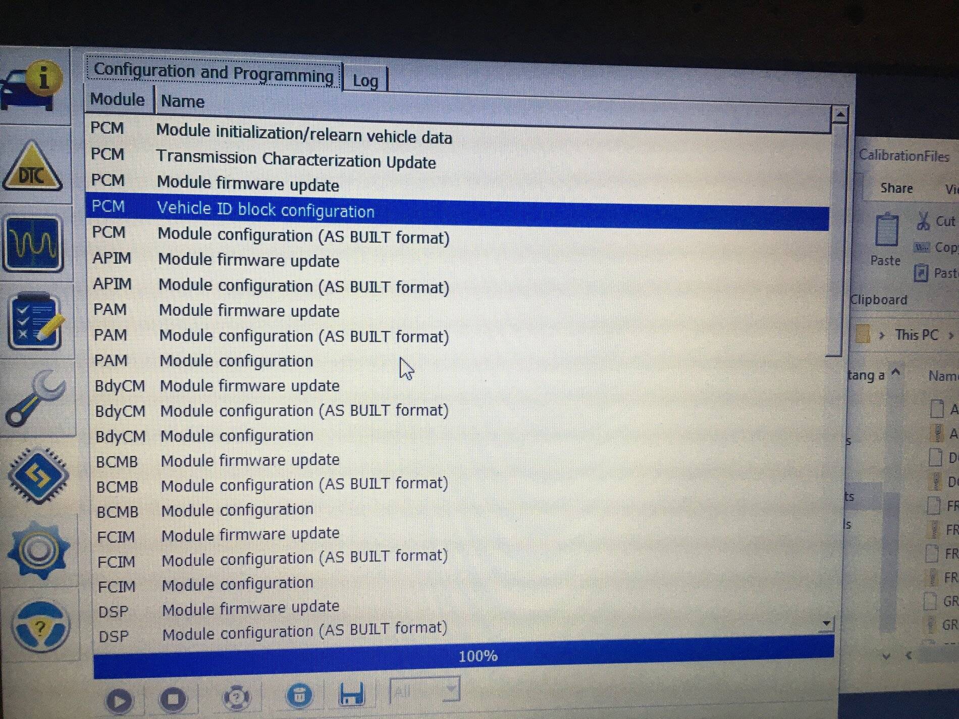

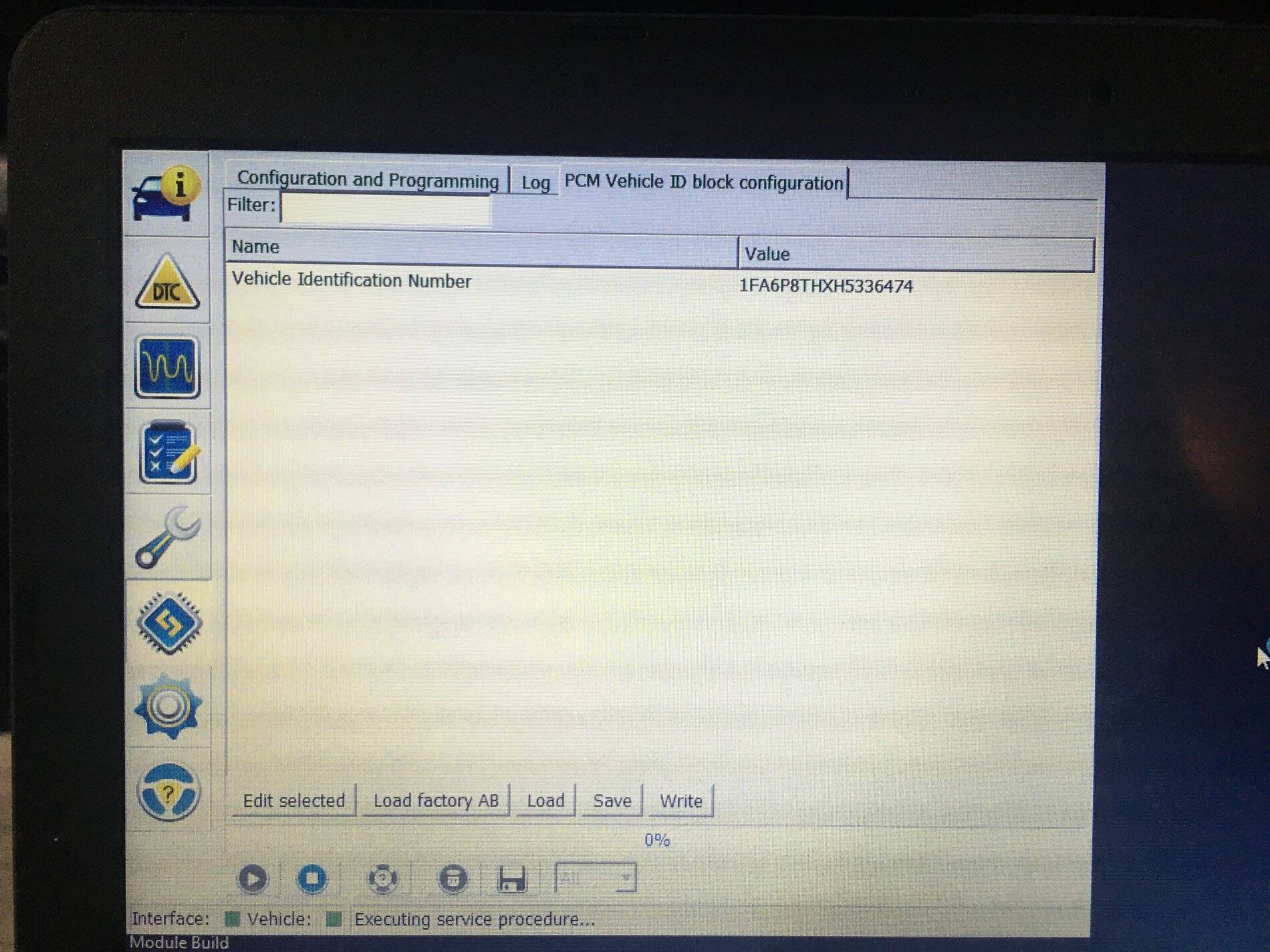

Here.

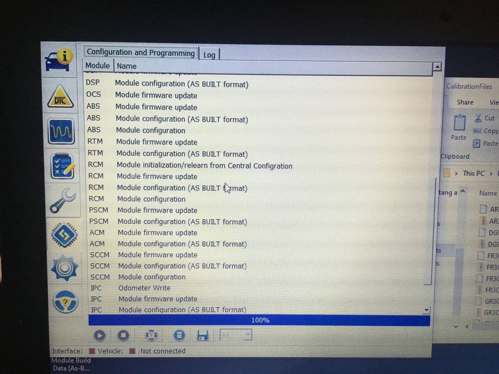

Fully changeable. I clicked- now to be fair, I have an developer forscan version, I can share the link. its pulled off their site due to people not knowing how to use it and messing things up.
I can change all firmwares/updates/modules etc. not sure if regular forscan is able. ive already changed my VIN in a couple modules, thats why I knew it was possible, swore I saw it. here it is.
you just click on it, and click edit. and change it, and hit program. I updated a lot of modules etc this week and changed some vin's around. (I flashed GT firmware onto my mustang EcoBoost) so had to go and re write several modules vins so it would match my EcoBoost.

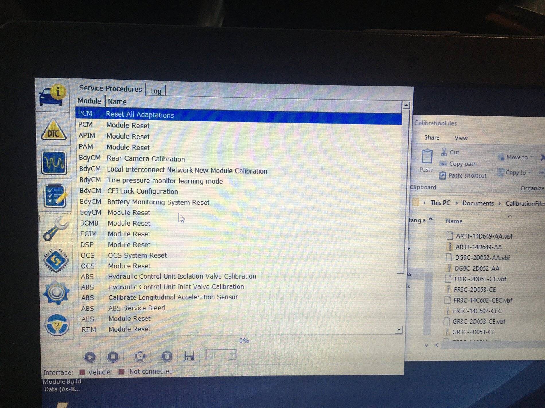

Donald
17 mustang

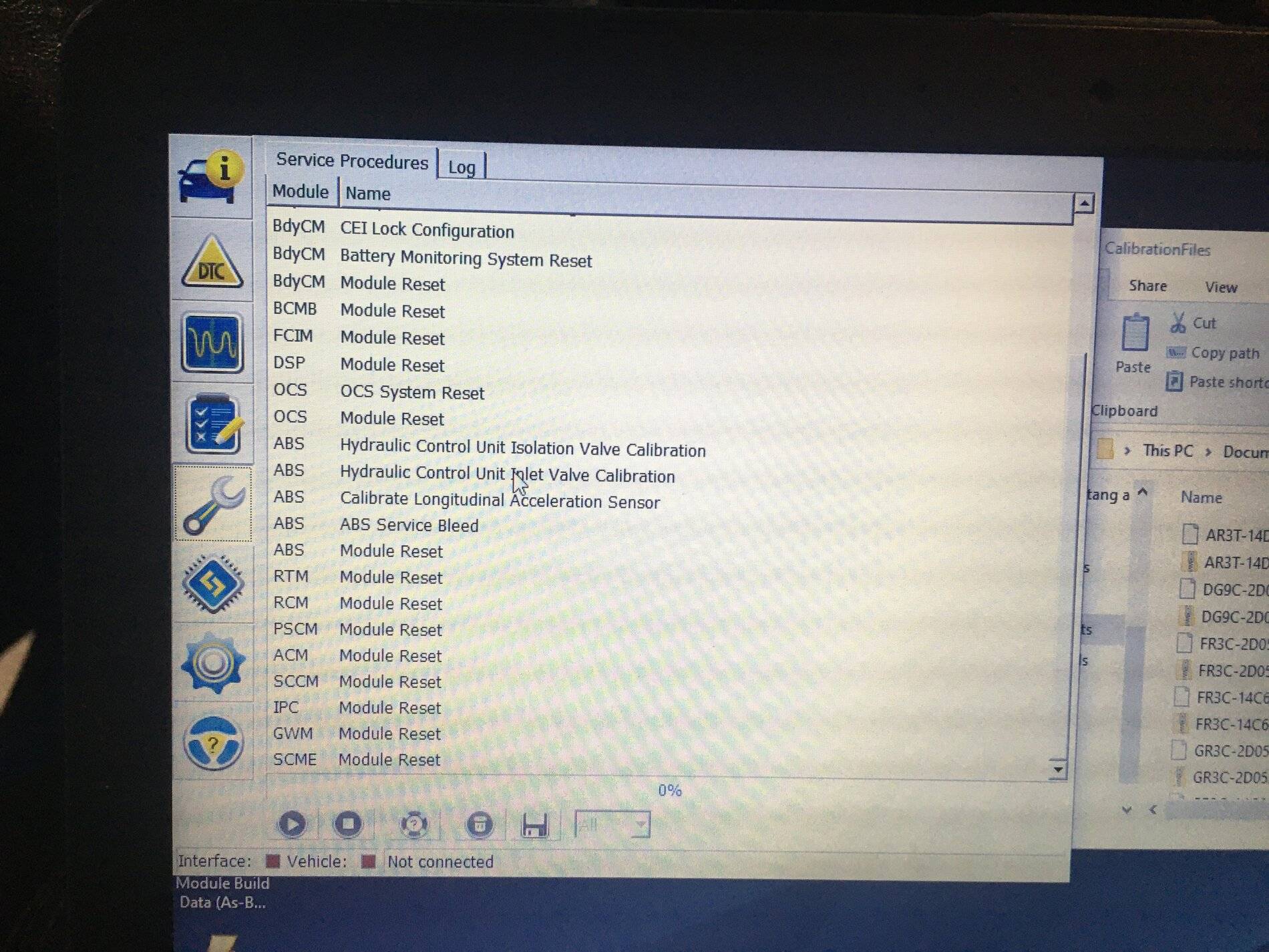

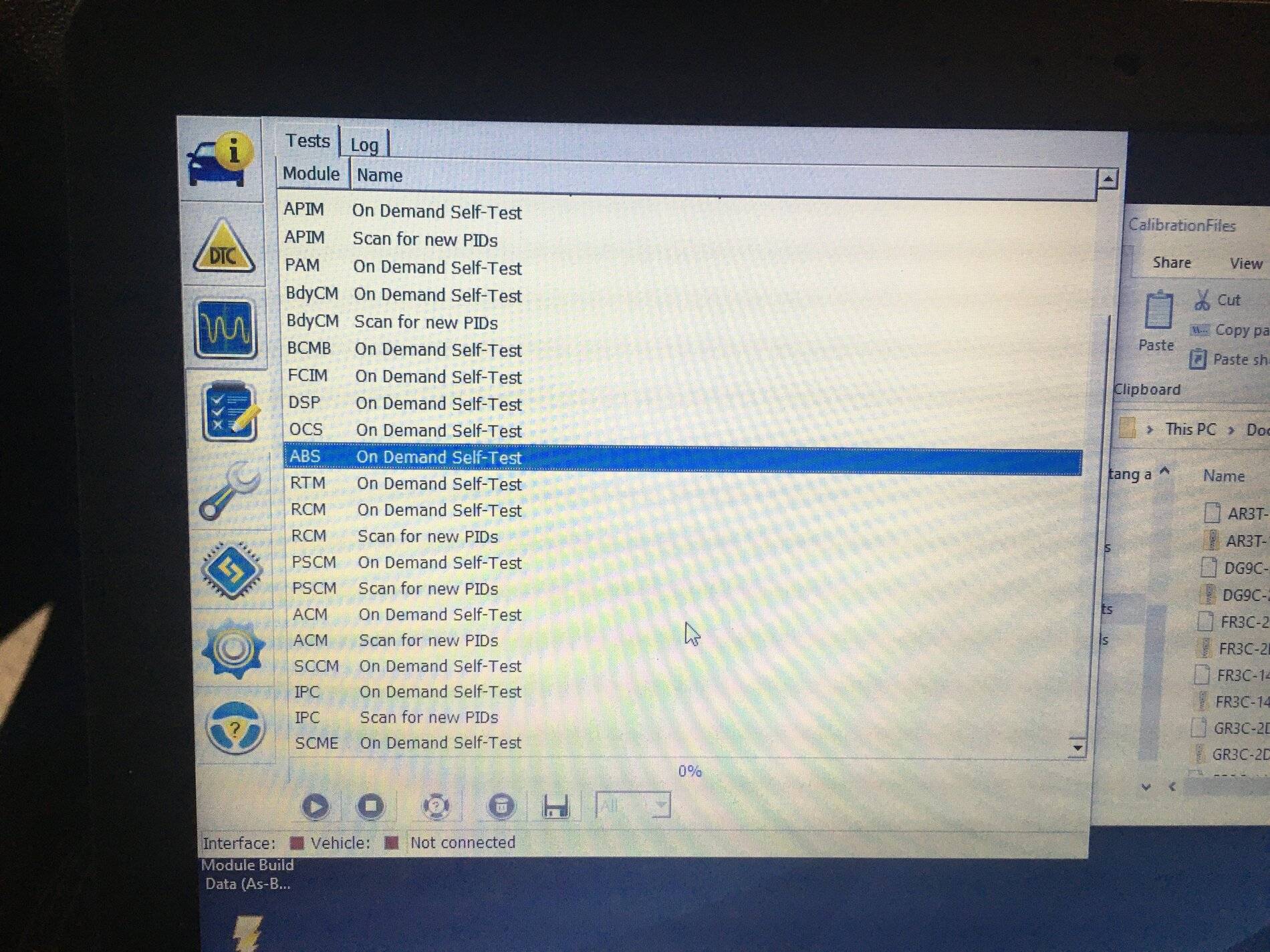

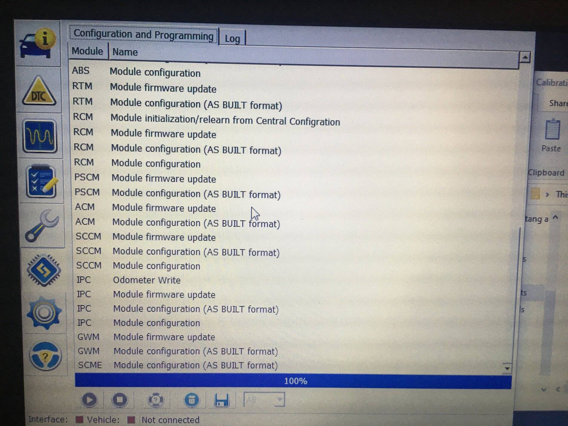

Took a few photos of soemthings new version can change. Last photo is for dtc removals. I have a perm code since tossed a acm and dsp from 12 speaker car in my car. One of the options doesn’t match, it has a feature my car doesn’t
I believe navigation
Message me for this forscan link, I will share. But I only recommend using it if you have the cord I posted. But if you are a newbie I would rather you not try any of this.

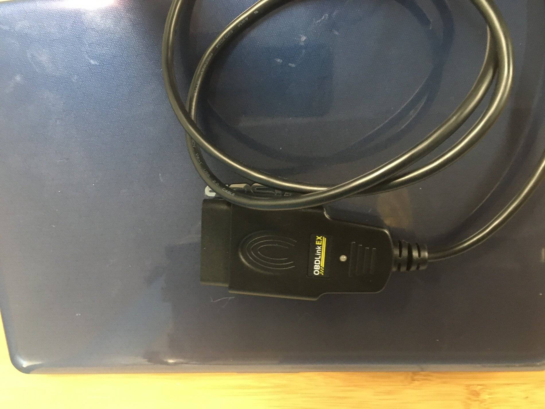

Vcmii transfers 900-1000kbps
The cord I have transfers 700-900kbps
All elm327 China clones are like 20kbps and can corrupt/drop packets.

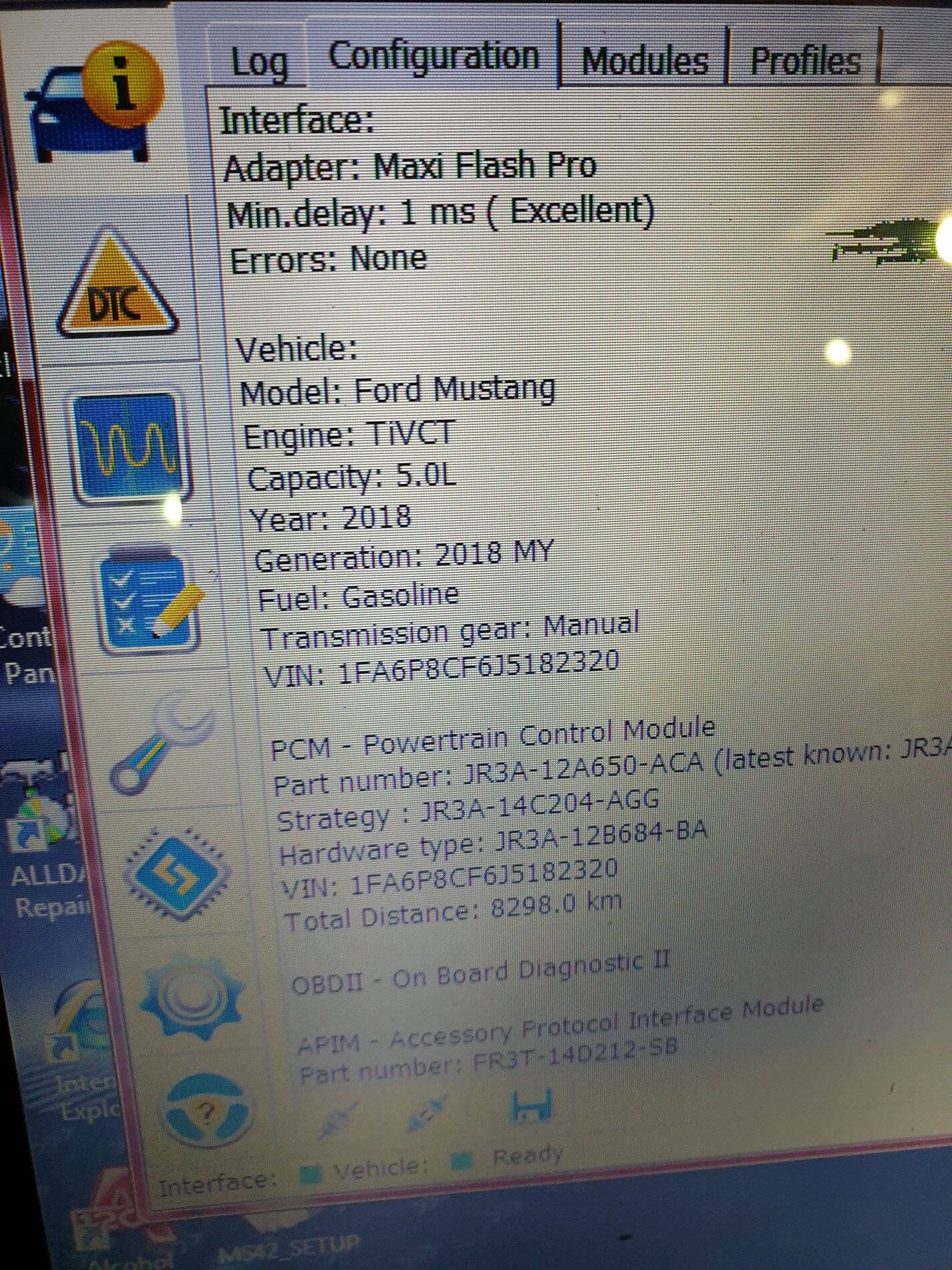

Some of the vins for other modules are located in the configuration file area(not as built file section). It appears pcm has its own block for vin. Odd to me but yeah

Forscan is free. You just need 50 dollar cord off amazon and laptop, (windows)
since people have been messaging here you go.
But if people don’t understand things and break them it’s on them. Follow the prompts and make sure car has a charger for large things. Use proper cord
I have a purchased license but you can get a free license on forscan forum

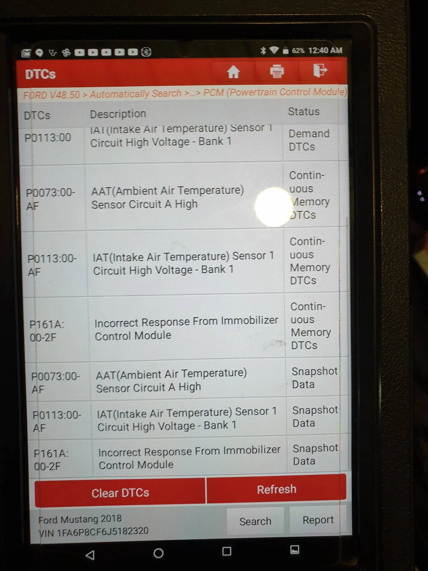

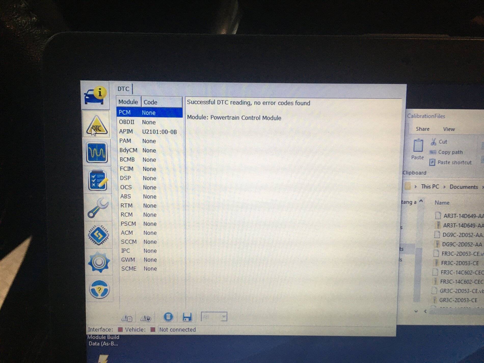

Delete the dtc’s and reset car
the pcm on both car and pcm match. What else are youattempting?
maybe the immobilized needs repaired to the system via keys. You need both keys to reprogram using forescan. Atleast that’s what I’ve read. I havnt programmed keys yet
