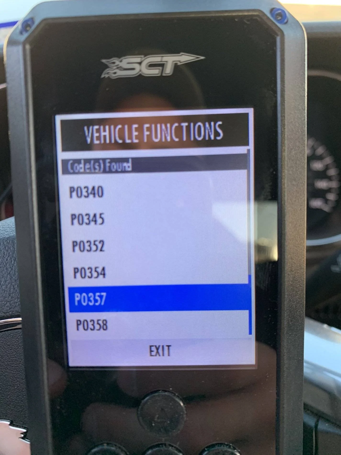

Here are the codes. And still there after new pcm

I hope you get it fixed. The codes didn't show up.

They showed you a damaged wire? You have codes for cam sensors and the ignition coils in there, so it sounds like more than one wire in the harness was damaged. If that is the case, then I would carefully unwrap the harness in that area and check/repair everything. Of course, if the shop messed with the secondary chains, and they don't know what they are doing, they could cause all kinds of havoc...
That is excellent advice. From what I understand a BUS style control system can use a few wires for multiple sensors. Not one wire per sensor anymore. One bad wire could create multiple codes on that loop.
You can break a wire and not break the insulation. You can break a wire and still have contact until it’s under load(it’s terrible). If they can’t figure it out then you will need to find a service manual and start pinning out the ECU to find what wire is bad. I would guess a good mechanic could narrow it down pretty quick.
Also check to make sure a ground is not loose somewhere. I don’t have a wiring schematic so I don’t know if that loop is grounded separately or not.
